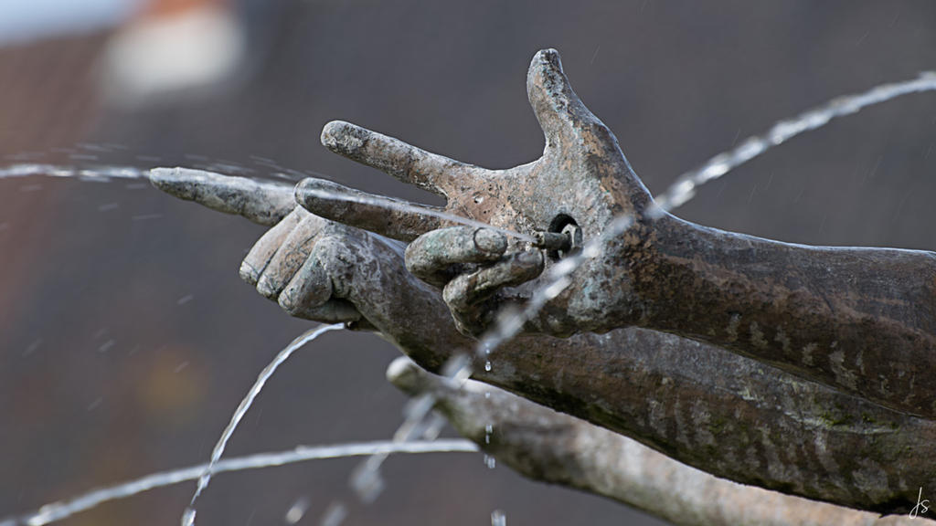

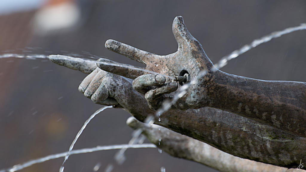

This is something i have not liked but it looks to be more popular now so decided to revisit it,the question i have is have i overcooked these two.
Any thoughts welcome

I'd have taken the layer opacity some % down but that's taste. I'm always using the high-pass hattrick these days but the problem is usually not the sharpening itself but the oversharpening.
It's very easy to use too much. What I do is bring the opacity down while switching the layer on and off until I have a hard time seeing the actual difference. Then I up the % a couple. I do that for all three layers.
What you also have to pay attention to is to erase undesired auras. Especially the outlines in high contrast areas can suffer those artifacts (the tail of the second as an example displays a fine "glow"). I simply use the eraser and remove those parts in the high pass layers before merging all.

The using too much is what bothered me,i think its like eating curry you start with a mild one but can quiet easily start craving stronger tastes,will start playing with the eraser

Indeed, it can be like saturation. You tend to use it some more and some more until at some point your eyes start to bleed. That's why I always go down until it is almost invisible and then up the opacity not more than 5%.

I tested it myself to see if what I do is wasted effort or not.
The first is the image as is, no sharpening.
The second one High Pass vivid 40% opacity.
The third 3 different High Pass, 40-20-40%.
The fourth the third extra sharpened in LR.
J-see
It's about taste. I prefer the third because it is not as in your face. There's much more nuance in the overlays.
You notice the differences best when you save them to your comp and then cycle back and forth in some viewer. That directly shows what areas are different.
