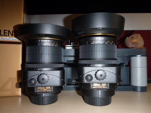

I tried the 24mm a while back and was very impressed... so much so that just this morning I ordered both the 24mm and the 45mm from a dealer in Sydney... now comes the wait for the package to arrive....
and as I had ordered both the PC lenses the dealer gave me a very good deal on a SB 910 flash... so that's enough NAS for one day.... I'm starting to sound like my good buddy Bill16.. heh heh
