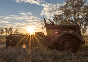

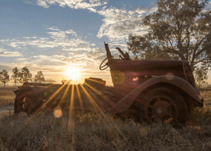

egosbar
this is the image , i wanted to reduce these spots , also any technique to remove them in photoshop would be helpful
Eyelight
Not bad at all as is. I'm not sure what you would want to reduce.
Small spots can be touched up using the spot healing brush or clone stamp in PS.
