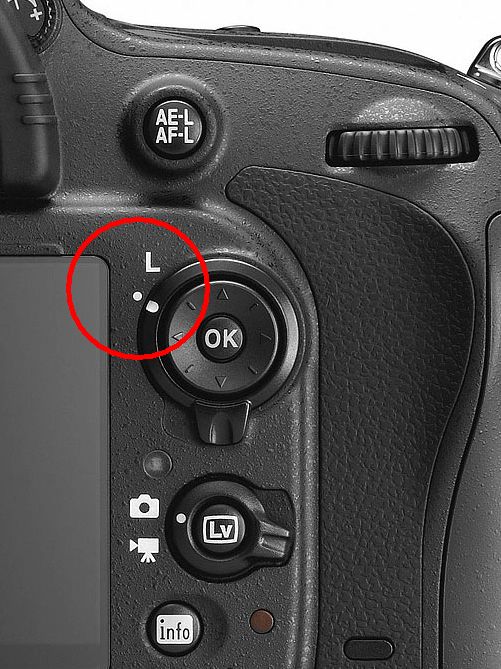

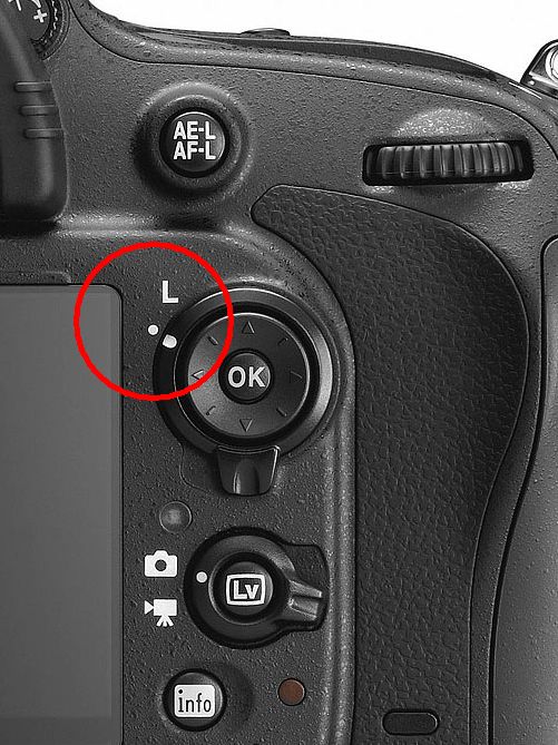

Did you accidentally flip the little switch around the OK button to the "L" position?
yawning_cat
Nope its on the setting with the dot.
