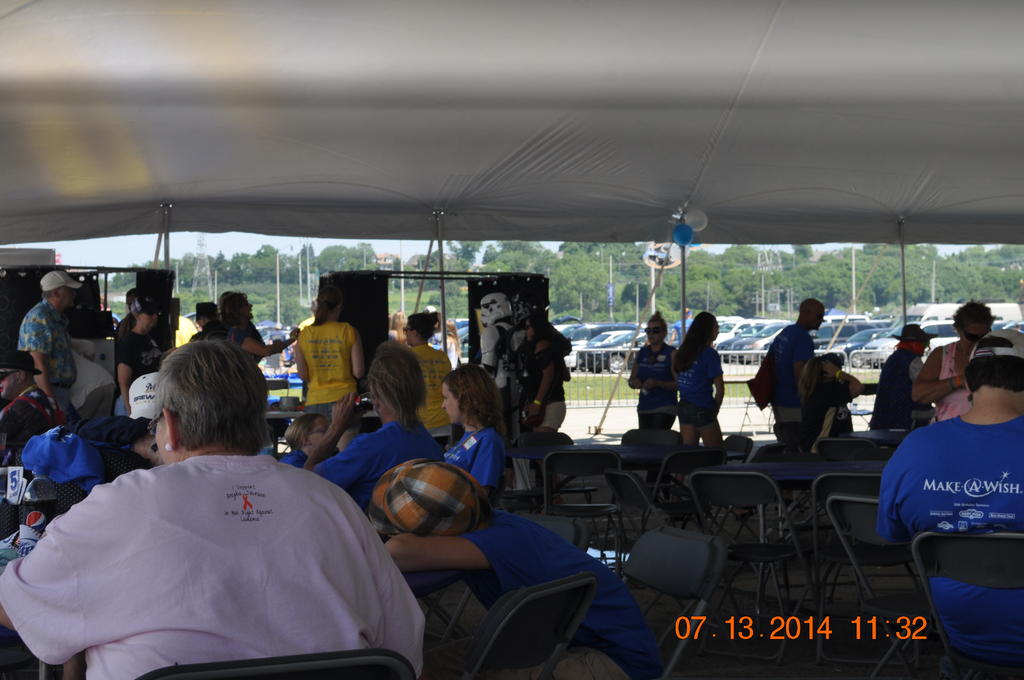

Good evening everyone,

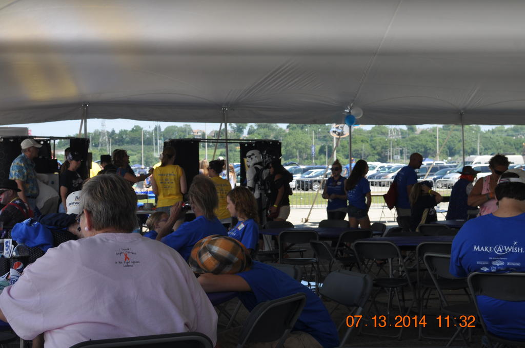

I'm having a problem with my D5000. On the top (or if you rotate the camera to the left the left site) every image I take has a faded out white line going across. I've tried cleaning the lenses, using different lenses and cleaning the image sensors inside the camera. However the faded line is still there. As you can see in the image here the faded white line is shown on the large party tent. The fading is on every image and I'm not sure on how to fix this. Is the image sensor bad or is there something else I can do? I am a hobbyist/novice at this so if there is any information I'm missing please let me know.
Thank you.

not a good example. maybe you can shoot a solid wall. preferably white so we can see the exposure inconsistency.
aroy
It is very difficult to figure out what line you are referring to. As suggested do any or all
. Take a shot of dark wall
. Take a shot of blank sky
. Take a shot of a dark sheet
Then when you post the "faded white line" may be easily discernible.

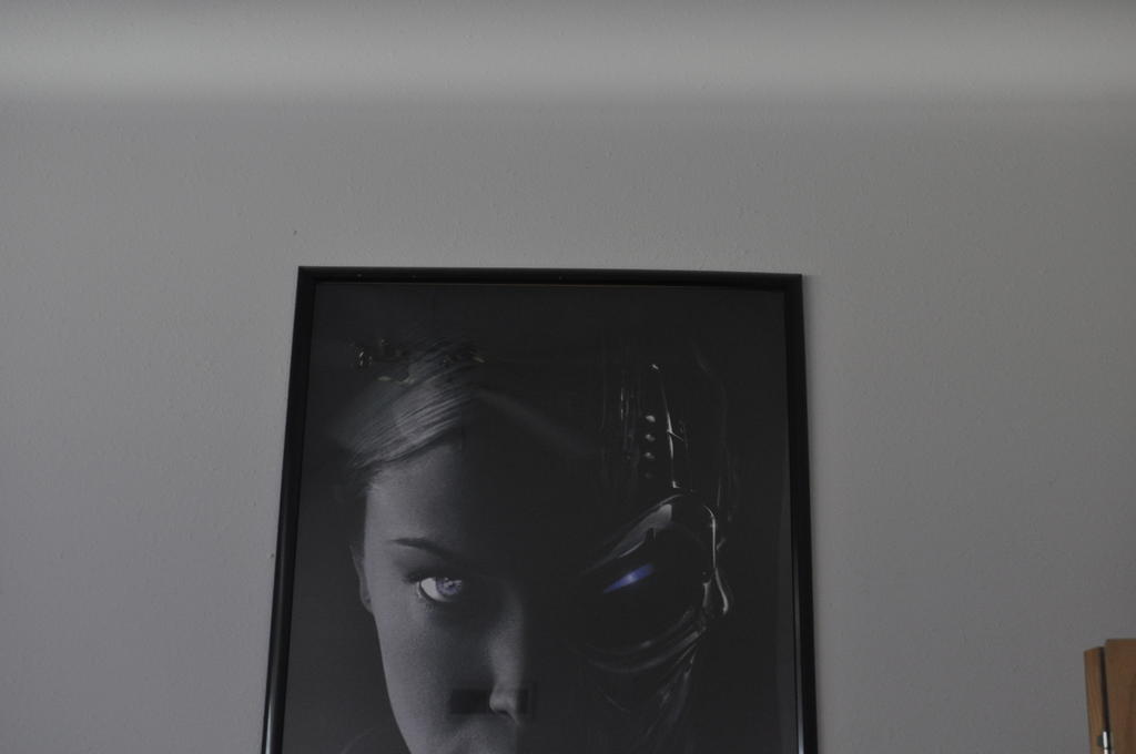

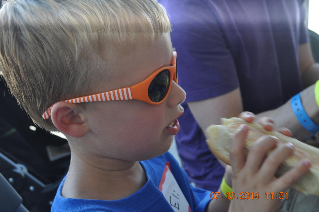

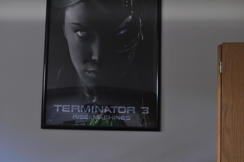

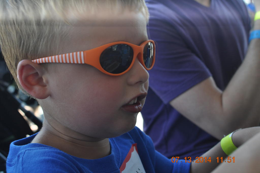

Here are a few pictures that should hopefully better show what i'm trying to describe. The first new are of my nephew and you can see the faded line up top. That was taken with my 55-200mm lense. The 2nd two are taken with my 35mm lense.
However i did notice if I get REALLY up close to any light or dark colors that faded line went away.
Also someone mentioned ghosting earlier. I also have some pictures from sunday that showed a "ghost" or light 2nd image of people that were the main focus of the picture (but they were moving).

I think you should find a Nikon repair center and send them pictures. They could probably know the cause just by seing the pictures. This forum is just a "user" forum so as far as I know, none of us are Nikon repair persons.
I'd suspect something with the shutter, so get an estimate and then decide if you want to have it repaired of buy a new one, depending on the difference of $.
Good luck.
Eyelight
Looks like the shutter is dragging. If it is, then a flash exposure using a slow shutter speed would likely look okay and faster shutter speeds would look worse, maybe????
As Marcel suggest, contacting a repair shop is probably in the near future.
STM
It could be the shutter. If the second shutter curtain is sticking a little near the end of its travel it could expose that area a little bit more. Does the area change with shutter speed? I had this happen on one of my F2's a couple of years ago. Fortunately the shutter just needed some cleaning and adjustment, not a replacement shutter.
It will probably have to go to the camera doc.
Felisek
Go to Nikon web site for your country, select "Service & Support" and then "email us". Describe your problem and upload pictures illustrating it. They prefer to have original files straight from the camera: either NEF or JPG. Someone from Nikon will contact you soon. They can be very helpful, they will also tell you where to send your camera for repairs, if necessary.
