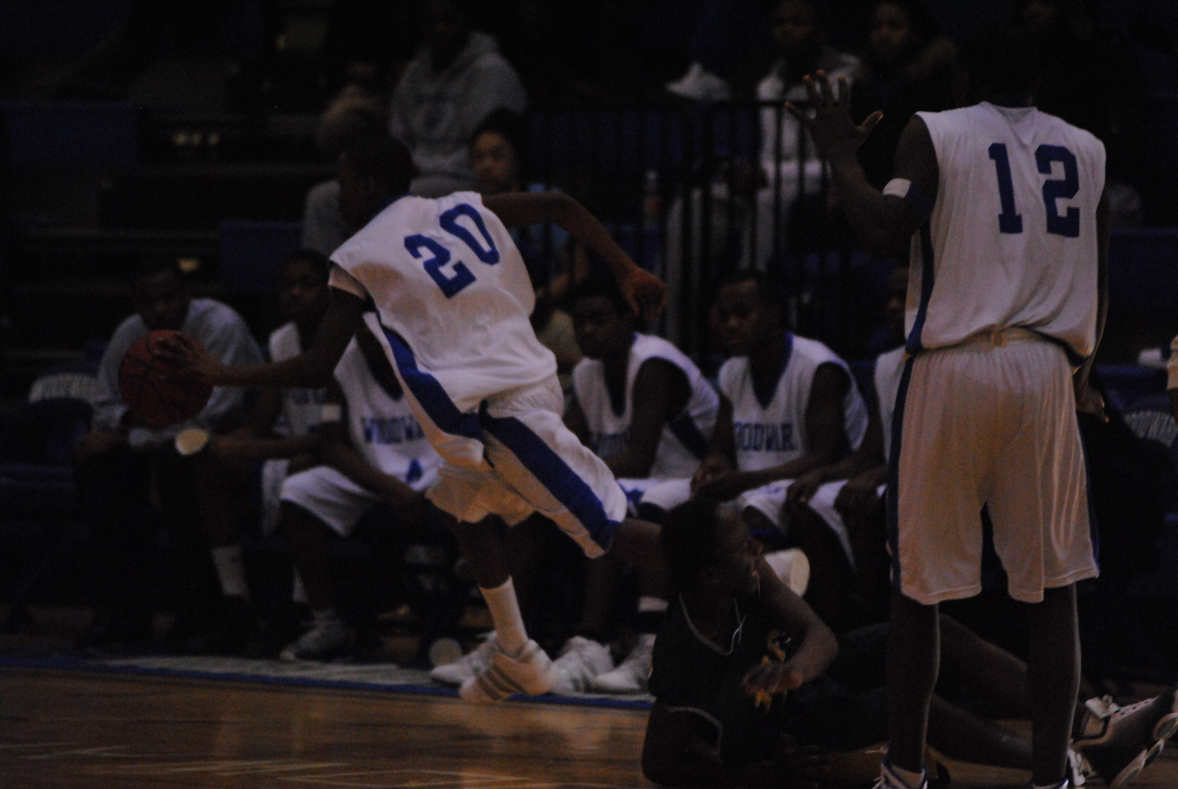

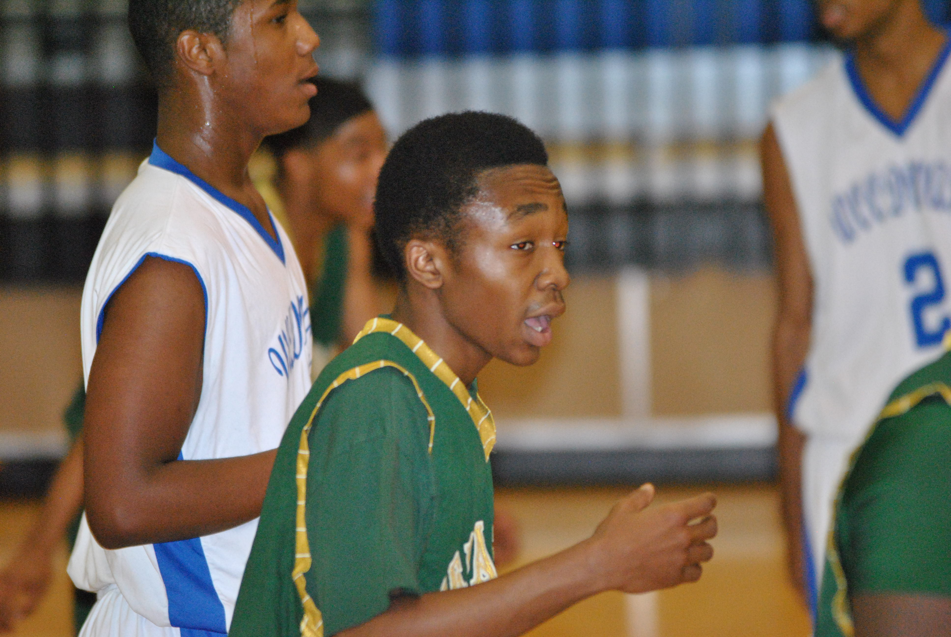

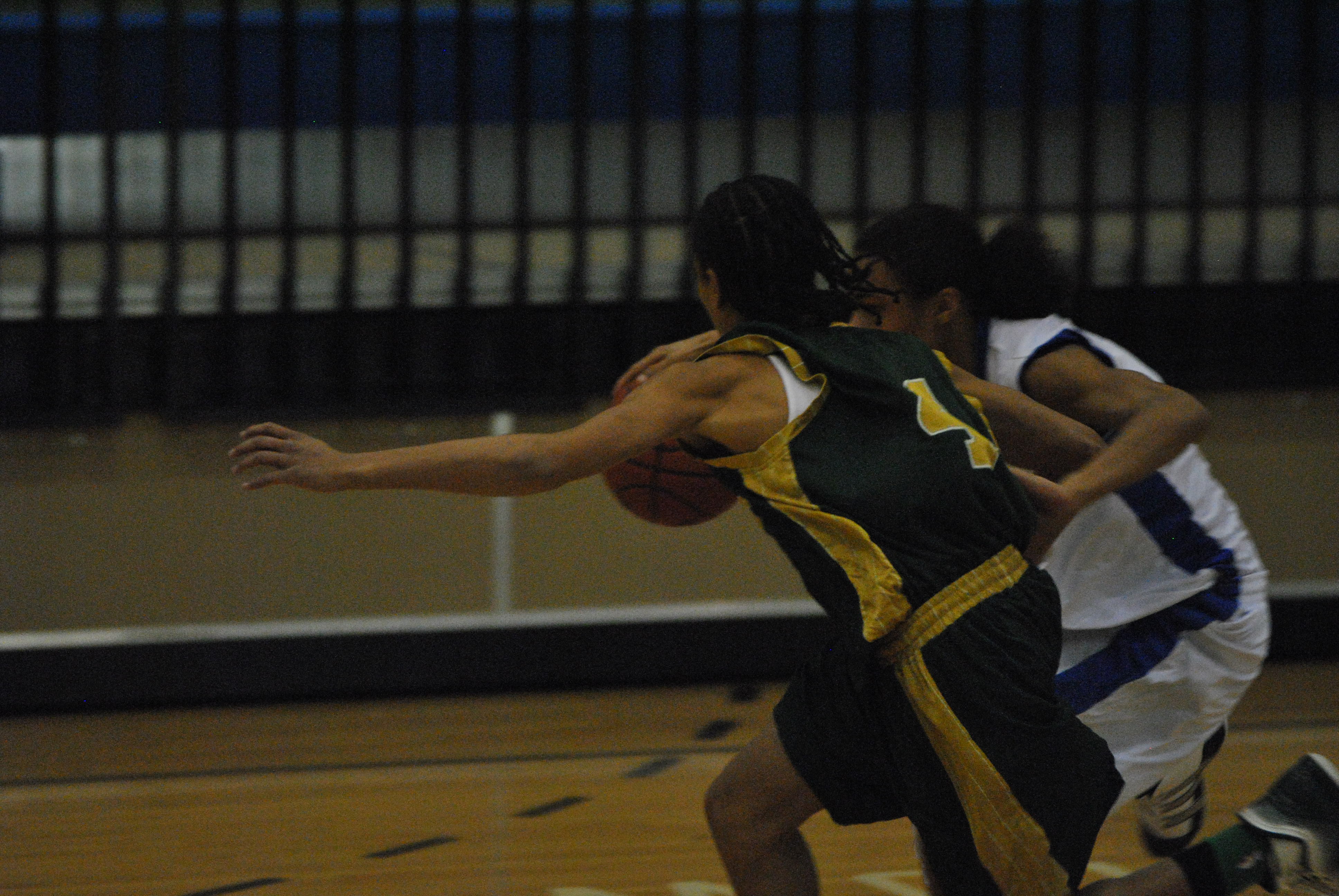

These were taken at 6pm. Lens 70-200mm
image 124(2 players): f2.8, 1;320, Iso 1600, Exp bias 0, focal length 200mm Max Ap 3, Metering Pattern, Flash: none, Shutter Priority
image 053 Players 20 & 12: f2.8, 1/400, Iso 1600, Exp bias 0, focal length 190mm Max Ap 3 Metering pattern, Flash: none, Shutter Priority
Image 165 Green Jersey: f2.8, Exp time 1/200, Iso 1600, Exp bias 0 focal length 190mm, Max Ap 3, Metering: Pattern, Flash , Shutter Priority
1rsey
Any suggestions would be helpful.
Thanks
fotojack
Well.....personally....I would have shot these in Aperture mode. The ISO looks correct to me, though. I guess a flash with a difuser was out of the question, right? Your glass was certainly fast enough, although to be brutally honest, a 1.8 or 1.4 lens would have been ideal.
kokomo
Thanks. I just got the lens last week. I also have a Nikon SB-600 that I just got. I don't know much about the flash & am trying to read the manuel which I think is complicated. When I use the flash, are there certain setting I should have it on. I tried it once & I guess I had it set wrong since all the photos came out blurry.
I'll try Aperature mode the next time.
Thanks again.
fotojack
Blurry photos are not caused by the flash. They are caused by camera shake. When shooting action shots, always use at least 1/500th of a second shutter speed. Your Aperture Mode should be able to tell your camera the correct shutter speed for the shot. For instance, in my camera, even when I use Aperture Mode, which is 95% of the time, the correct shutter speed is chosen by the camera, depending on the glass I'm using. I can also select a different shutter speed manually when in Aperture Mode, so I'm not sure if you can do the same in your camera. You'll have to experiment with that one. Probably someone with more experience with the D3k will be able to clarify that.
As for yo9ur SB-600 flash.....nothing wrong with that puppy! It's pretty easy, really. Just slide it onto your camera and shoot. In P, A and S Modes, the camera will do the thinking for the flash, so not to worry. :) In Manual Mode on your camera, the flash will have to be set up according to the lens you're using with it.
