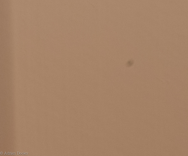

So have my D7100 around 5 weeks or so and am loving in. However I have a spot that has appeared towards the top right of the frame. easily visible on blue skies etc, I`ve been cloning it out for the time being.
Got one of those Giottos Rocket Blowers and have given the sensor a few good blasts of it but its not shifting at all. Now I have no experience with these problems and I`m not sure if anyone here can tell from a cropped photo whether its dust or oil. Its certainly not shifting with the blower. Anyway heres the image:
DSC_1266 by adox66, on Flickr
Anyone hazard a guess?

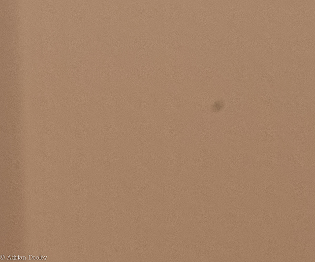

Apologies guys. Hopefully this is visible.

Hi Adox, I can't tell what it is from the photo, but if it is something on your sensor, my first call would be the blower, which you have already tried.
If its oil or something stuck on good, you will probably need to have the sensor wet cleaned.
Not sure what your options are to have it professionally cleaned in your area, check out your local camera shop.

if it is not shifting with the blower at all, then I would imagine it is some oil or other contamination adhered to the sensor surface, from the shutter mechanism for example. As the camera is only 5 weeks old it may be that you can get it cleaned under warranty, take it in to where you bought it and ask, if they try to charge you for he service make a scene and play your "only 5 weeks old for heavens sake" card. If you can make another shot of the sky at the HIGHEST F-number, so the smallest aprture, then the contamination will be easier to define.
I totally support you learning to clean the sensor yourself. It really is not that hard, and if the D7100 is like my D7000, you are not cleaning the sensor directly, but rather the low-pass filter, which is a glass filter covering the sensor. Many make a big deal about cleaning the sensor but it is not that hard. Another thought, the D7100 should have a clean function in the menu, try that and see if the contamination shifts. For info on how to do this on your camera, read the manual. Any further questions please post. For cleaning the sensor I use the Sensorwand, with PECPADS and eclipse fluid.
I think this is a bit of a stretch to go straight to this assumption, particularly without knowing how often and under what conditions the lens may have been swapped. The UK has been rather damp of late, so any dust creeping in is likely to stick. I'd say that easily 50% of the dust I see on my sensor never budges with a blower once it's on there, so if this is the only spot I would call it normal and not point to a shutter disintegration.
All that said, take it to your dealer and they may offer to clean it, but don't be surprised if they want to charge you. Cleaning the sensor stack, as Martin said, is not difficult and should be considered a necessary skill to develop for any photographer.
And for the record, oil spots will always develop in clumps in the corners and will be round and translucent. So when you see spots scattered throughout the frame or along the long edges, it's dust and dirt.

agreed, thanks for this Jake. Would be interested to learn however, why oil has the tendency to deposit itself only at the corners
Because the corners are where the shutter mechanism pivots, so it is where oil will leak from. It's possible to get it elsewhere, particularly when the camera is oriented strangely, but even if it's all over the sensor there will be concentrations at the corners.

So just back from where I bought the camera. Left it in with them for an hour and they wet cleaned it a few but the spot didnt shift.
She said the sensor was very dusty, abnormally so and also the shutter mechanism needed looking at as there seemed to be small bits of debris coming out of it.
They are sending the camera back to Nikon for repair so I`m going to be without it for approx 10 days which is a pain. Just looked at the copy of the docket she gave me and she has recommended a sensor replacement and that the dust issue needs looking at.
She also told me that if she wet cleaned it enough she may eventually have gotten it clean but it would be back to the way it was within weeks.

I had exactly the same problem...my test photos looked identical, except in a different position. So mirror up, camera pointing at the ground and a good fierce blow. Cleared first time!
