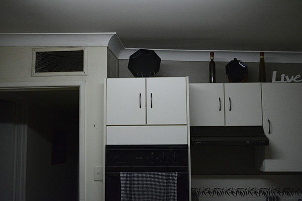

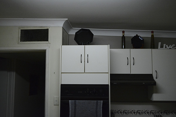

i was setting up the backfocus too the ae af lock button , i tested it out in the kitchen under flouro light with auto wb on , i fired off these single shots , on playback there are different areas with yellow tinge and some of the shots have nil
all these shots were taken one after another with no light change
can anyone help here please
here are the samples

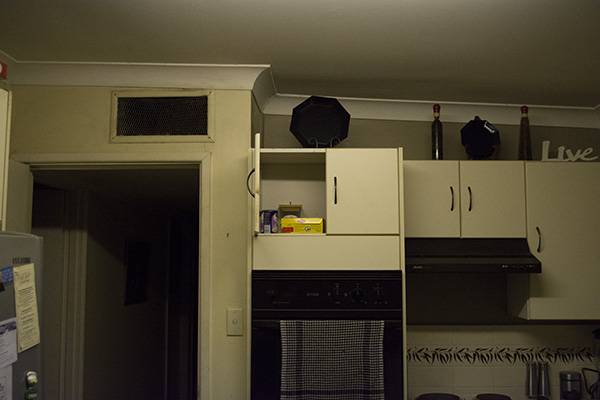

there are more , some have the yellow on the roof and one is completely yellow
they get a lot worse i can post more , i even tried on burst mode and each photo has a different degree of yellow with the odd one that is ok

Auto WB will often vary shot to shot in some lighting situations, which is why it's recommended to set it to something specific when shooting a series of photos to be viewed together or bracketed images for HDR. I supect that if you were to open these in camera RAW you would see a different WB value for each.

yep tried the white balance flouro same result ill post exif for each image
If the EXIF doesn't contain the specific WB value take a look in LR/ACR and let us know what it is. It shouldn't vary on a fixed value, so perhaps you somehow turned on WB bracketing on your camera?

image one , f4.5 , iso 4000 , 1/320 , center weighted average , wb auto , aperture priority
each one is exactly the same

im under a flouro light , in a five burst set they are all different , when i shoot single and wait a bit they are all different
white balance is not set too bracket , i have ae set too function button so i can use it while using the back focus button these were what i was playing with when i noticed these shots when testing if i liked the back focus or not

i dropped the iso back too 1000 and seems ok , i didnt think pushing iso that high would show yellow in different areas like it is doing

oh yes im just shooting in jpeg for testing , still i wouldnt think this would happen , would the 4000 iso cause this , seemed ok when dropping back too 1000 hints of it at 1600

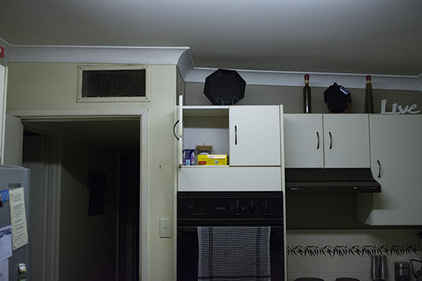

I've been thinking about florescent and LED lights for awhile. I don't have the shooting experience to say anything firm on this and I have not read much. But don't florescent lights flicker? The phosphors have a bit of afterglow to even things out a bit, but they are still pulsed and I'm sure their brightness varies over the power cycle. Older lights pulsed with the line frequency. 50 or 60hz, so they are without power 100 or 120 times a second. The phosphors keep them glowing during the off period, but I have to think it drives auto white balance and metering crazy. Newer electronic florescent ballasts can speed this flicker up into the khz region, so less noticeable and less likely to drive sensitive people crazy in schools and offices. Newer lights might be less problematic for cameras too. LED lights have even greater potential for problems. Depending on the power supply, they can be rock steady or with a very simple power supply, they vary from full on to full off at twice the line frequency. If they are controlled by a fancy dimmer, the frequency can be anything. We know florescent and LED lights can make our videos crazy, why not cause inconsistency between still shots?

yes the example in the link is exactly whats happening , at high iso higher shutter speed it gets worse like the blue to orange images in the example and at low shutter speed it is there but better , makes sense , well this does present a problem when shooting under fluoros anyone got a technique too combat this? here are the examples
the problem in post process is a quarter too half the image is incorrect white balance so fixing would require masking
here is the exif data of the first two images as they are very different , i believe it is pulsing light which makes sense

as far as raw white balance numbers go , two of the images that are the most different had the same temperature 3750 and on had +38 tint and the yellower one had +39 tint

I think slower shutter speed or flash will solve the problem. The shutter needs to be open long enough to 'paint' the sensor with a full cycle of changing light color.
