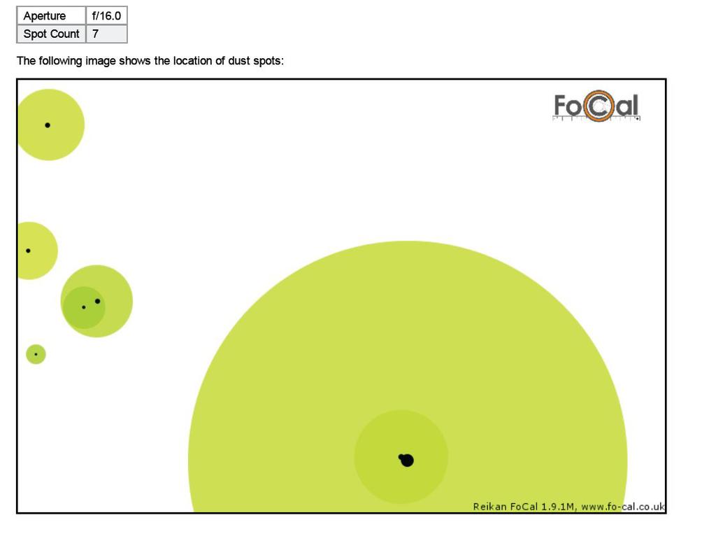

I FINALLY got around to setting up and playing around with the Reikan FoCal program. I tested my 50mm on my D600 and D7100 and came away with some interesting results for aperture sharpness, fine tuning, etc. But since I own a D600 the Dust Analysis in FoCal was another reason I bought the program.
I bought the D7100 as a backup when I sent my D600 in for shutter replacement back in July. I haven't cleaned or blown the sensor on either since then. Probably the same number of shots between the two. I thought it was funny that my D7100 had more dust than my D600. Maybe the D7100s have a dust issue as well. Either way I'm not really bothered by the results just thought I'd share. It's unfortunate about all the D600 owners, but throughout this whole situation I've never been affected by the dust in my work. Just affected by knowing it was there.
D600 @ f16 with my 50mm counted 7 spots

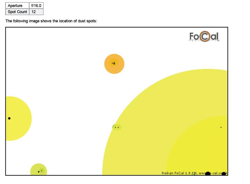

D7100 @ f16 with 50mm counted 12 spots

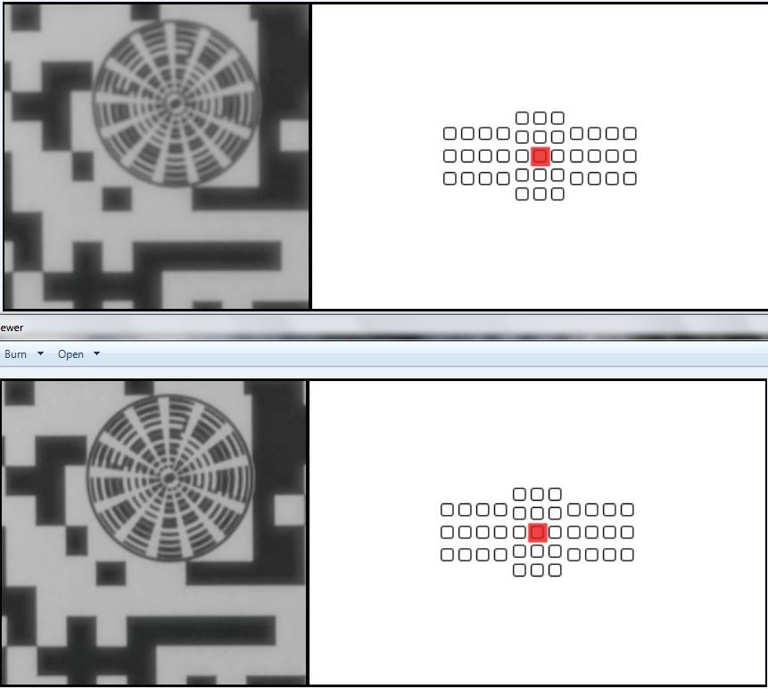

Here's a snip of my 50mm 1.4D lens results. To give you some scale, the little circle is about 2cm wide. The "target" I was shooting was over 14 feet away. The top was the lens from factory and the bottom is the lens fined tuned to -12. I can see a difference but how much of a difference does it make??? I don't know.
