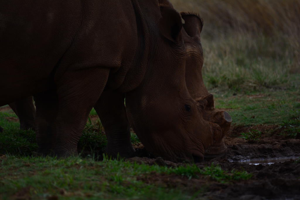

So yesterday I finally managed to save up to upgrade my D3100 to a D7100. I was so excited I instantly went to a game reserve close by. (I live in South Africa). After about an hour just trying to sort out the AF controls, I finally got to shooting with factory default setting. I usually shoot in manual, but I found this impossible yesterday. For some reason every photo came in too dark. It was a very sunny day, but I just couldnt push my shutterspeed up above 600 with my apperture a f6. At times I had to shoot at shutterspeed of 60 just to be able to get a photo taken. I used different lenses, so its not a lens issue. My main lens is the Sigma 150-500mm for wildlife, but I did try my nikkor 55-300 mm and my 18-55mm nikkor as well. Same issue. I know this is not normal with the camera as some people take perfectly fine photos at 1/8000 shutterspeed on this camera. I missed an amazing shot of a springbuck flying through the air yesterday because it came out blurry due to shutterspeed being so low.
So when I got home, I popped out the manual and tried a variety of settings. Nothing seemed to alleviate the problem. Is this an id10t error, or was I one of the unluckey few who got a factory defect that wasnt picked up? Any help would be appreciated.

Ok, I tried to upload these photos. As you can see, they are very dark

Looks to me the exposure compensation was used - it should be at "0" to me it looks like it's at - 1.7 or more. It's that little button with the +/- on the top of your camera close to the shutter button. Press it down and spin the main control wheel(might be the other on the D7100) and make sure it's at 0

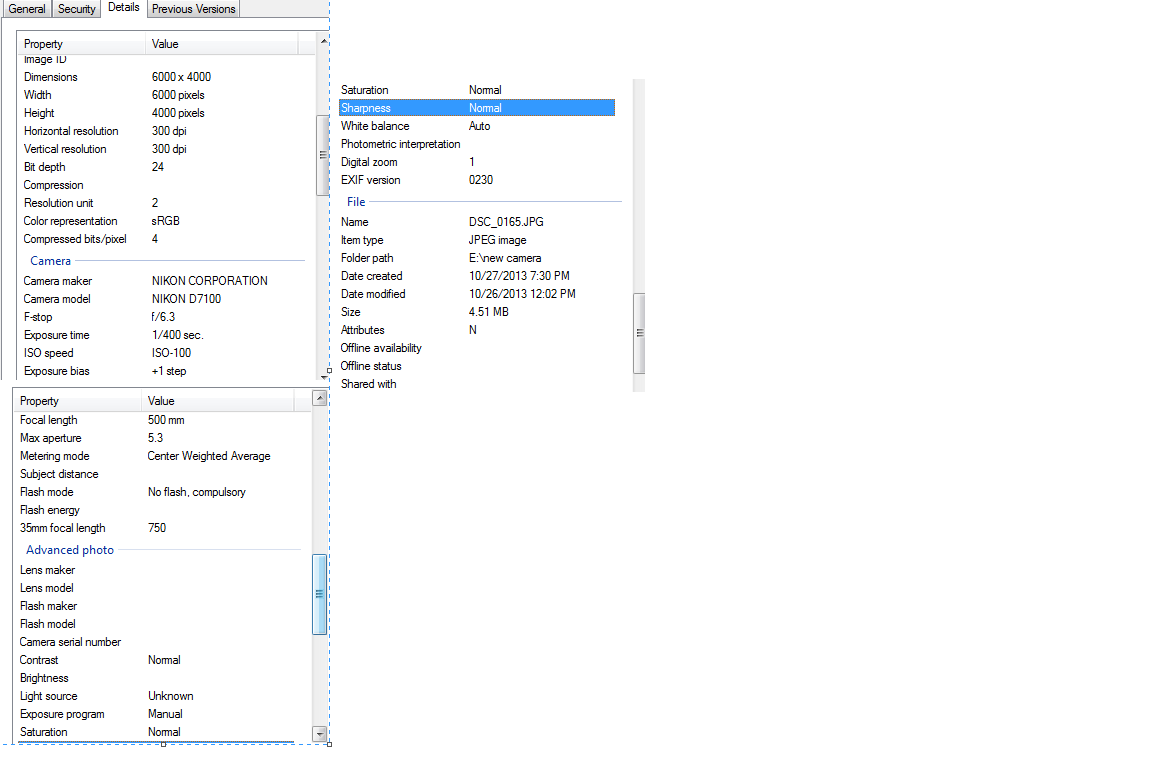

Exif data for the pic with the bird. Soz for the format but I didnt know how to put it into a text file

These look simply under exposed. No exif data came through, but that is hit or miss. I'm thinking your camera would warn you in the viewfinder that exposure was not correct. (unless you had some compensation dialed in, but you said earlier you did not.)
What mode were these shot in? And did your meter say all was good? First shot looks like maybe you were in shutter priority because it looks sharp although under exposed. Second shot, maybe shutter priority also, but at too slow a speed for your lens. If this very same shot was made in P mode or aperture priority, I would expect an even more shaky shot, but well exposed.
If exposure compensation was not accidentally used, I suggest higher iso, whatever is needed to get a safe shutter speed for hand holding and also keep your exposure meter 'happy'.

The Metering on your camera is set to "Center"; you might do better with "Matrix" metering.
Also, Exposure Compensation has been set to "+1", set that to "0".
With lenses that long I would recommend you use "A"perture priority mode with Auto-ISO and a high minimum shutter speed (like 1/400 or so) as well, but that's up to you.

Just saw your exif. +1 won't cause the problem. It would actually call for some over exposure, but the light for that to happen with your settings was not available, so you still got an underexposure. I don't know that 500mm lens, but even if it has vibration reduction, you risk a blurry shot at 1/400. I think higher iso is the answer.
