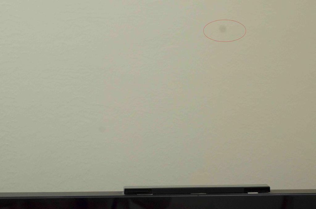

Problem: Faint, dark circle on all photos, regardless of lens
Scott Gehman
I just noticed a faint, blurry, dark circle on all of my recent photos. It's not related to the lenses or exposure. The circle is about the size of the sun or moon if you were to take a shot of it with a 70mm lens. Cleaning didn't do anything. The camera is a refurbished D7000 I bought from Adorama in April.
Any idea what's wrong with it before I send to be repaired?

Scott Gehman
Mysterious dark spot.jpgThank you for so many replies! Here's a sample of the issue in question. The spot is circled.

I meant the cleaning option in the camera's menu. The spot appears with all lenses. The shots are at wide open, maximum aperture (a small F number).
I've noticed now that the spot has been in most of my pictures since I bought the camera, but I only noticed it recently (I thought is was variations of sky or cloud contrast.)

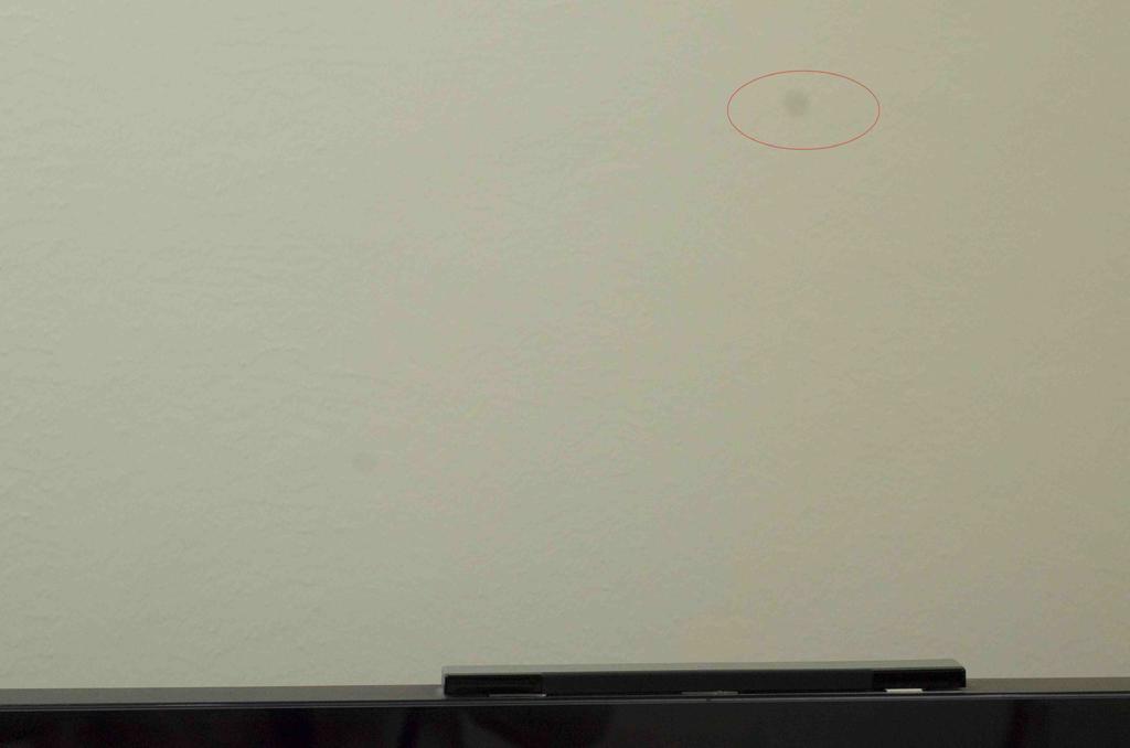

Scott Gehman
Above is a shot I took of a blank wall. The lens (50mm 1.8) is wide open. I don't think it's dust because the blemish is too big. I'll try stopping down and will upload the image if it is much different.

I think you have more than one spot. It does look like dust and it means you'll have to google "dust on sensor" or "sensor cleaning", or, read in the manual about how to do it.
It's something that is unavoidable with DSLRs. Some seem to be more vulnerable than others, but at some point, the dust has to be cleaned out.

Did you look at that link I posted above with the samples of dust in various locations? That sure does look like dust or pollen or a tiny droplet of who knows what on the sensor. Did you try at a high aperture? I think you will see more at high f stops. Dust on the sensor does not look like 'dust' in the picture, it looks like darker, very out of focus orbs.

Definitely looks like dust, and if that's at the max aperture then it's likely a big chunk of dust. I suspect something that big should come off with a good shot of air from a bulb.

Yes, I've confirmed that it is dust. It didn't occur to me that depth of field is at both ends of the lens - the image being shot and the film plane. Apparently, the IR filter that the dust is on keeps the dust far enough away from the sensor that it is out of focus at wide apertures and in focus when stopped down.
