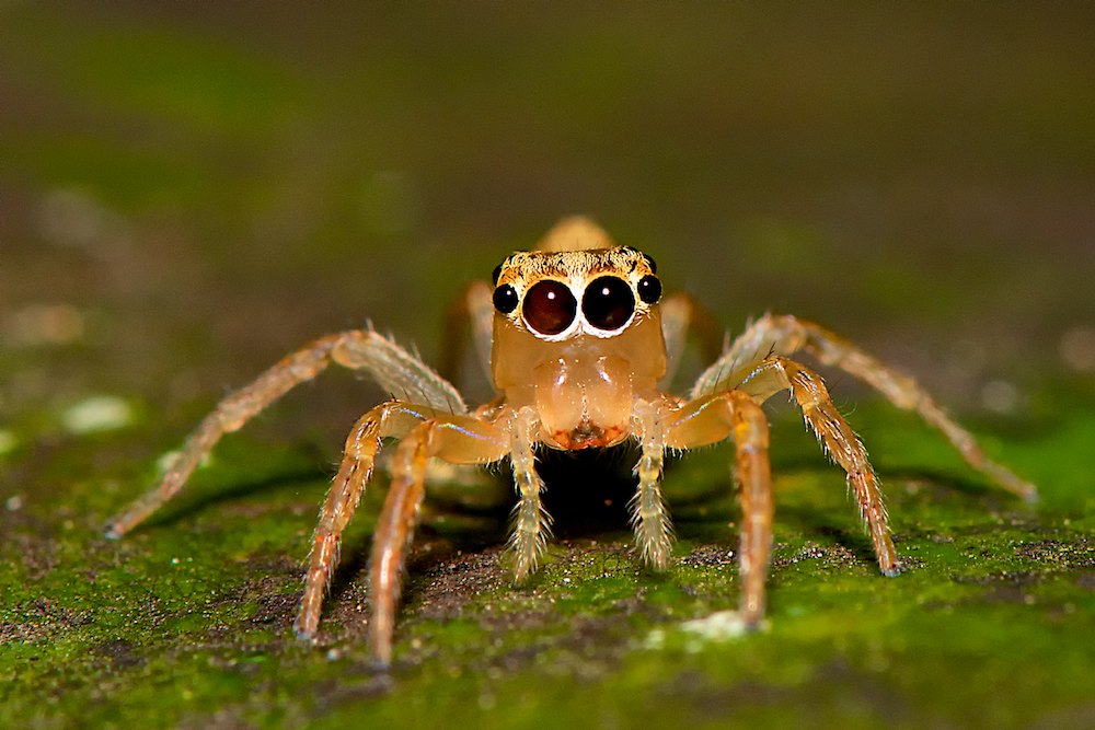

I tried the foam diffuser today, it didnt give me a lot of luck. I think the flash is sitting a bit high and it doesn't light up the foam as well as I would hope for.
This is one of the better shots I got using the foam diffuser.
Nikon 105 f2.8 @ f16, 1/640th, +3EV, ISO 100.
I cant remember if this was the foam diffuser or the fold down diffuser.
This little spider jumped onto my arm.
f16, 1/1000th, +3EV, ISO 100.
This one is with the fold down diffuser.
f16, 1/1000th, +3EV, ISO100.
I think I will try and make a custom job that has something to deflect the flash light down onto the foam on the end of the lens.

Brad.... they all look good here, that first (with the foam) is especially good!!
