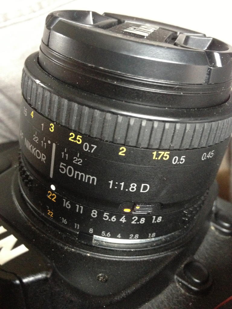

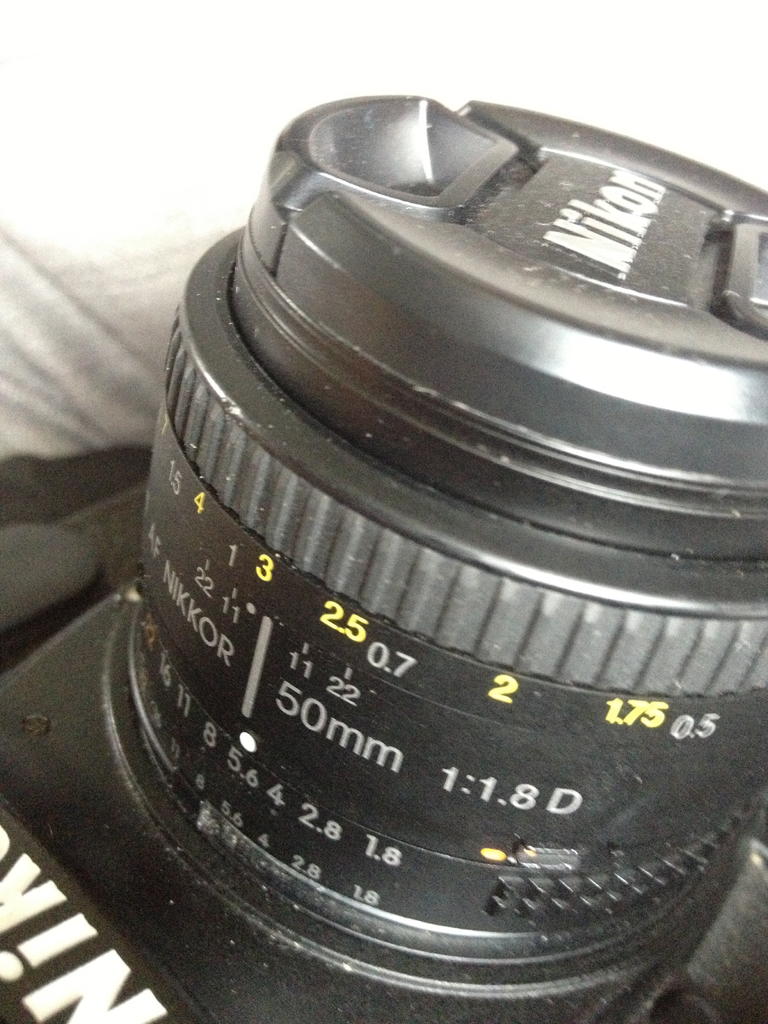

Got me a Nifty-Fifty (AF Nikkor 50MM 1:1:8 D) lens. Great for shooting rock concerts in low light, yeahhh!
However-
It won't let me lock into any lens opening except F22, and if I adjust any lower, to 16, 11, 8, 5.6, etc, my D300 gives me an error signal of
EE and won't take the photo.
Looked up in instructions, did the Google thing, maybe you guys can help. Photos (taken with dusty iPhone, sorry) below, and thanks in advance.

Sounds like it's working exactly like it's supposed to. Set it to f/22, and your D300 will control the aperture with the coupling lever in the lens mount, the same way it does with a G lens. You don't need to touch the aperture ring on the lens at all, hence why it has that handy locking tab at f/22.
WayneF
"Locking" at f/22 is siimply necessary calibration to the camera metering system, and does not affect the aperture you choose to use. It is the necessary instruction. Just do it. :)
