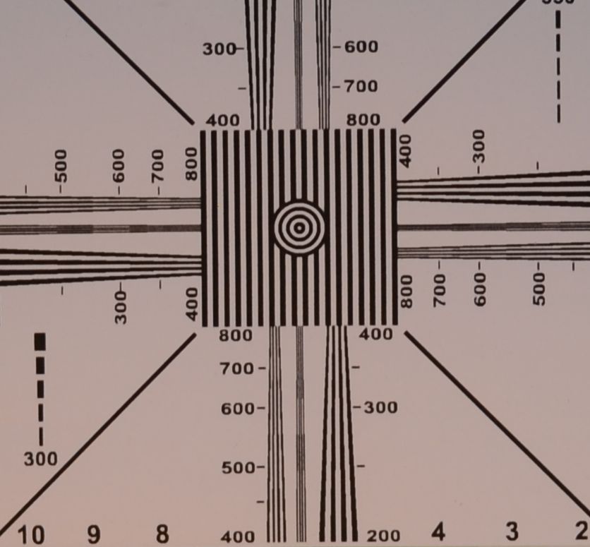

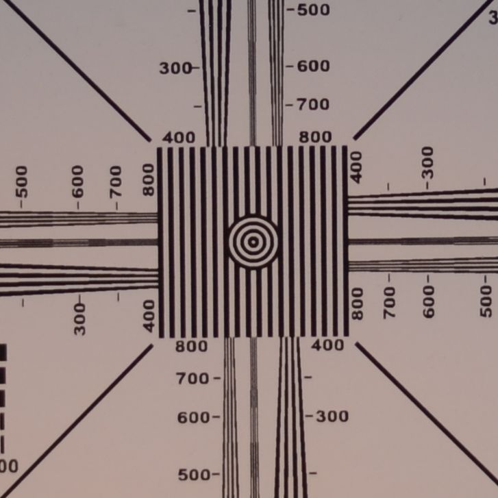

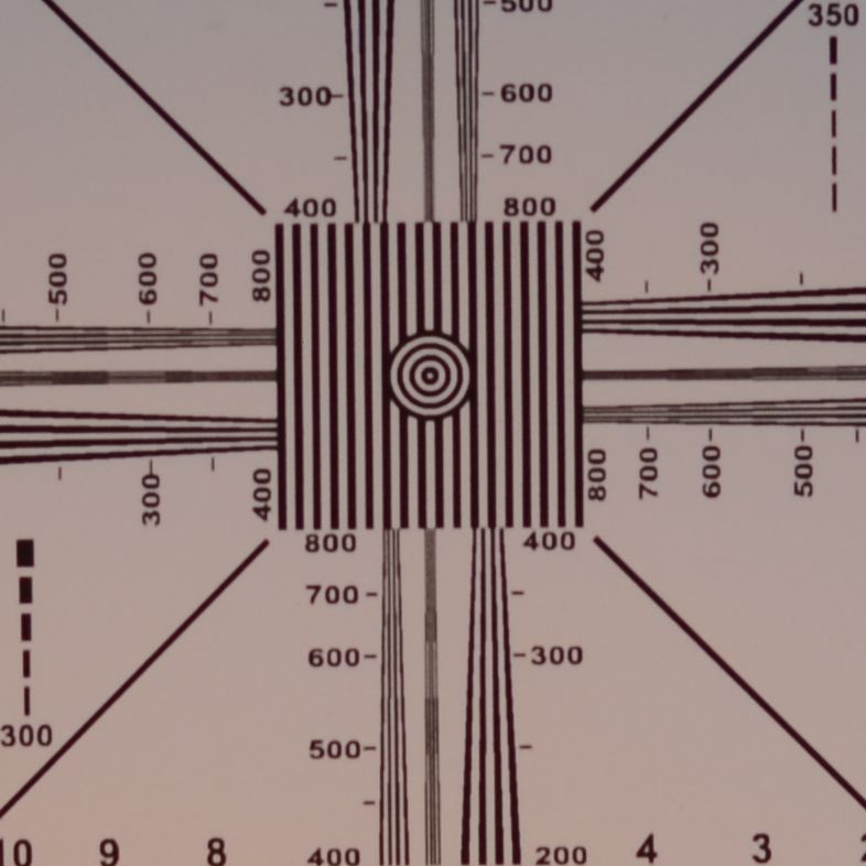

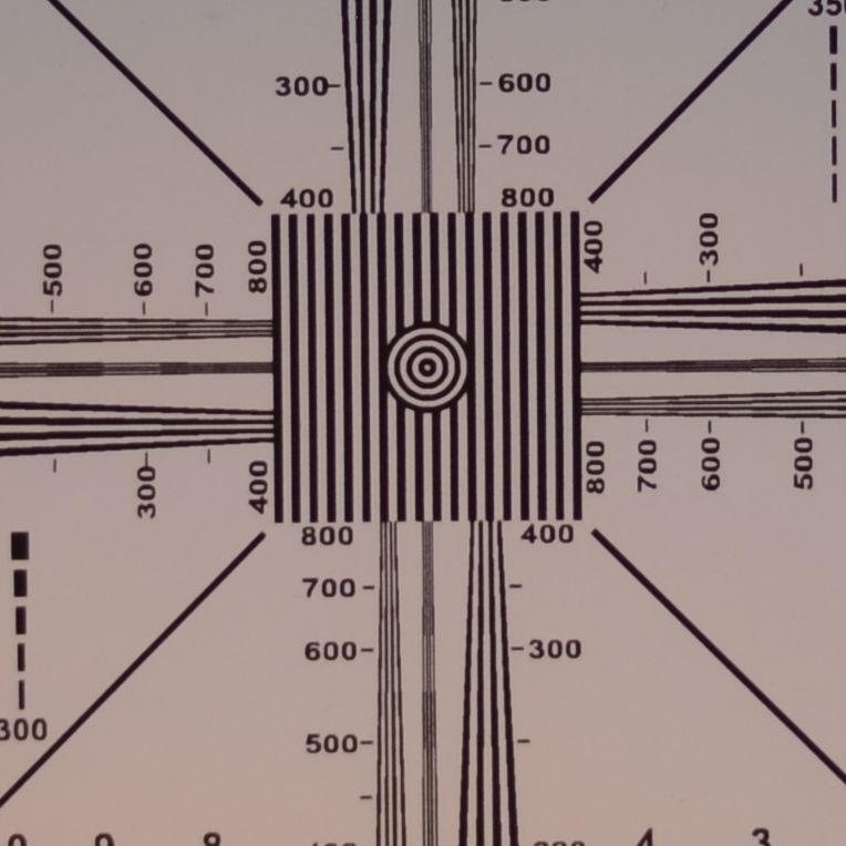

i bought a nikon d5100,(awesome dslr btw) and was taking pictures with the kit lens. some weeks ago i bought a Nikkor 50 mm F1.8G. and the first fews pictures was awesome till i look at my computer screen, i mean the full crops. i realised that most often the lens or camera misses focus..
i made a couple of test shots mounted on a tripod at apertures 1.8 and 2.8 which i posted below..
i took 2 shots at 1.8 and 2 shots at 2.8 mounted on a tripod.
distance to test chart , more than 1.5 metres away.
can you please tell me if the focus is right or i have bought a bad copy of the lens..
thanks,
regards,
shaahir
1. full crop at f1.8 (first picture)
2. full crop at f1.8 (second picture)
3. full crop at f2.8 (sample one)
4. full crop at f2.8 (sample 2)

Possibly a little soft. What shutter speed and ISO were these taken at and were they shot in JPG or RAW?
If you shoot in JPG, have you adjusted the in-camera sharpening setting? For whatever reason the factory default for that setting is really, really low.

If you're going to scrutinize at 100% with focus charts, you may want a body that allows focus tuning. They may be a bit soft, but at 100% and not knowing all the settings/parameters of the test, it is hard to tell. You need to be using a rock solid tripod, high shutter speed and low ISO to give the lens a chance. You should also focus it in live view to see if it is the lens or the auto-focus.

Came back to look at this thread and found there is EXIF data attached to your shots. This is very helpful information.
According to your EXIF data you're using *really* slow shutter speeds, e.g. 1/20, and as Rick M pointed out, if you're going to be looking at focus charts at 100% crops that's just too slow. You could be inducing focus error by manually pressing the shutter button at that shutter speed, not too mention the possibility of mirror slap doing the same.
If you want razor-sharp focus, your shutter speed needs to at LEAST equal the focal length of the lens being use (i.e. shutter speed of 1/50 with a 50mm lens) and I prefer it to be a little higher than that. For focus testing on chart I'd want a shutter speed of no less than 1/125 on a tripod using a remote release at the cameras base ISO.

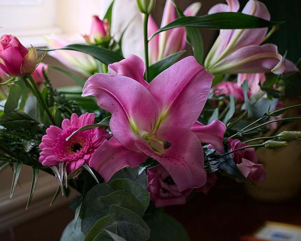

wooooowww... thats the ''king-kong'' of sharpness..mine looks like a stupid chimpanze....i'll work my technique to achieve such sharpness or i got a lame copy..
was this sharpened? or high iso, i notice some noise in the background :)
wornish
The shot was taken at ISO 100 I didn't do any noise reduction and just a little output sharpening for the screen.
The background is blurred because of the focal length used, at 100% it looks a little like noise but its not.
I find you get better sharpness for stationary objects using a single focus point. Multiple ones work best on moving objects.
​I cheated a bit on this one as I used Live View which I don't think a 5100 has.

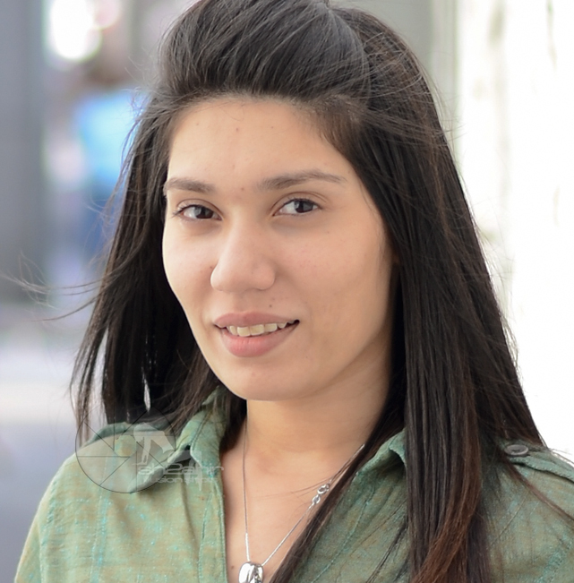

shaahir
i took a couple pictures of my friend minuutes after i bought this lens.
setting used:
ISO: 100
aperture:1.8
shutter speed: 1/250
ev gain = +1step
those are unsharpened pictures
1: full image
2. 100% crop
i guess maximum sharpness for this lens is at aperture 4 and above..
i shot this pic at f1.8 to get that depth of field.
thanks :)

Considering these are your first pictures with the lens, and handheld I think these are pretty good. If you try a little sharpening they will improve.
I used Lightroom on your 100% crop here, maybe overdone it a little but you can see more detail.
