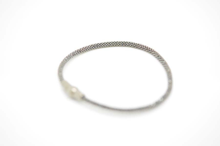

I have bought a Lightbox, placed a ladies Bracelet within it and am trying to photograph it, but am struggling. I can get the bracelet to be in Focus at the Back, or Front, but not both. Please see attachment.
Camera used: Nikon D5200
Lens used: Nikon 60mm 2.8
Settings used, 1/60, F2.8, ISO 100.
I tried increasing ISO but then my light is just not powerful enough to cater for a higher F stop such as F28, as some one told me that that's the only way I can get the entire bracelet to be in focus.
Can some one please advise/guide me?

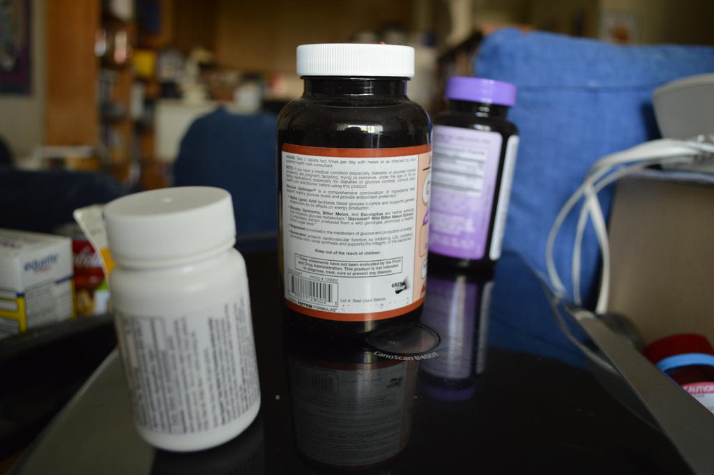

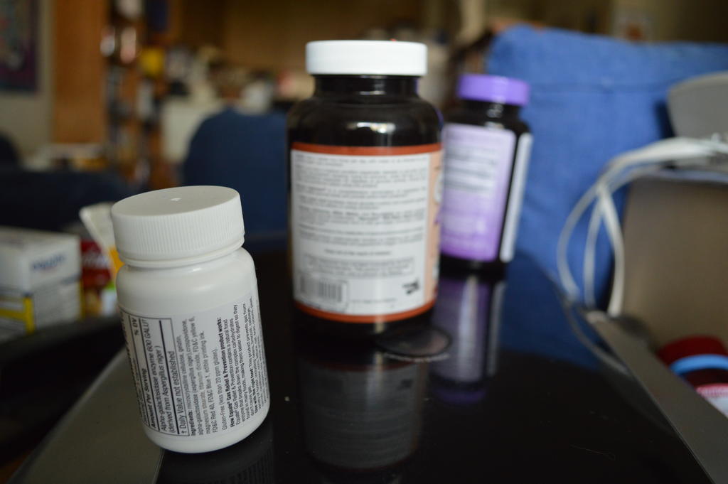

From this series of photographs…

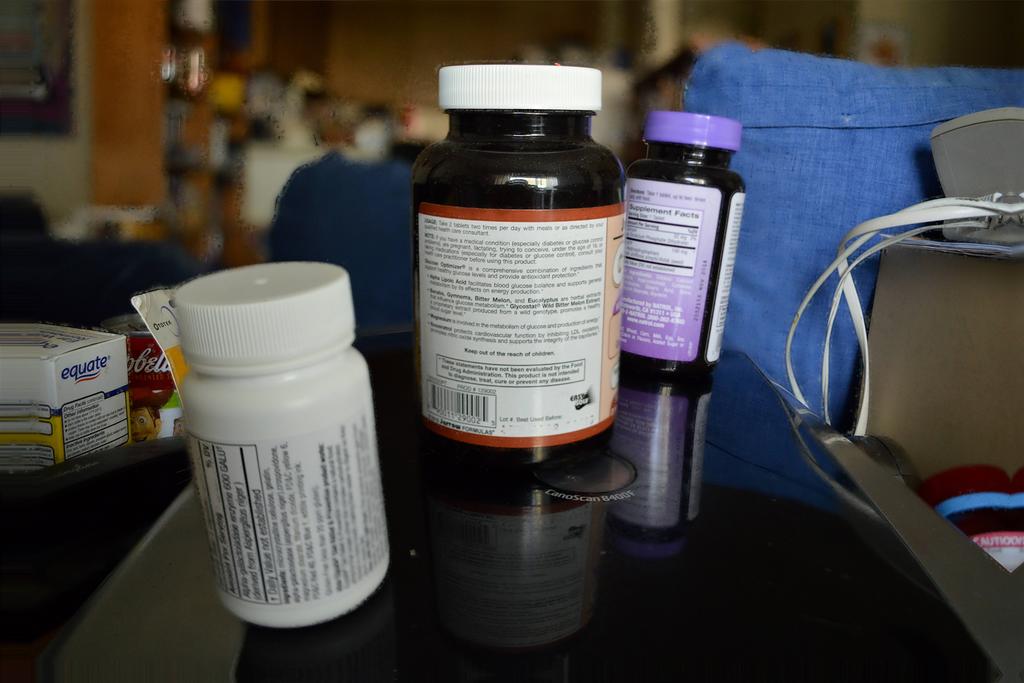

…I produced this.
