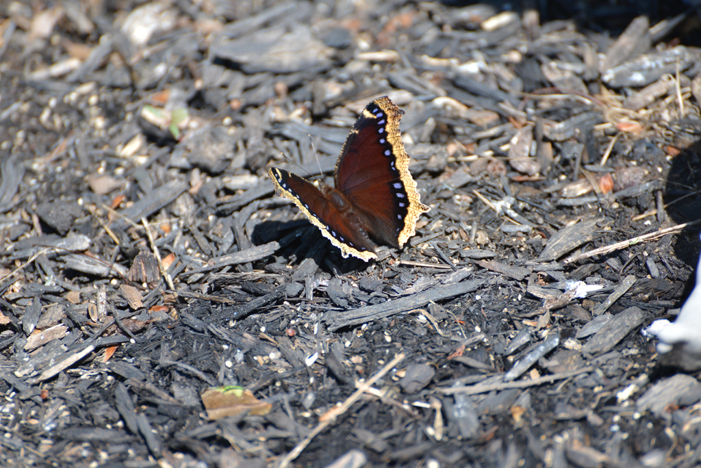

My D600 consistently front focuses with both my Nikon 70-300mm f/4.5-5.6 and Sigma 70-200mm f/2.8 lenses. Attached is an unedited photo (except for resizing) which was taken at 300mm using autofocus (single point AF-S), aperture f/5.6, shutter speed 1/400, ISO 400. The focus point was towards the far end of the body near the butterfly's head. It is even more apparent when using the Sigma with a wider aperture, but those photos are of students performing on stage which I won't post because of privacy issues.
I read another thread (in the D7000 forum I think) about back focusing, but the link for what to do doesn't work. Does someone have a recommended link on how to fine tune the focusing issues? I don't have this problem on my D90 so I feel a little technically challenged at the moment. Thanks for any help! :)

Back and front focusing is fairly common and as long as it's not too far off, the Fine Tuning function works fairly well. If on the other hand you cannot achieve a sharp focus using FT you can send the camera body and lens to Nikon and they'll do a full adjustment for you.
Rick M
The angle of the shot may be the issue. Shoot something level and perpendicular to you and see how sharp it is (I use a stop sign). You can also take a more scientific approach with the focus cards and set up the exact angle you need. Also long range shots on a small subject sometimes puts the entire subject in the focus box. You can check in the nikon software to make sure of what it focused on.

I don't think it is just the angle of the shot. I notice it in many of my photos when using the D600 with three different telephoto lenses but not when I use the D90.
