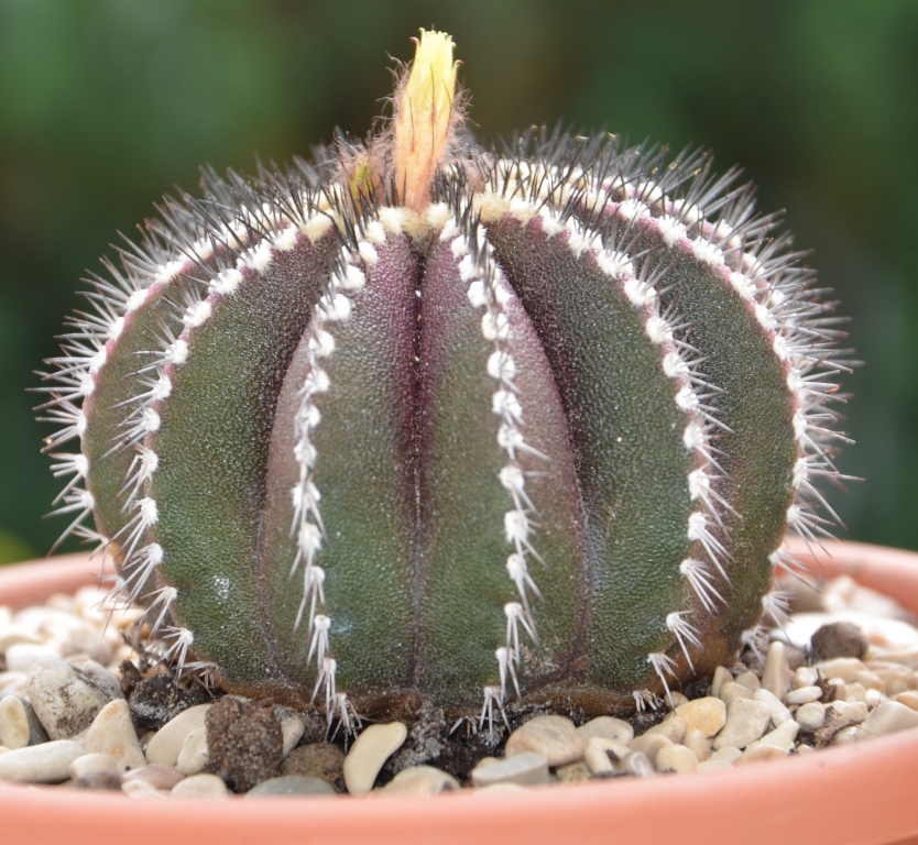

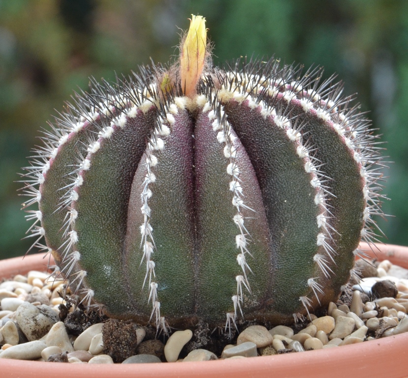

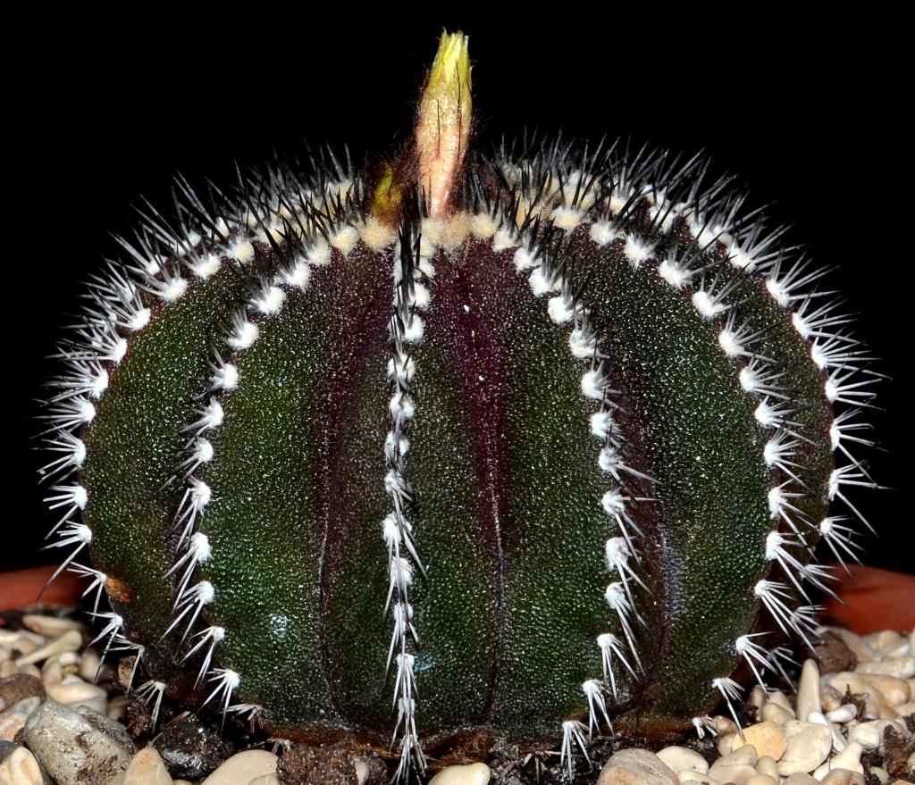

I am still studying my first SDLR camera. I bought now a 18-105vr to my D7000 for a walk around lens. I have encountered the following problem.

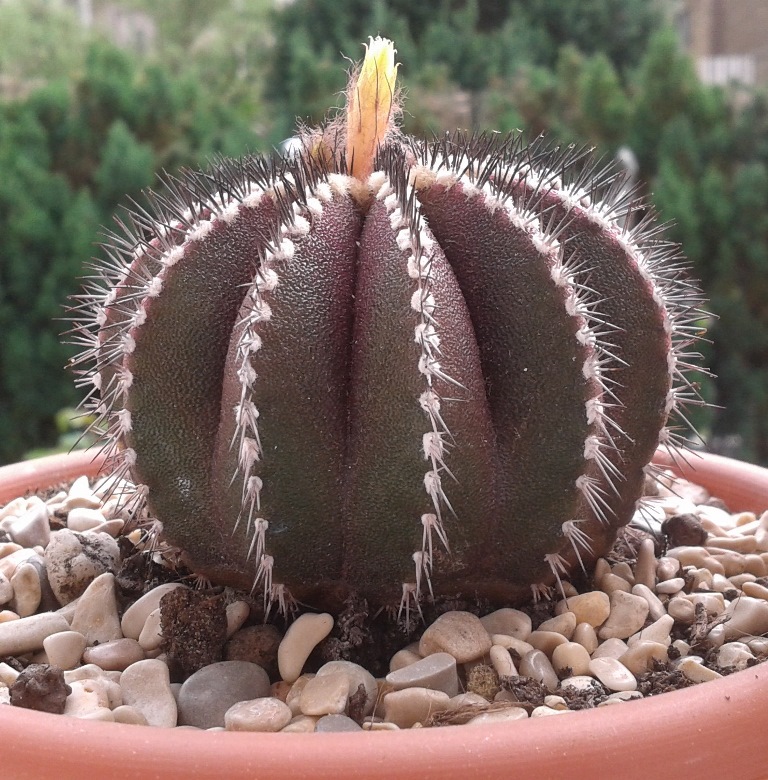

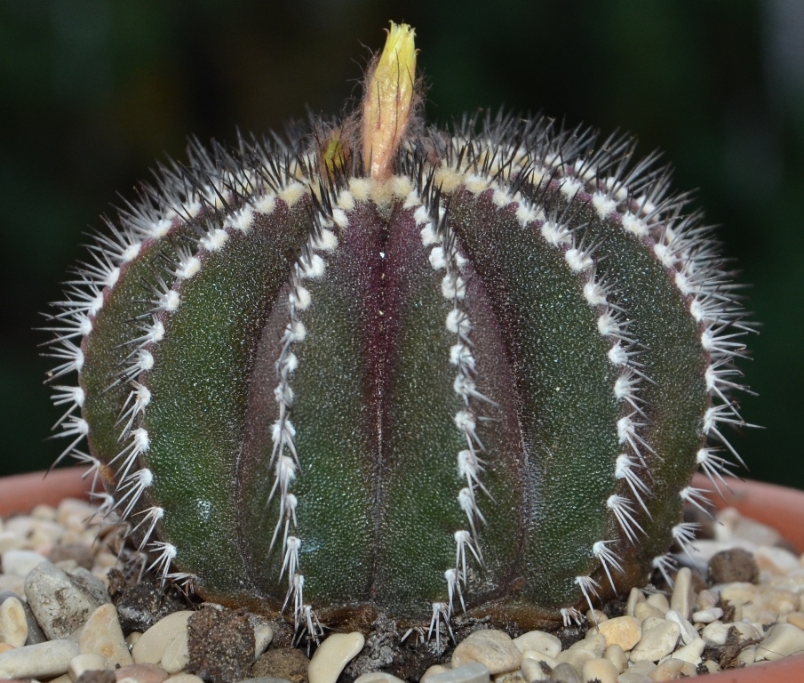

I tried to photograph my cacti. And many times it occured that I cannot make sharp pictures from the cactus. Here is an example what I am thinking of. The firts picture made with my mobile phone. As you can see every ribs and spikes are sharp. On the next picture made with the camera using Scene-Close up settings you can see some of the ribs are obscure. What should I change? I tried to use the A function with different F-stops, but I am not sure that that is the problem. Any ideas?
Thank you in advance!
You have probably two different problems going on. Depth of field, a smaller aperture (Larger number) will help. Also it looks like it is not in focus to begin with. You may be to close. Back up some or buy a macro lens.
Fred Kingston
Looking at your EXIF data... I'd say your speed was too slow for hand held... You should increase the speed (or use a tripod)...
Never mind... I see the flash fired... Maybe Don has the right idea... that lenses minimum focus distance is 1.48'...
stmv
Point and shoots benefit by having (due to their small image sensor size, large DOF), since they are really intended for the quick shot.
SLRs are requiring knowledge of speed and focal length. You should not need a tripod in the conditions you were shooting in.
Keep the speed up over 250th a second, hold the camera steady, and controlled push on the shutter.
Also, hold a camera a split second on the subject, people have the habit of pulling away the camera from the subject too quickly, and inducing blur.
Horoscope Fish
Looks like a depth of field issue to me as well. See how "in focus" your background is in the mobile pic, and how blurry it is in the D7000 pic? Even bigger indicator: Note how not even the lip of the pot is not in sharp focus on your D7000 shot. That alone tells me your depth of field is quite shallow. To correct this issue you'll need to use a smaller aperture while keeping your shutter speed up around 1/250 or so (you can shoot slower if you're able to use a tripod of course). I also wouldn't let my ISO go above 200.

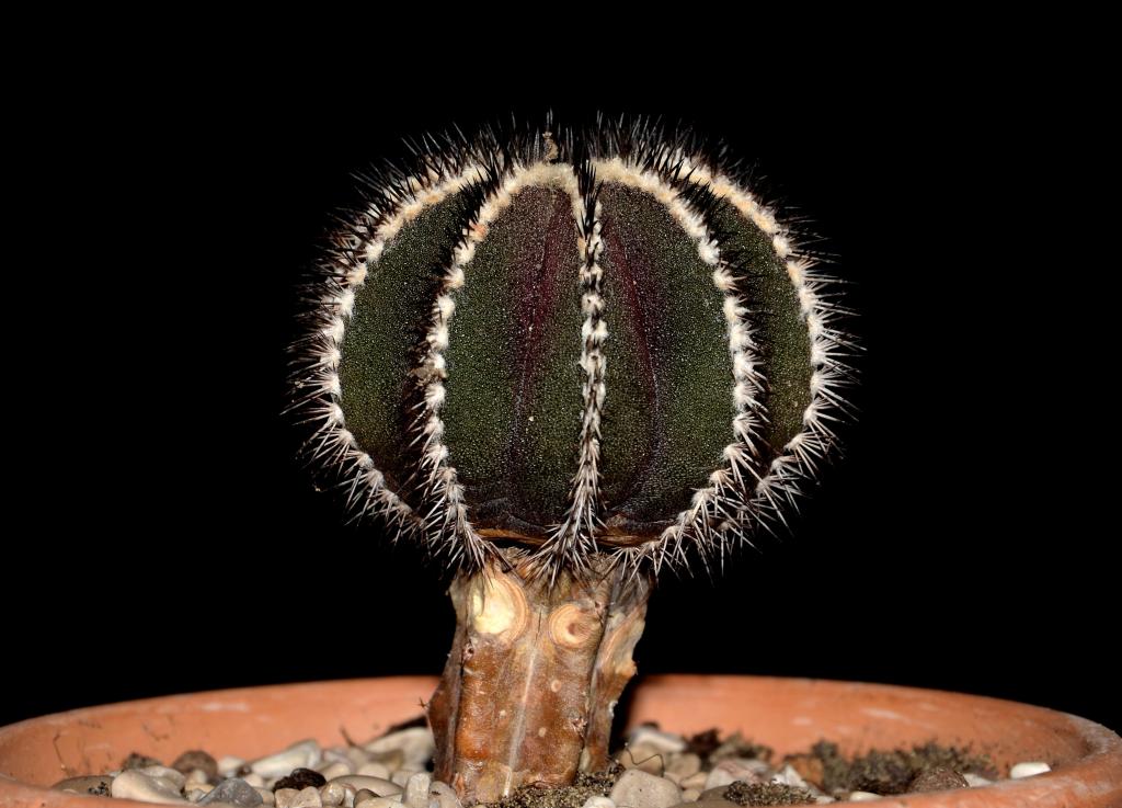

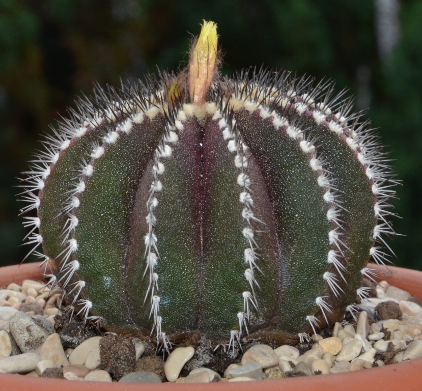

Hello guys,
thank you very much for the quick replies. I made some further shots. Used manual setting this time. Higher ISO, shutter speed, flash etc. Please check it if you have some time.
I think on some pictures I managed to improve it a bit but the closest parts of the cactus are still more obscured.
Horoscope Fish
A few suggestions:
1) ISO 400 isn't going to get you the best possible sharpness. As I said before, not above ISO 200 and ISO 100 would be better still.
2) At least one of your shots uses f/8.0, which is fine, but if you want a deeper depth of field for "macro" shots like this, you're going to have to stop down... Mmmm, probably two more stops.
3) Dump the flash. That's not going help here in my opinion.

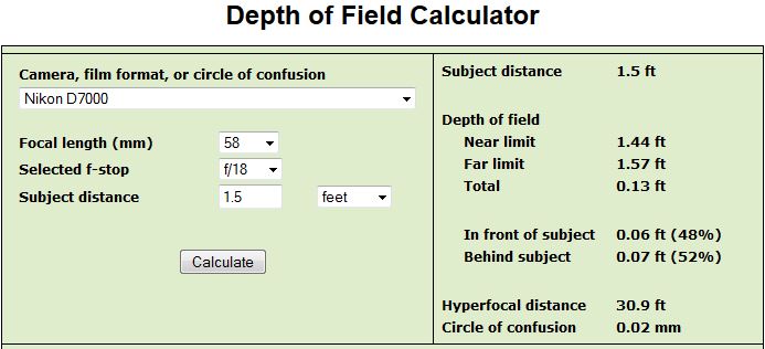

You shot one of these at f8. Which at this distance is still going to be a very narrow Depth of Field. The one shot a f18 is a little better. With a zoom you might not be able to get the entire cacti in focus. Do a little research on Depth of Field with that lens.
Assuming that you are 1.5 feet away from the subject. At 58mm where you were on these photos. and at f18 which was your smallest aperture your DOF would be.
So that is around an inch that can be in focus.
GO to this page and play with distance using the same aperture and focal length and see what the difference is. The further away you are from the subject the greater the depth of field will be.
Online Depth of Field Calculator
Get a distance/aperture/focal length combination that will get a DOF great enough to get it all in focus and then reshoot. Then crop the photo to get jsut what you want in the shot.

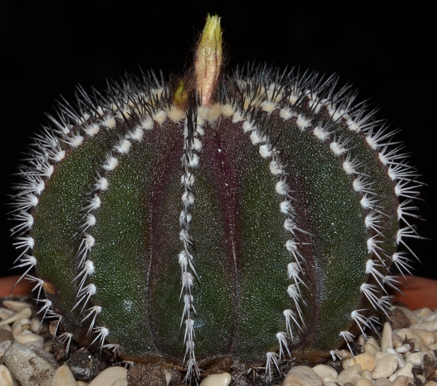

Ouch, I read it wrong and set a higher ISO instead of low. Last try for today, bit better but still not good. :(
So, is it not a problem that I am trying to aim/focus on the most obscured part and still that one is not sharp only the rest. Does it not mean back focus issue with the camera or something right?

That last photo looks wicked sharp, possibly too sharp. That's probably due to the flash. It really separated the cactus (cati??) from the background in a weird way to my eyes.
Remember, when shooting JPG, your camera will adjust things like saturation, sharpness etc all within the camera. When you post process a JPG that's already been dealt with in camera, you're going to add to what's already been done. (to an already lossy file to begin with)
I think that flash is making things crazy. Try using a longer exposure with a tripod if you can't get the shutter speed to a decent level to handhold it. I'd also focus on the darker parts of the cactus and spot meter to see if that would bring out some more of the shadowy details too. It's all in experimenting. Since we can't see the actual light it's being taken in it's a little harder :)
love the depth of field calculator.thanks for the link.in my favorites now.
