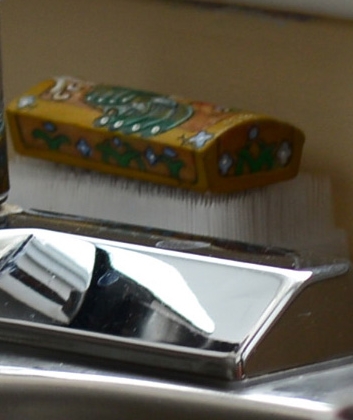

I did the same experiment I had done with my 7000 a few years ago. I took the same picture in normal single mode and then in quiet mode. I had read that the most apparent difference will be when shooting between 1/50th and 1/200th. I found that the quiet mode pics were indeed sharper. Seems the quiet mode reduces the mirror slap factor.
Here are two 100% crops of the center of the images 1/80th, iso 250, f4.5 Rokinon 85 1.4
Normal mode:
Quiet mode:
So for me the Quiet mode has a big advantage for sharpness alone and for the quietness too.

Wow... I think that borders on huge (images brightened ever so slightly to bring up the detail). Quiet Mode pic is on the left, normal on the right, btw.
I'm going to run this experiment on my 5100 just to see what I get.
Thanks for posting this.

There's a big feel difference. With the D7000 & D600 there's a soft, squishy feeling to quiet mode, and it's actually quite quiet. With the D800 you hear the mirror slap almost as much as you do in S(ingle) mode, but the mirror stays up and you don't hear it return right away. Very weird when you're used to the other. I can definitely notice a difference in clarity, particularly with a long lens. Just about every bird shot on my Flickr account, where it's not in flight, was taken in Quiet mode. It made that much of a difference.

The lens is a manual focus lens. I stayed in the exact same position for both shots and tried (did I say tried) to use the same shooting posture I usually use. Now don't try to make me say what I did not. This is not a scientific test, but barely a suggestion for other to try on their own. It's not something that is hard to do, but you'll never know if you don't try it yourself.
I'm not a preacher but just wanted to share my personal results to give others the idea that it could be beneficial for their shots one day.
The guy with the blue shirt… let me see, oh, that's my neighbor ;)

For me handheld is where this pays the highest dividend. On a tripod that sucker should be locked in and tight, so they should ultimately be identical, particularly with exposures where shutter speed and focal length are approx the same. But in a pair of hands where fingers are moving to actuate the shutter that the additional vibration may play a part. Proper technique and faster shutter speeds negate the effect. But when I'm shooting a 500mm lens handheld at 1/400sec with VR on, you can bet that I can see a difference.

OK at general demand, I did the test again with the camera on the tripod. Slower shutter speed (1/30th) same camera and manual lens. So focus is out of the equation completely:
I'll let you be the judges:
Rexer John
Not as much difference but the top pic is definitely sharper.
Easy to see if you save both images and then switch between then in a viewer.
