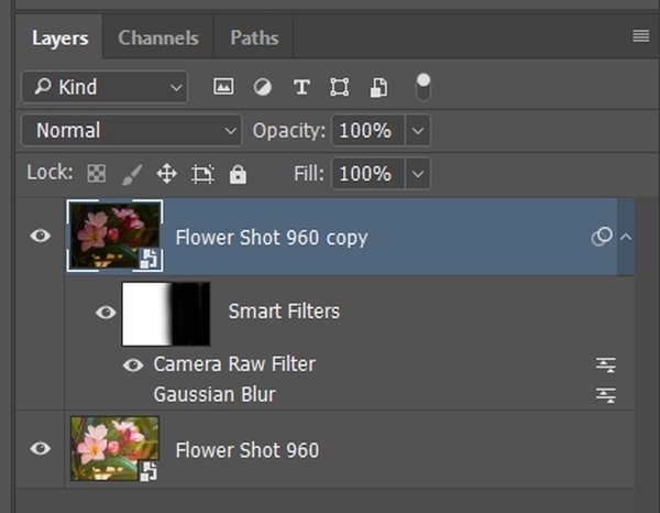

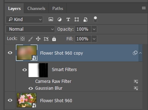

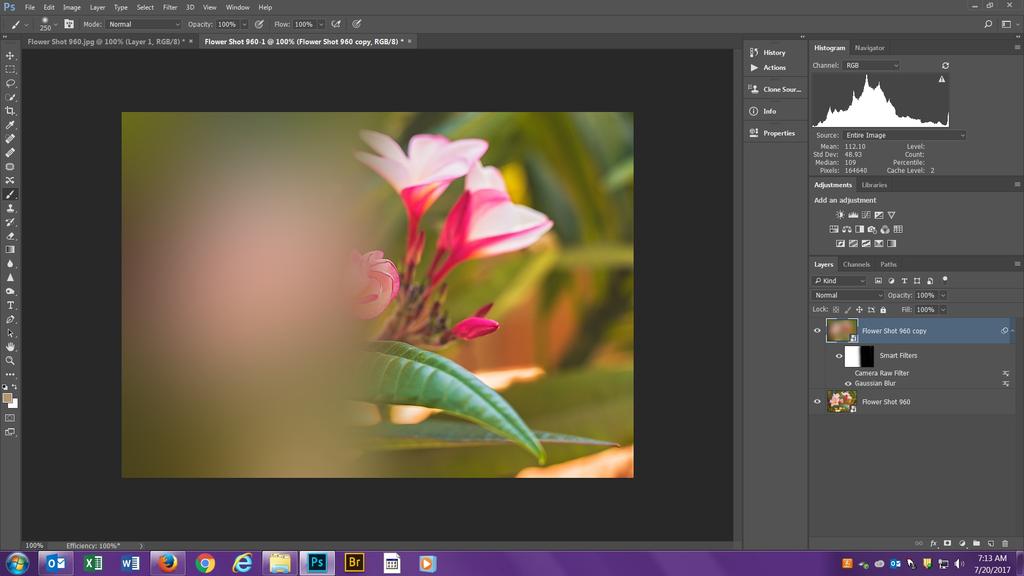

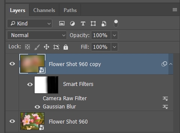

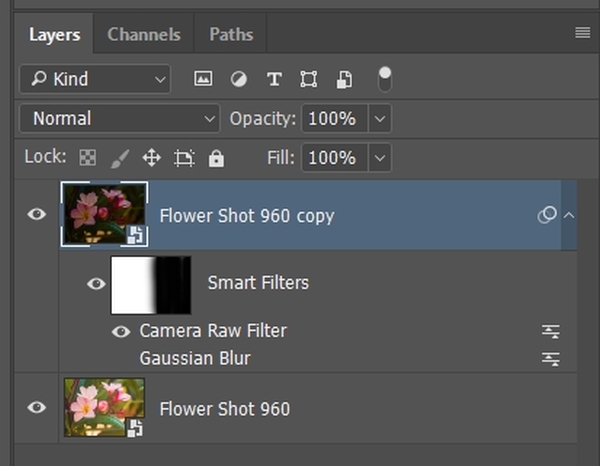

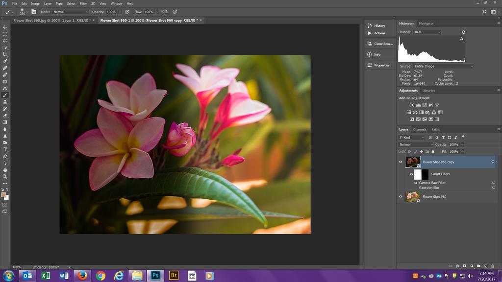

I wasn't sure if this could be done or not, so I just tried it.
What I did was open a .JPG as a Smart Object in Photoshop. From there I duplicated the layer (Ctrl +J). The Copy Layer, it should be noted, opens as a Smart Object; meaning the Smartness carries over, which is nice. I then opened a Gaussian Blur Filter from the Filter Menu which automatically applied a White Mask. I was able to use this White Mask on the Copy Layer just like I would on a non-Smart Object layer. I was also able to employ Camera Raw as a Filter in conjunction with my Smart Object/Layer and Mask THAT layer and so forth and so on. From what I can tell there is absolutely no difference when using Filters or Masking a Smart Object/Layer as opposed to a non-Smart Object/Layer.
Now, I can't really see me needing to do this, personally, but it's good to know I can and I hope I've helped answer your question.
Some pics follow to help show what I did and how things look in PS:
Gaussian Blur Applied and Masked:
Detail of the Layers Panel:
ACR Adjustment (Layer Visible) with a Gaussian Blur (Layer Not Visible)

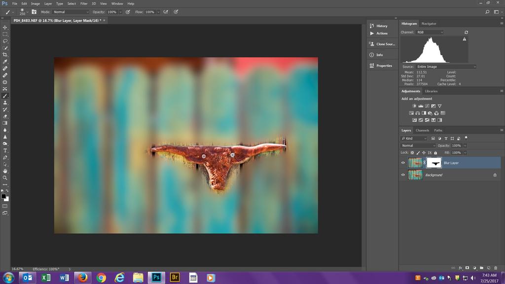

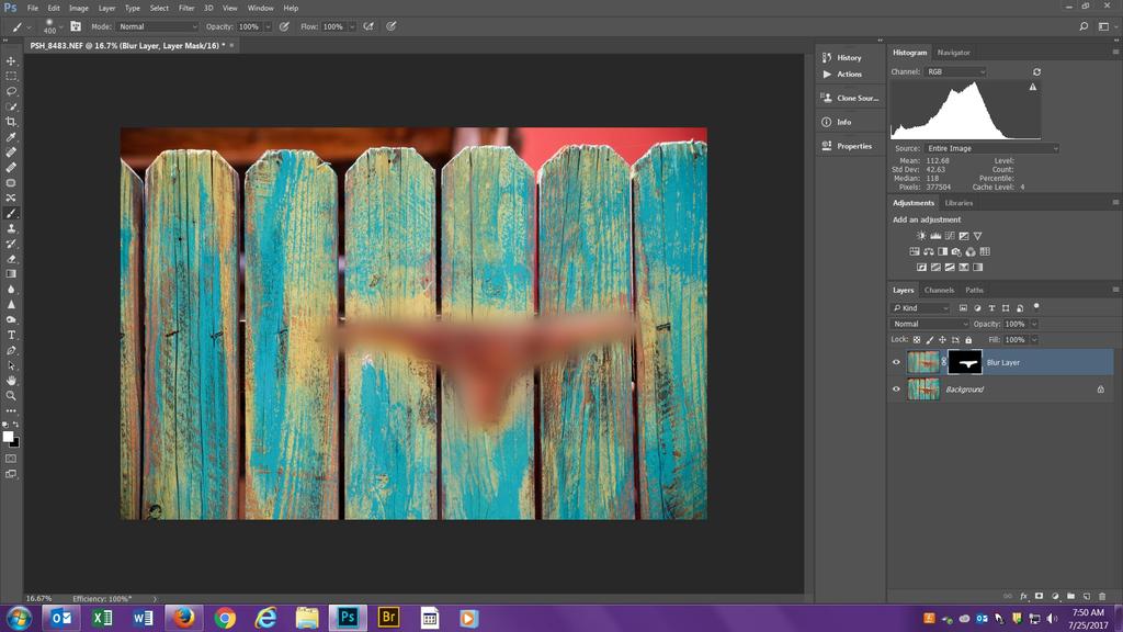

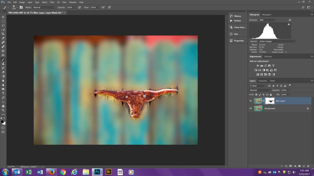

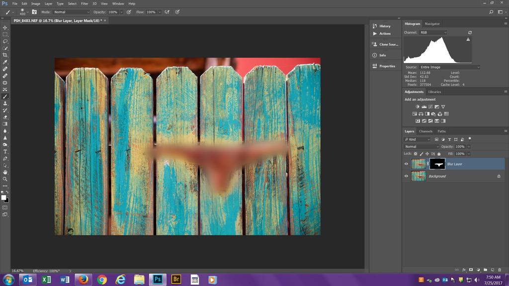

To Mask a G. Blur filter you're going to first duplicate your Background Layer and rename it something like "Blur Layer" (for example). On the Blur Layer you're going to apply your Gaussain Blur from the Filter menu with whatever parameters you want. This of course blurs the entire image but that's what you want. Once you've gotten your Blur on you're going to apply a Layer Mask to the Blur Layer by clicking on the "Add Layer Mask" icon at the bottom of the Layers Panel. The Mask, by default, will be white. At this point you're going to need to make a decision about HOW you're going to mask the G. Blur filter in this particular image because Masks are either White or Black. You've heard the saying, "White reveals and black conceals", right? Well that applies to Masking. A white mask will show your G. Blur filter effect while a black mask will conceal the G. Blur Filter you applied. It applies to the Pen tool as well and the Pen Tool you choose will always be the opposite color of the Layer Mask; so if you're going to use a White Layer Mask you're going to use a Black Pen Tool and vice versa; Black Layer Masks require a White Pen tool.
So, to reiterate, you're going to have to choose between one of two options:
1. Apply a White Layer Mask and use a Black Pen. In this case the White Layer Mask is showing the G. Blur effect (white reveals) and the Black Pen covers it up (black conceals).
2. Apply a Black Layer Mask and use a White Pen. In this case the Black Layer Mask is covering up the G. Blur effect (black conceals) and the White Pen uncovers it (white reveals).​

Using a White Layer Mask and a Black Pen
Black Layer Mask Using a White Pen
