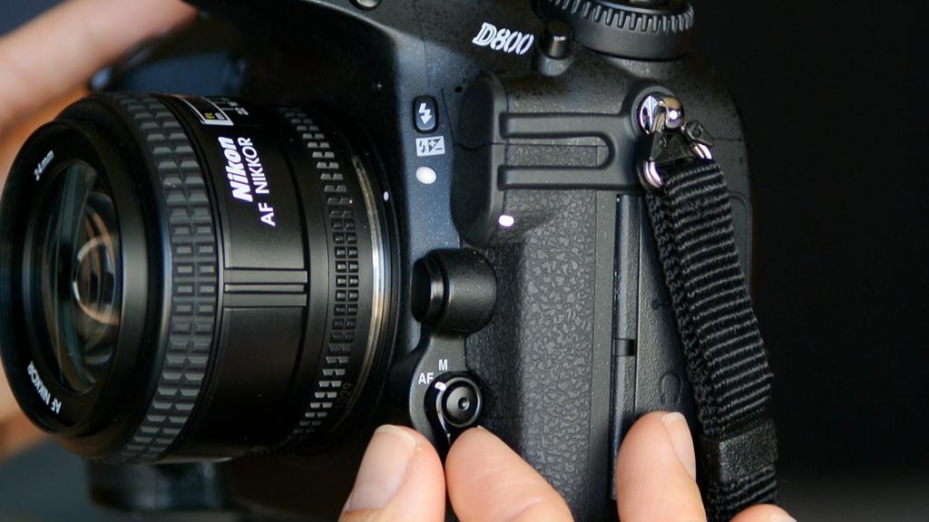

Are you talking about switching from single point focus to using several focus points at once? If so, take a look at the AF-M button. You need to push in the center of the button, and while holding it down, you rotate the front dial to toggle between the various options. If you are in one of the AUTO modes, I'm not sure it will work. If you are in AF-S or AF-C, it should allow you to change the number of points desired. Below is a web photo that shows the button. Press the recessed dot then rotate the sub-command dial (the dial located on the front of the body).

Your camera displays the active focus point but if you want to see all the points being used by the camera in focus modes that use multiple focus points (e.g. D9, D21, etc.), also called the focus point array, press and hold the AF/MF button on the camera body while looking through the viewfinder. You'll see all the points of the focus point array light up for as long as you press the button.
