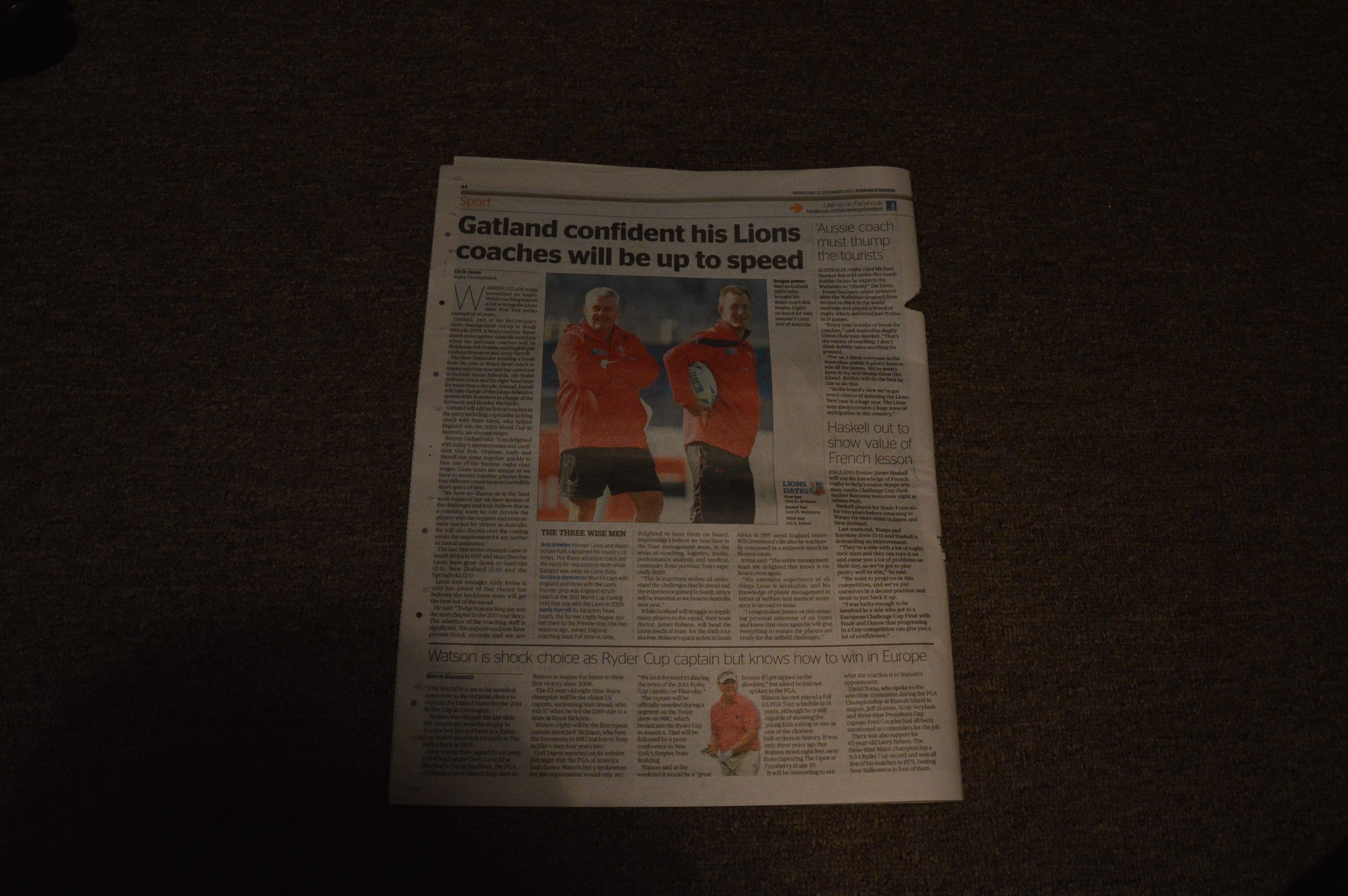

Question:How to take the below staged photo DSC_0282.jpg in low light with low ISO? Is it possible? What am I doing wrong?
Image has exif. The condition is light 2 meters above the newspaper and night time. It is just to illustrate the fact that the image comes dark.The second photo is to illustrate high ISO during daytime /3600/.

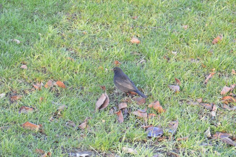

In the bird photo the ISO was set on auto with a limit set to 6400 /which means that the camera will choose the ISO but will not exceed the limit of 6400. For information only the limit can be set to a different setting/. This was because I was testing the camera abilities and wanted to know how it will behave. The noise levels were also good for me. F8 is set because it seems to be the best for this lens /similar opinions can be seen in internet with some people claiming even that F9 is better/. The shutter speed is 1/200 at 3600 ISO, the light was not that bad, I might be wrong but is it possible to go down to ISO 100 with no less than 1/30?
The newspaper photo is in Manual mode with speed set by me as minimum desirable, aperture 8 for the above explained reasons.

It would only be possible to do as you discribed in your initial question with faster glass. With a 1.4, you could shoot that shot at at least 1/60th of a second and be fine. My guess is that you're using the lens that came with your camera? The EXIF data isn't present in the pictures that I can see..
EDIT: I see why. The way they embed on the site, you must first click image to see EXIF.
Here's his settings on the newspaper shot:
Exposure Time1/30
F Numberf / 8
Exposure ProgramManual
ISO Speed Ratings1600
Max Aperture Value3.60
Metering ModePattern
FlashFlash did not fire
Focal Length18mm
Here's your first problem. At f8 in low light conditions, your ISO would have to be up in the higher regions of your camera's capability. If you capped it at 6400, then it may not have enough headroom to take a properly exposed picture. I would have shot that newspaper at near the lowest aperture possible to increase the shutter speed to a desirable amount. See: Aperture Priority Mode
The other thing that happened, is that the ISO of 1600 (combined with your particular lens, anyway) is quite low for this environment. Add to that, the high f number and it's no wonder it is underexposed. If your camera chose this ISO on it's own, that's the second problem. Take it out of AUTO ISO.
am I expecting too much?
No, your camera is simply making the wrong choices! You're not truly shooting manual until you control that third piece of the exposure triangle. ISO.

One more question, why would you be shooting at f8 when there is not enough light?
The ultimate test would be to take a picture in the sunlight, iso 100 and see what the settings would be. Normally, you should get 1/500 @ f-8. If it's very different, then maybe your sensor is defective. This is all I can think of for now.
Hope it helps a little.
eurotrash
Ok, I understand. OP is under the impression that f8 is the sharpest setting for the lens which is why he chose it.
Just as an FYI, the sharpest stop is actually f5.6 or therearound. But I digress.
The point here is, that f8 is absolutely not appropriate for night photography. You'll want to be using lower f stops for lower light conditions as well as a moderate ISO. With that lens, start at your lowest f stop and select and iso of 800, see if that merits you a better image. Don't worry so much about shutter speed when doing night photography, it really doesn't matter too much as long as the other pieces of the exposure triangle are in place.

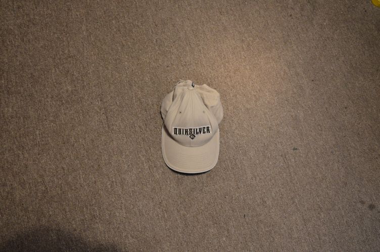

question:how to take the below staged photo dsc_0282.jpg in low light with low iso? Is it possible? What am i doing wrong?
Image has exif. The condition is light 2 meters above the newspaper and night time. It is just to illustrate the fact that the image comes dark.the second photo is to illustrate high iso during daytime /3600/.
I appologise for starting this thread but i was advised to do so because the old thread that i have previously started was closed becouse i have not uploaded any photos in 1 and a half day and or because someone very politely started speaking in capital letters to me but when received the same type of answer /just the word no to be precise/ did't like it and started writing in capitals.
The questions are at the beginning.
if an image is under exposed "like the first" it will have noise...you need to expose the image more or add better lighting....

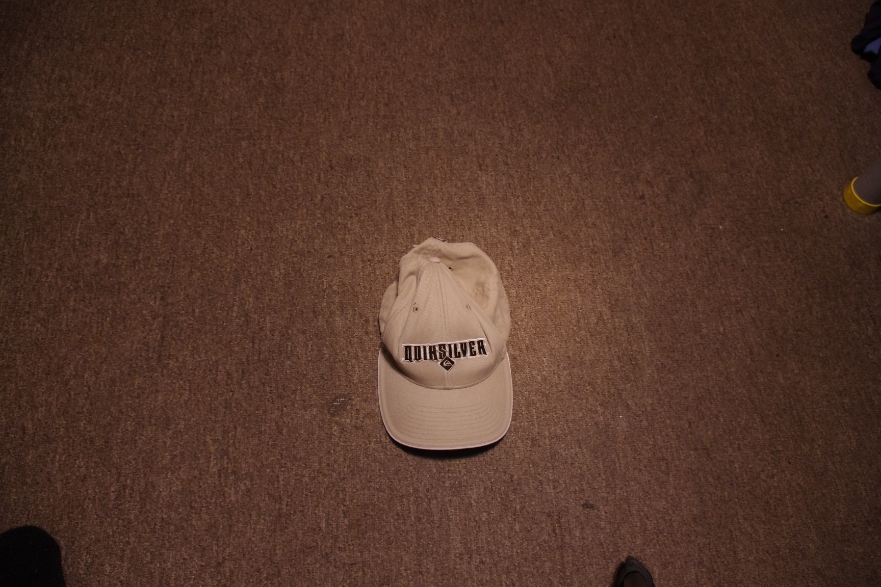

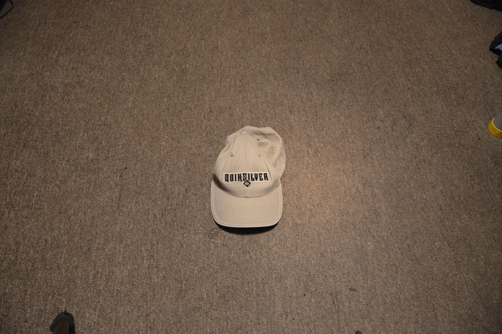

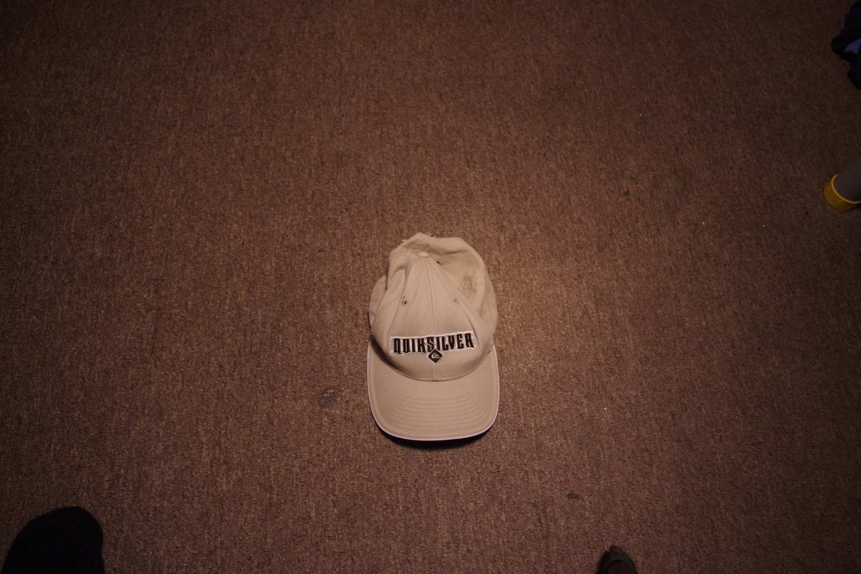

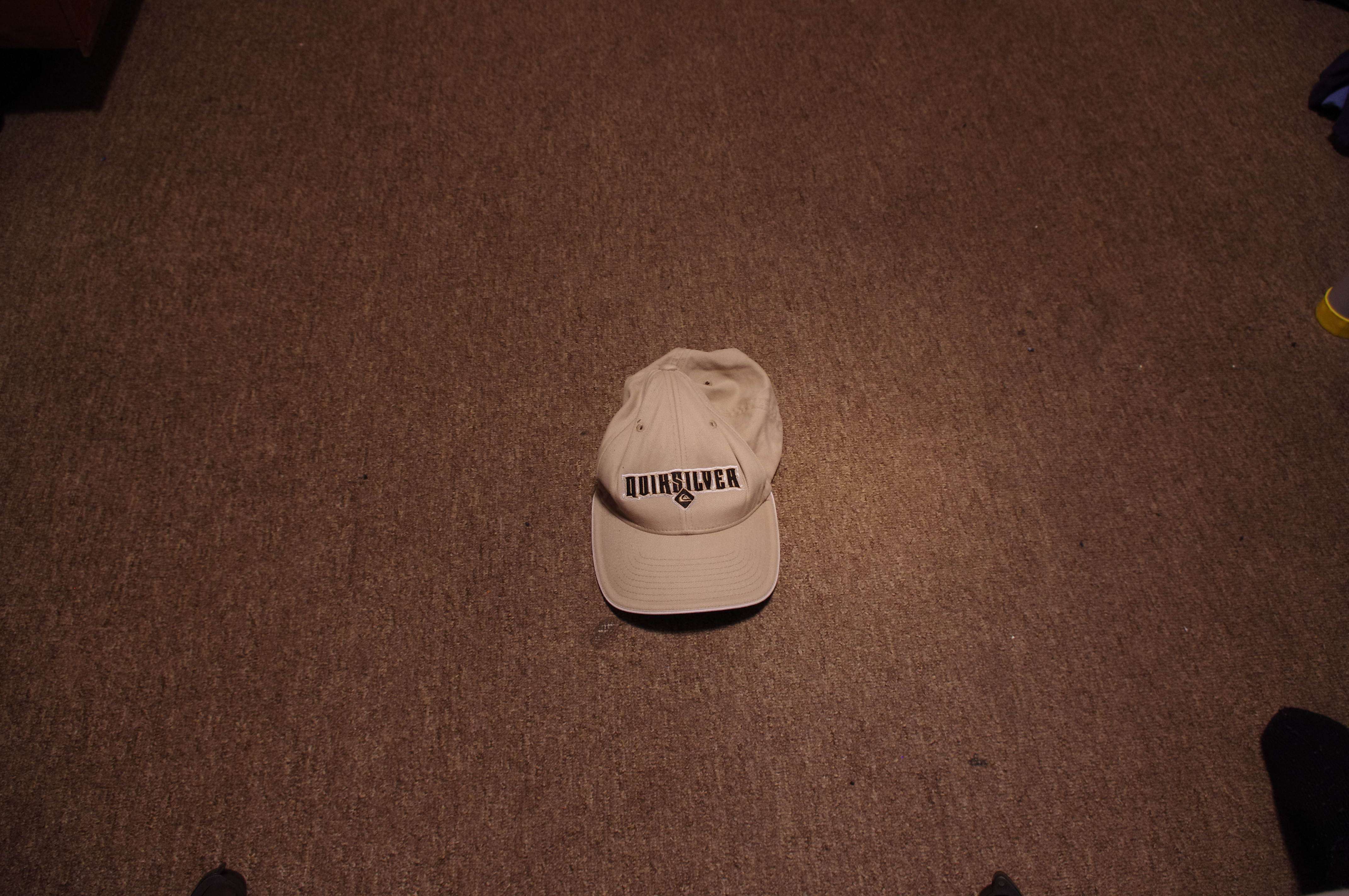

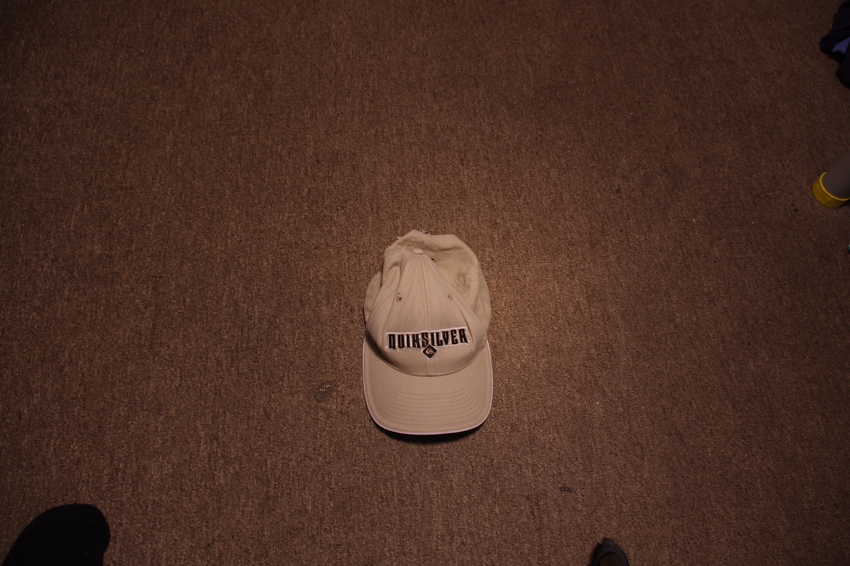

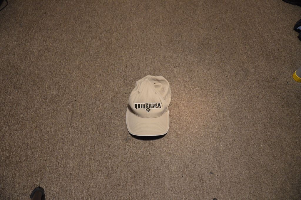

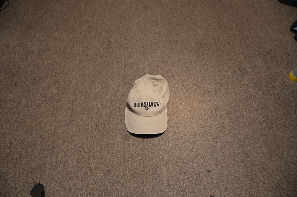

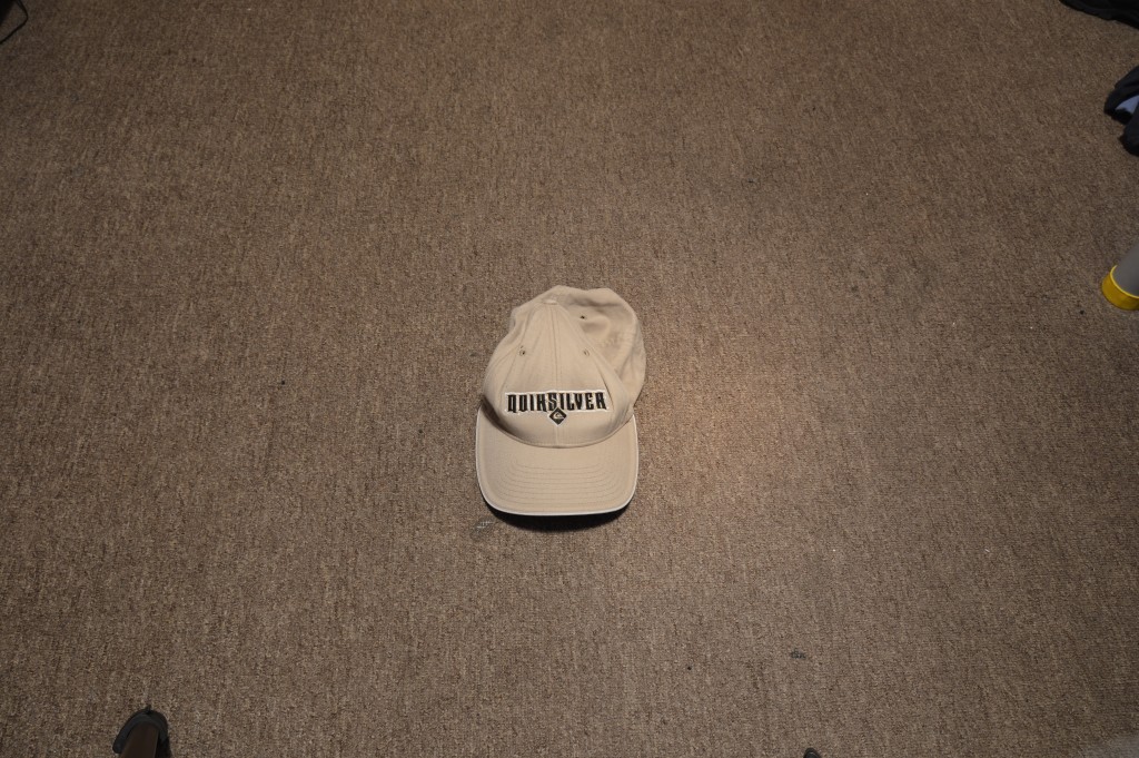

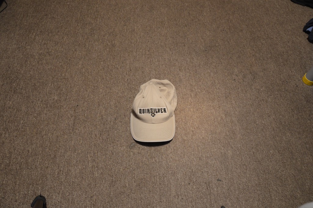

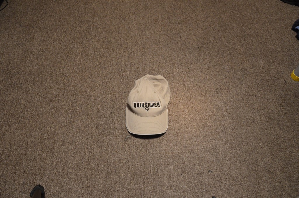

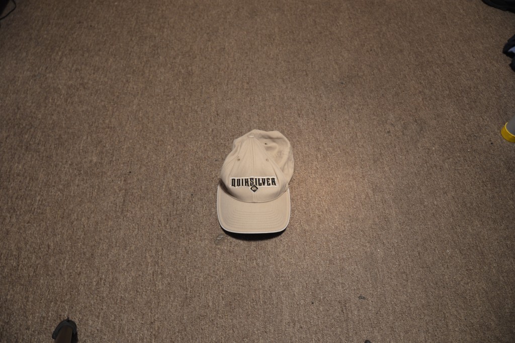

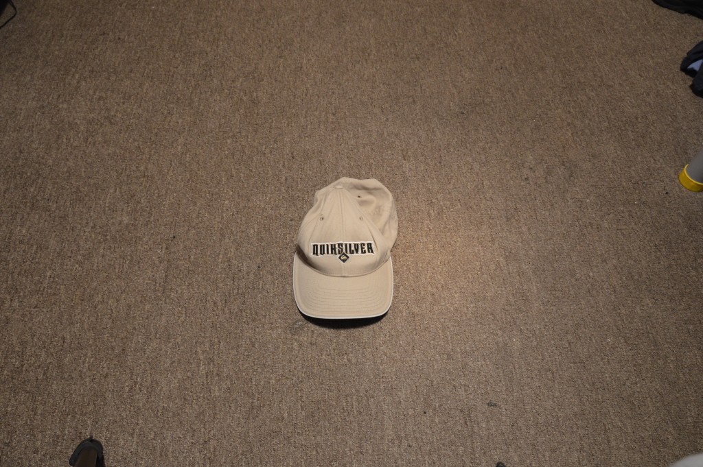

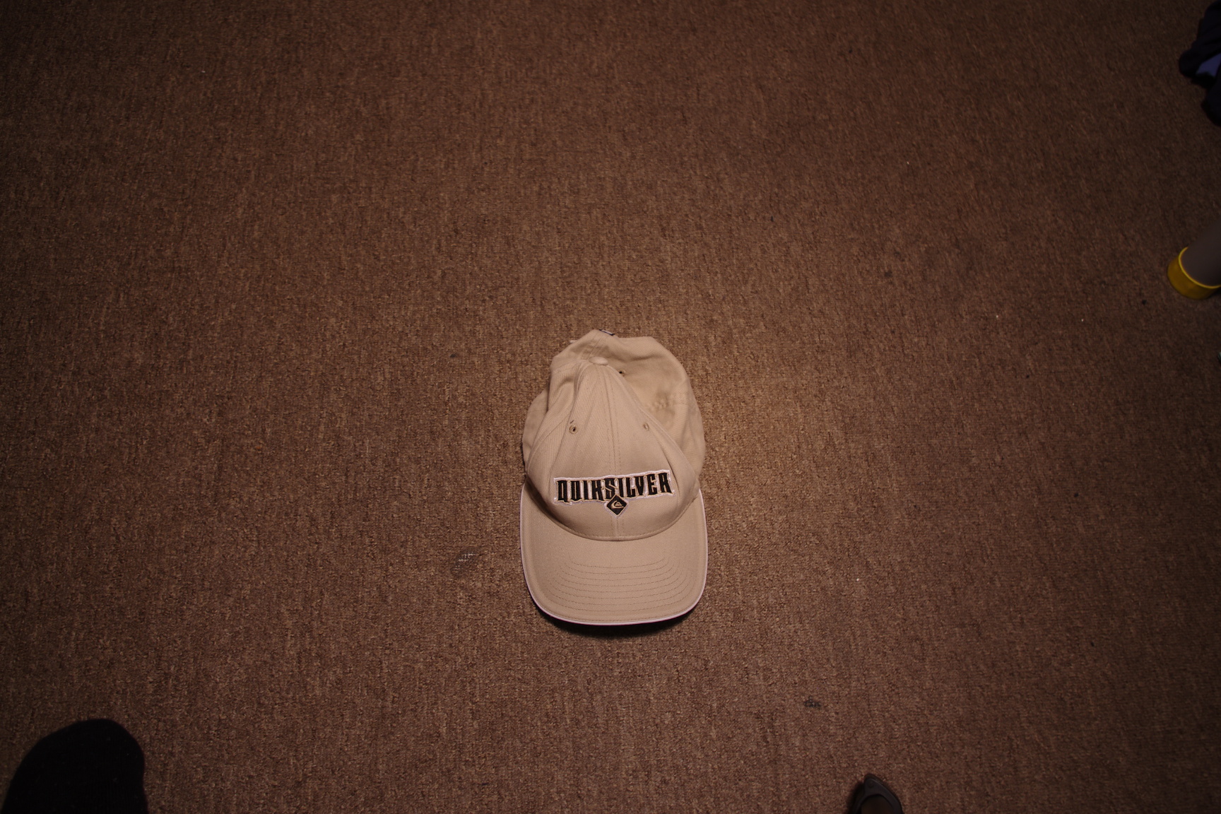

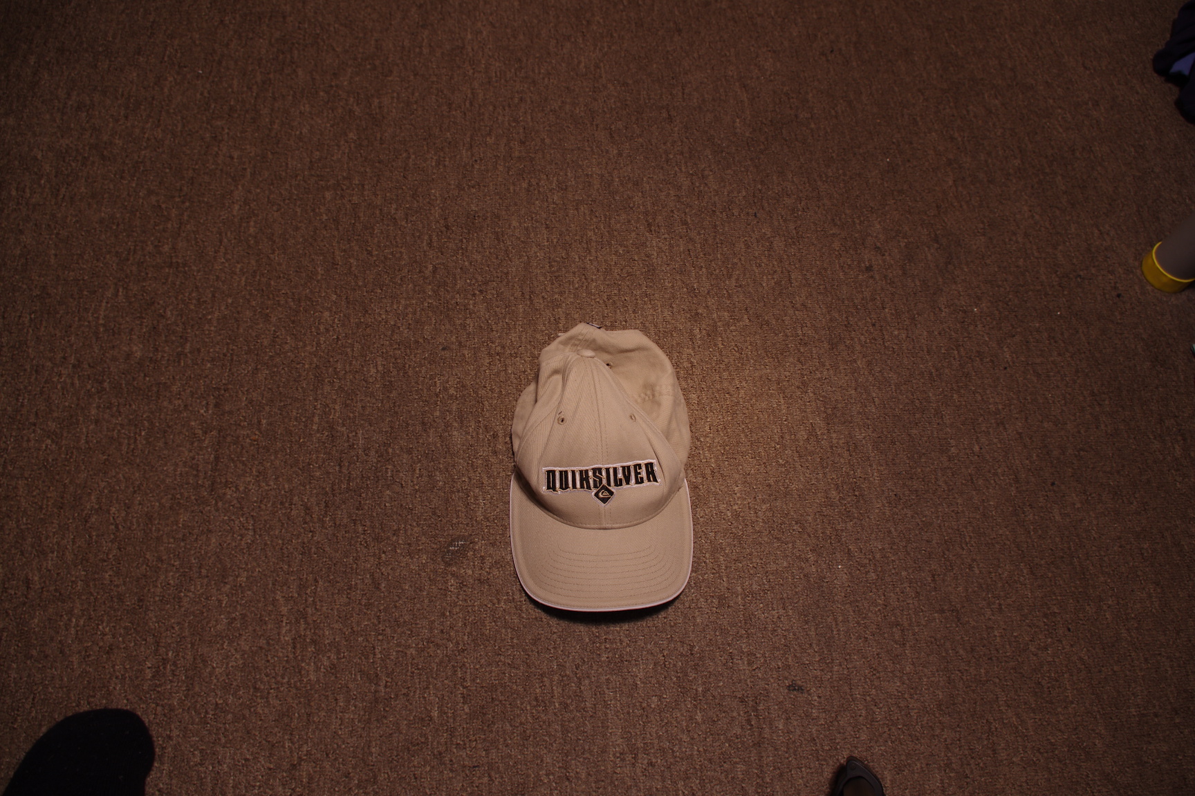

Starting backwards - it was taken in a typical cloudy London day one of many similar that we have here. Sometimes sun shows up from the sky through the clouds and dissapears quickly. That is one of the reasons why I need a camera that can take outdoor photos in cloudy conditions as I take photos mostly outside.
I do not have a light meter but have another digital camera. I have taken the photos and the results are a little bit different. The pictires were taken from a tripod in order to eliminate the human factor. I do not want to be blamed for my opinion you can see the results from the exifs. Below are the images with exif from aperture 3.5 at 100, 800 and 1600 ISO and from aperture 8 at 100, 800 and 1600 ISO from Nikon and the other camera /Please ignore the first photo from the other camera as it doen't have proper EXIF/:

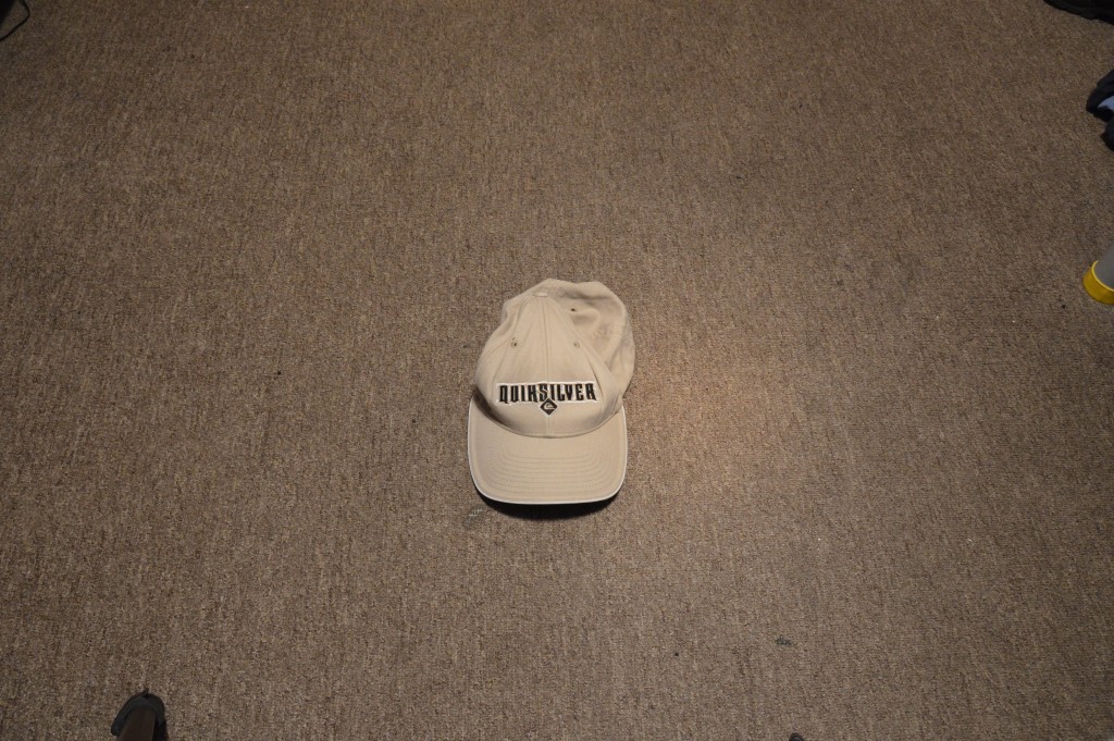

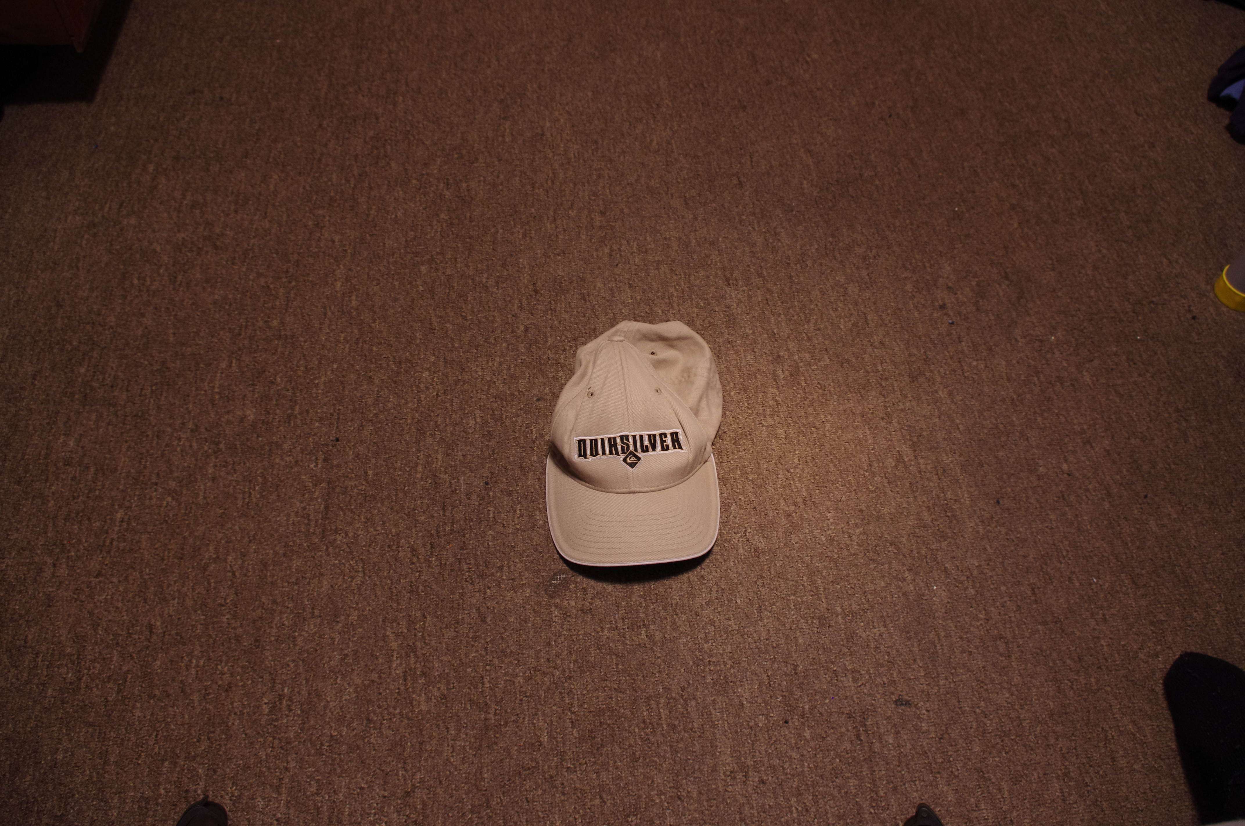

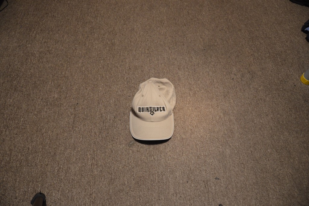

DSC_0290.jpgDSC_0291.jpgDSC_0292.jpgDSC_0293.jpgDSC_0294.jpgDSC_0296.jpgIMGP7286.jpgIMGP7298.JPGIMGP7299.JPGIMGP7300.JPGIMGP7301.JPGIMGP7302.JPGIMGP7303.JPG

I am using F8 because I want prefer wider depth of field. The newspaper photos and the big set of photos is just for illustration of the low speeds. I take photos mostly outdoors.
When there is enought light /I have not had a good opportunity with this camera yet/ I would expect it to perform excellent / it is quite a decent camera for its money and I kind of like the comparatively low noise level that it produces up to ISO 1600 with so many megapixels/ and that is why I am trying to improve low light ISO or to find what is the problem.
I do not have a light meter but have another digital camera. I have taken the photos and the results are a little bit different. The pictires were taken from a tripod in order to eliminate the human factor. I do not want to be blamed for my opinion you can see the results from the exifs. Below are the images with exif from aperture 3.5 at 100, 800 and 1600 ISO and from aperture 8 at 100, 800 and 1600 ISO from Nikon and the other camera:
View attachment 22241View attachment 22242View attachment 22243View attachment 22244View attachment 22245View attachment 22246View attachment 22247View attachment 22248View attachment 22249View attachment 22250View attachment 22251View attachment 22252View attachment 22253
I am really sorry, but there is something that I don't understand. What is your question exactly? I can't see the exposure time for the pentax shots.
What could I do to help you?

I believe that I have a little bit longer exposure with D3200 than with the other camera. The question is what am I doing wrong? Is it that I am expecting something that is not based on a proper conclusion or is it a lens, sensor, settings or something else that causes the difference. Eventually /more theoretically than practically now, but anyway/ will a higher class body like D5100 or D7000 provide faster exposure with this lens?
I have done something wrong with one of the Pentax photos and it doesn't show EXIF data properly. The rest should be OK - exposure time is just below DateTimeOriginal in the EXIF table /but may be on different place depending on the viewer, anyway it should be somewhere in the EXIF as I just checked and I can see it/. If it is still unreadable I can upload them somewhere else because the raw files are around 12 megabytes.
eurotrash
OK, so you've disabled AUTO ISO.
NOW
Go outside, and shoot a picture of a fence/car/something static on a tripod. Use manual mode, and use ISO 800, F3.5 and whatever shutter speed it tells you is correct to make the exposure proper.
THEN
Do the same exact same shot with your Pentax.
Then we can tell if your lens has a problem, or which body has a problem, or if it's operator error.
EDIT: please take a photo not of hats.
pedroj
When comparing you HAVE to use the same aperture and shutter speed settings...With the Nikon you've used F8 and the Pentax F3.5...
