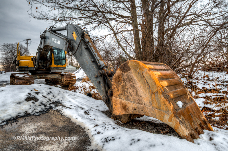

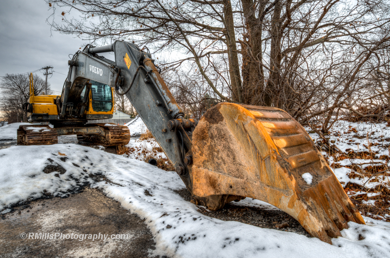

If you are really close to something, you will want to focus on a part close to you. I stick to the 1/3 rule with things a bit further away (say the 12' Jake mentioned). For example, in this shot I focused on the shovel, which was only about 3' away (and actually about 1/3 down from it's tip).
Good to know. Thanks Rick! It is your images such as this one (which I assume was taken with your Nikon 18-35mm) that created such a desire to own a wide angle zoom. It is the perspective distortion that the lens creates when shot at 18mm that I'd like to apply to landscapes--perhaps with rocks or flowers in the foreground leading the eye into the photo. I don't see enough landscapes here that apply this same technique so I watch for any photos you post taken with this perspective. Thanks again! :)
