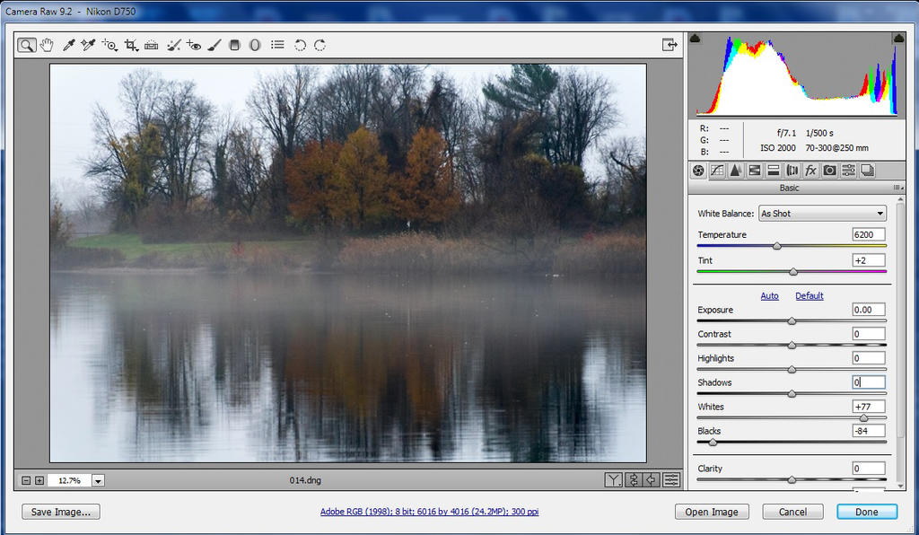

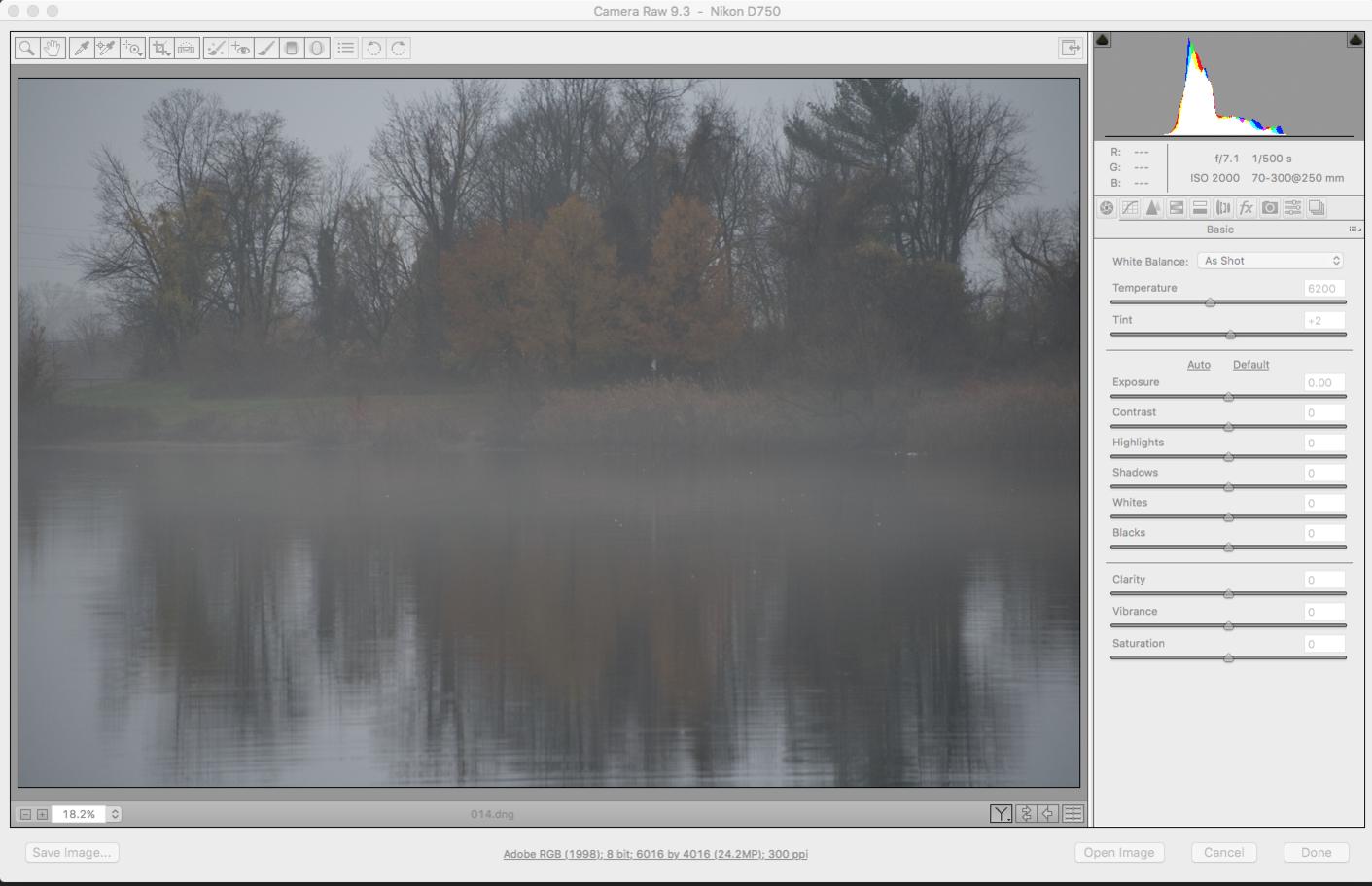

I used Bridge to open the DNG, applied the lens correction, and set the Blacks and Whites. As you can see below, doing so eliminated quite a bit of the fog. So how do you edit fog photos? Do you not set the Blacks and Whites? I'm not familiar with Curves (in case anyone suggests using it). Thanks for any ideas on how to proceed.

Yes, that's what I need to know. I remember Jake (BackdoorHippie) mentioned it is important to set those parameters to have the most data to work with in a file; however, in this case, doing so removes some of the detail I want to retain.
Later today I will start over and see what I can do even if I don't completely adjust the Blacks and Whites. Thanks, Don.

I just downloaded your dmg and loaded it into Photoshop.
The unedited untouched version looks very different to your DNG.
It looks almost exactly like the jpg image you posted initially.

In my original post, I moved the Black and White sliders in Bridge which dramatically altered the DNG, but it's not what I wanted. Did you use LR? If so, I will definitely check out how to add a levels layer as I've not done that in LR or Bridge. Thanks, wornish!
