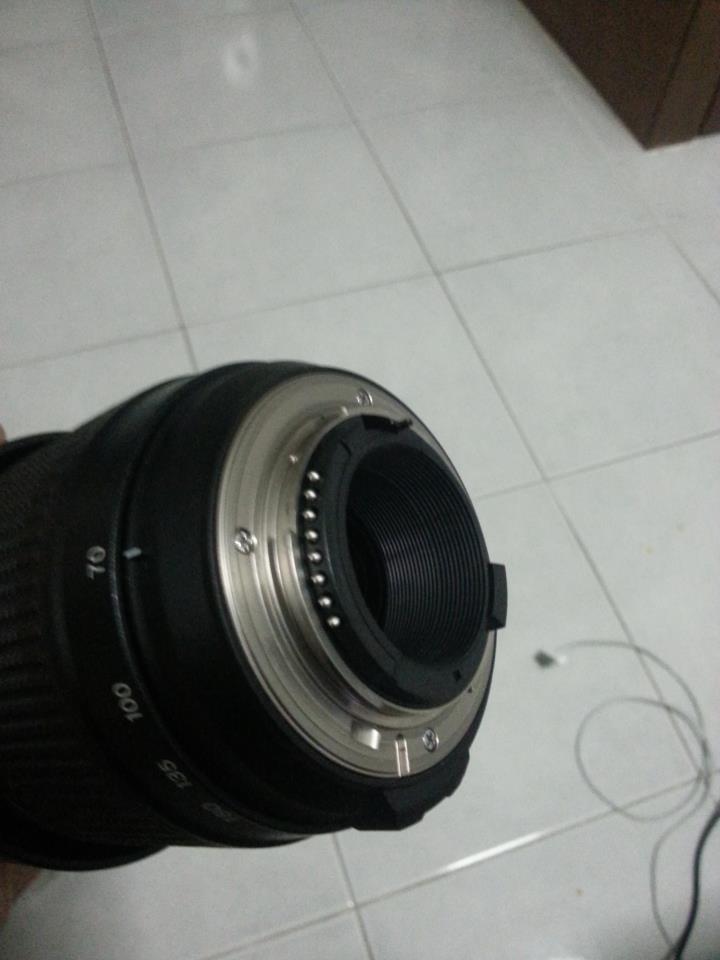

look on the back of the lens .....mount end of the lens ...count the little metal contact pins ...if it only has 5 then it wont work with the 3100 as you have purchased the wrong lens its a worm drive.cam drive lens ...
If its got 6 pins then you have selected something wrong in the menu.( or its faulty)
