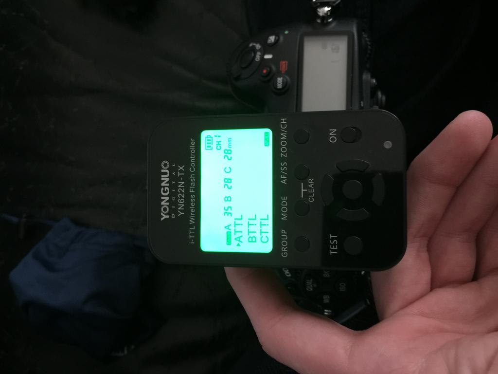

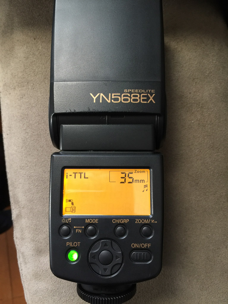

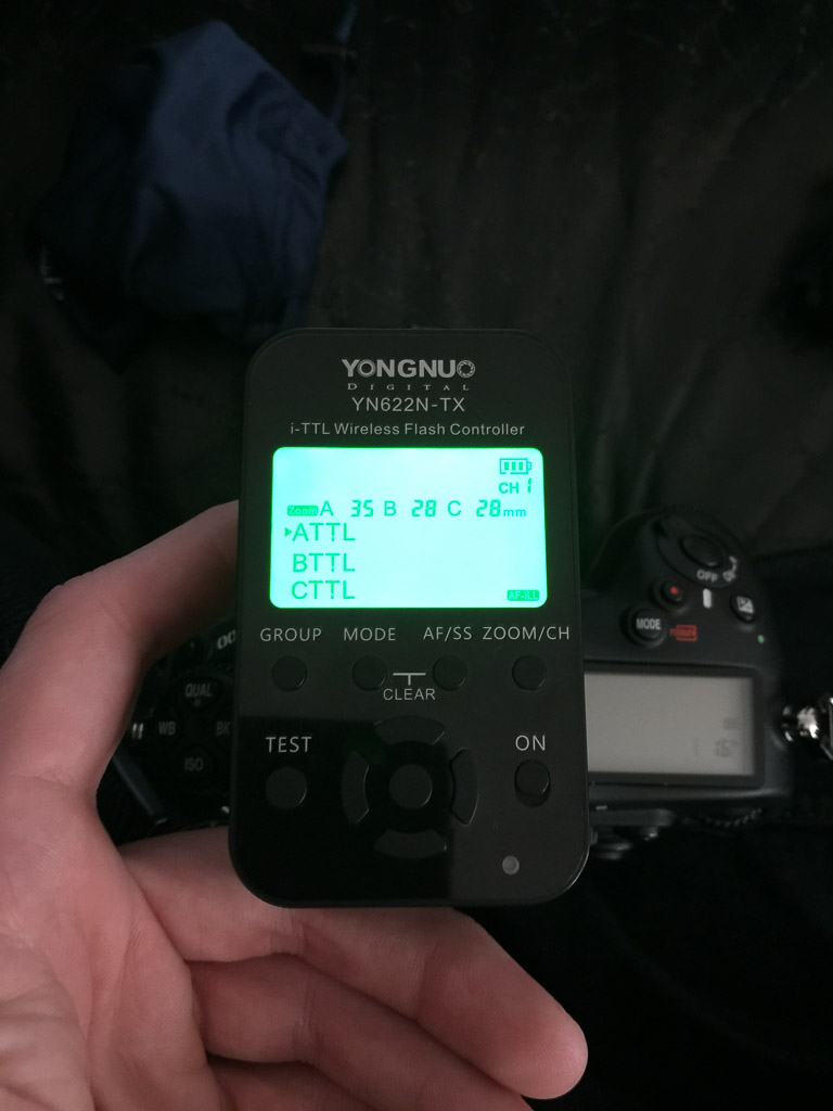

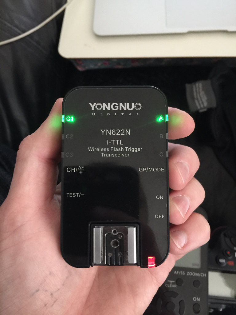

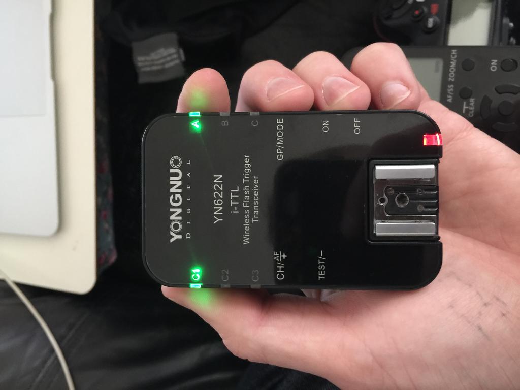

yea I'm using the YN-622 iTTL wirelessly, so my shoe has the transceiver and my flash has the receiver, everything as far as I know is in all TTL, the flash, and the wireless components.
I tried to not mess with too many settings because I don't understand them yet.
So what happens is I get set up, set my flash where I want it, focus and shoot, the flash visually fires early, beeps differently and it'll do it a few times then fire normal.

That seems a pretty good description indeed. :) I am ignorant about the 622, but surely others here have experience with it.

I shot with it today and for some reason it kept going to 14mm focal distance and flashing a "M" manual I assume, but it does not allow me to switch it back to 35mm and when ever its on 14mm it fires early.
It will go back to 35mm on its own, I can't help but feel that it's a battery power issue, it also takes a while to charge between flashes and I burn through new batteries each outting. (200 ish photos)

On a Nikon flash, the 14 mm and the M is because you have the pull-out fold-down diffuser covering the flash head. Put it back to remove the 14 mm and the M. Or the dome on some Nikon flashes. I don't think any of the Yongnuo have the head switches to detect this.
Firing early does not make sense to me, but the flash is much weaker with the 14mm diffuser pulled down. Get up close once to see if it still appears not to work at 14mm. And HSS mode only has about 20% power anyway, you might think that is not working. :)
The M can also be because you manually zoomed the flash away from the automatic lens zoom which it normally follows. See the flash manual about procedure to remove the M, but generally on a Nikon flash, the way is that you manually zoom the flash to the same current value as the lens. On a Yongnuo flash, you manually zoom to the blank position just lower than the 24mm position, which is Auto.
Sorry, I kept drifting off into Nikon mode. :) But basic operation is about the same.

The 14 mm and the M is because you have the pull-out fold-down diffuser covering the flash head. Put it back to remove the 14 mm and the M.
Firing early does not make sense to me, but the flash is much weaker with the 14mm diffuser pulled down. Get up close once to see if it still appears not to work at 14mm. And HSS mode only has about 20% power anyway.
The M can also be because you manually zoomed the flash away from the automatic lens zoom which it normally follows. See the flash manual about procedure to remove the M, but generally, the way is that you manually zoom the flash to the same current value as the lens.
Hey thank you Wayne!!
That solved the 14mm "M" problem!
