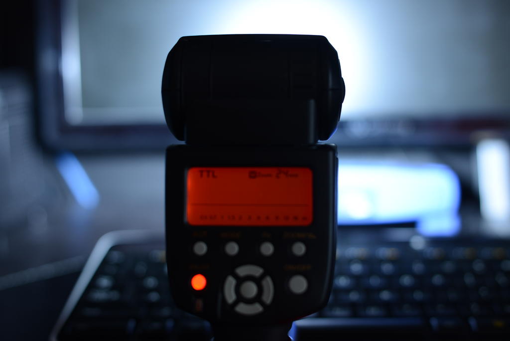

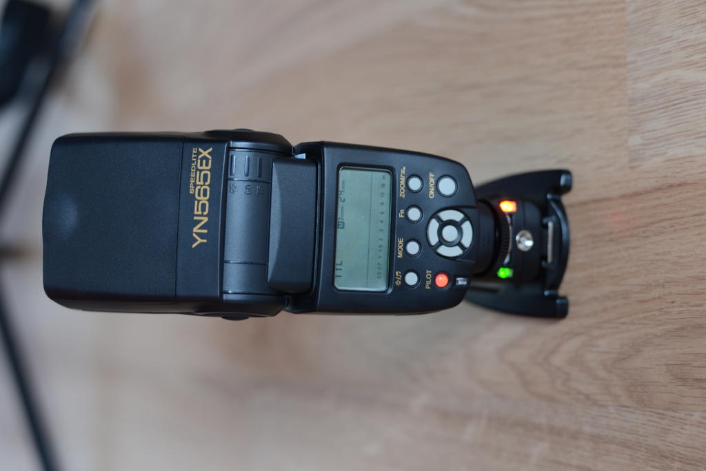

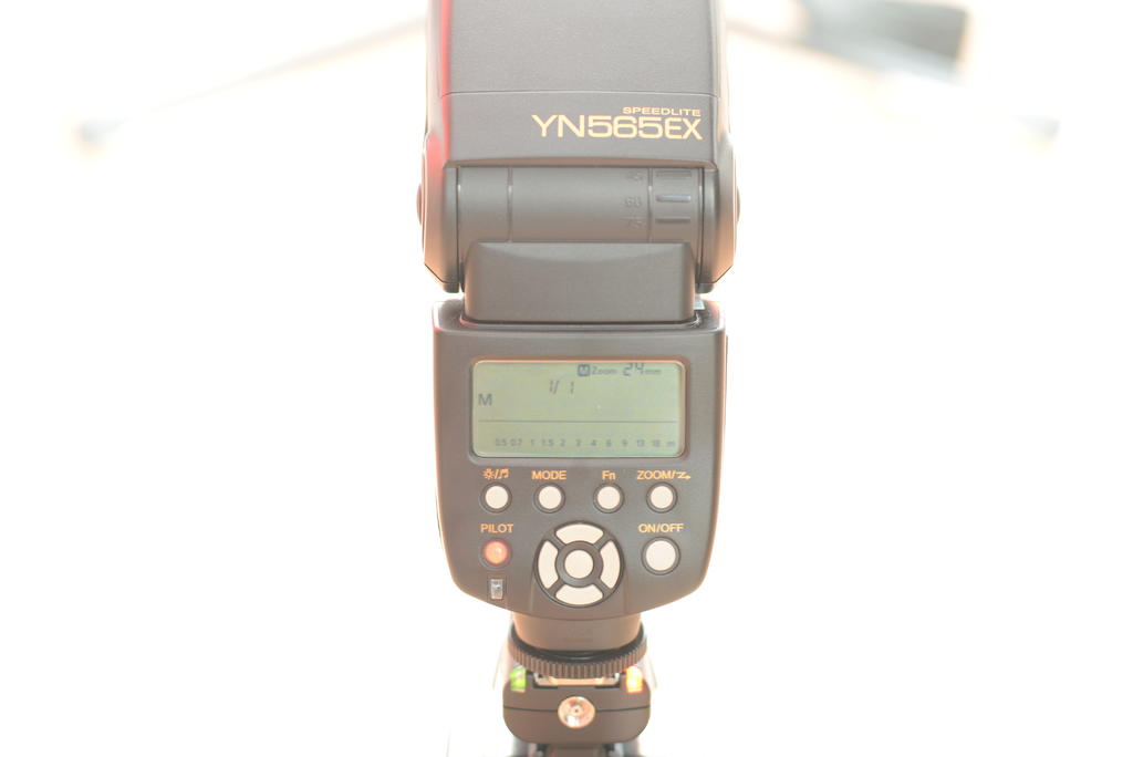

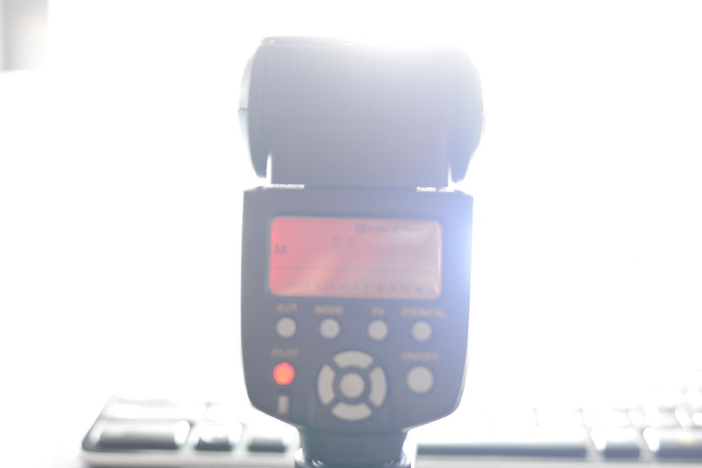

So I picked up a set of these, to use primarily as a remote shutter control. I was curious to see how they would work with my flashes. I was told that they are non TTL, and flash can only be used in M mode. Well, thats not true. I threw them on my 568, and 565, set them to TTL, and they fired, in TTL. I wasn't sure if it was actually getting TTL, so I switched it to M, and got a white image due to the over-powering of the flash. So TTL does work.... You can't control it through the commander mode, but TTL does work for me. Anyone else have experience with these?

hmm. I have the one 603 on the camera, and the other on the 565ex (also tried with 568ex), and had that set to ttl, and the mode set to on camera. (The picture with the flash on the camera), and it worked in TTL and M. I tried both, and the TTL gave me a normal exposure, and tried to M 1/1 and it was blown out. So it def metered something right. Did you have the mode on the flash set to where it thinks it's on the camera? I had slave off on the 565, and the picture of the flash on the camera for the 568. So weird...
Edit- TTL does not work
