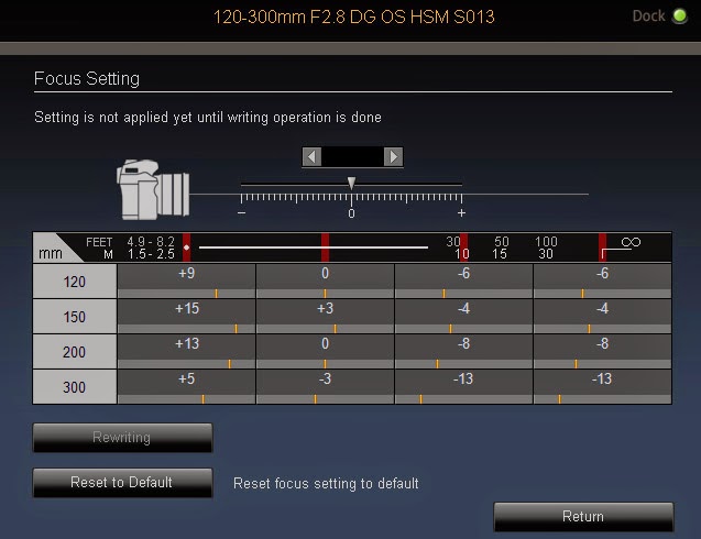

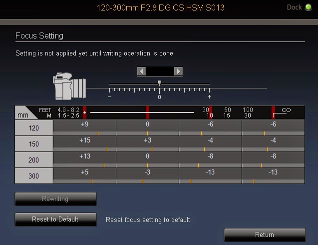

For anyone who might be interested, here are the specifics on the Sigma USB Dock. I've been thinking about getting one for a while as my list of compatible Sigma lenses continues to grow.
To give you an idea of what it's capable of, here's a screenshot from Sigma's Optimization Pro software from a blog my brother did about the Sigma 120-300mm and some issues he had with it focusing on his Canon 1D Mark IV (feel free to read the entire thing if you're into the details of focus calibration - he uses the Reiken FoCal software Don mentioned).
It not only tunes at different focal lengths but allows you to calibrate at different focal distances within each focal length.
10 Gauge
That's pretty darn amazing stuff. This ability needs to be built in to the dang body!! Can't imagine how long it would take to tune each lens at every possible focal length / distance. But, it'd be so worth it.

And you know, I have to give kudos to Sigma: not only are they turning out some of the best glass on the planet, they put out things like the USB Dock which, to my knowledge anyway, is unique. And lets think about this... Four different focus ranges for a prime lens and, and for zooms, you get the same but also at four different focal lengths?!! Holy cow... Personally I'm glad it was Sigma that did this and NOT Nikon because if Nikon HAD done this, they would not have done it this well. The Sigma dock is so simple, so elegant and the solution is, as far as I can tell, perfect.

Problematic at the body level because you need the lens firmware to adapt and they're not all going to support that. Plus now your body, which can currently only store 1 fine tune setting for 10 lenses (I think that's the number) needs to store 16 per zoom lens and 4 per prime. Stick it in the lens and it doesn't matter what body you put it on. Kudos to Sigma.
