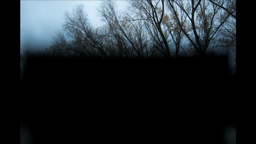

Whats wrong with DSLR Nikon camera D800

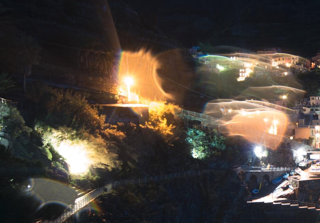

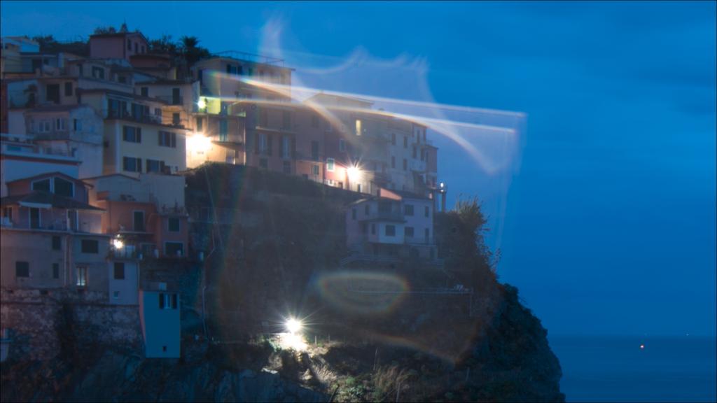

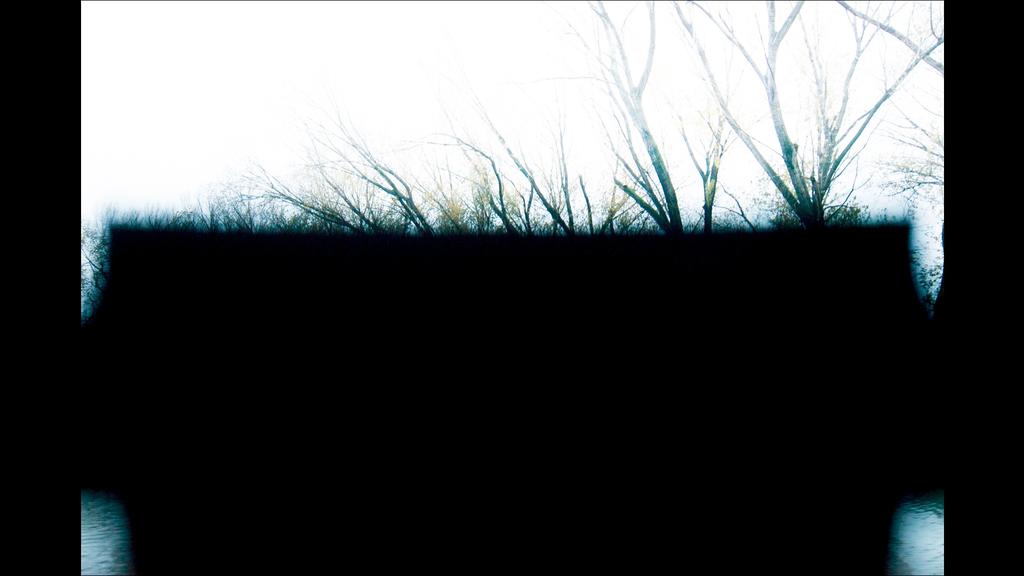

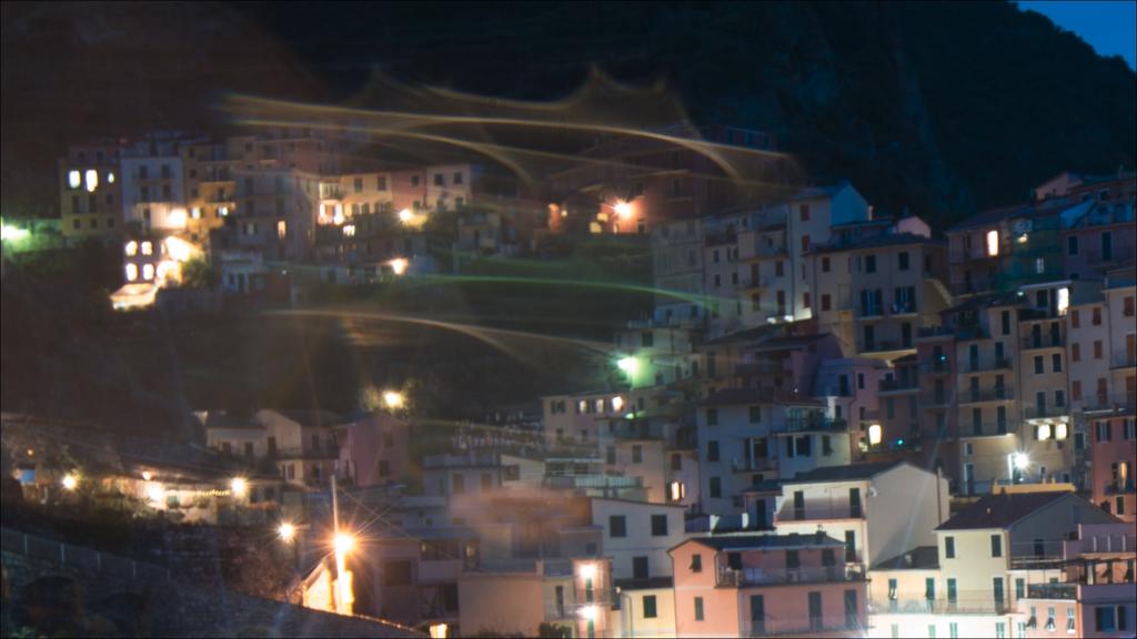

Pictures are edited - On the original of the files, the white area is covered with a photo.
With which part is a problem please?
(mirror or the mechanism that drives it mirror (tilts it) or D800 Shutter Assembly Unit (or Shutter Blade Curtain or another part)) ?
Whats-wrong-with-this-DSLR-camera-03.jpg Whats-wrong-with-this-DSLR-camera-05.jpg Whats-wrong-with-this-DSLR-camera-07.jpg Whats-wrong-with-this-DSLR-camera-08.jpg

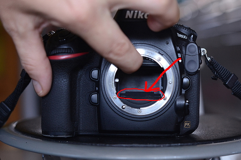

Try taking the lens off and looking at the mirror/sensor while firing a shot. See what's blocking the sensor. Also, trying using a really long shutter speed (over 1 second) to see if anything is in the way.

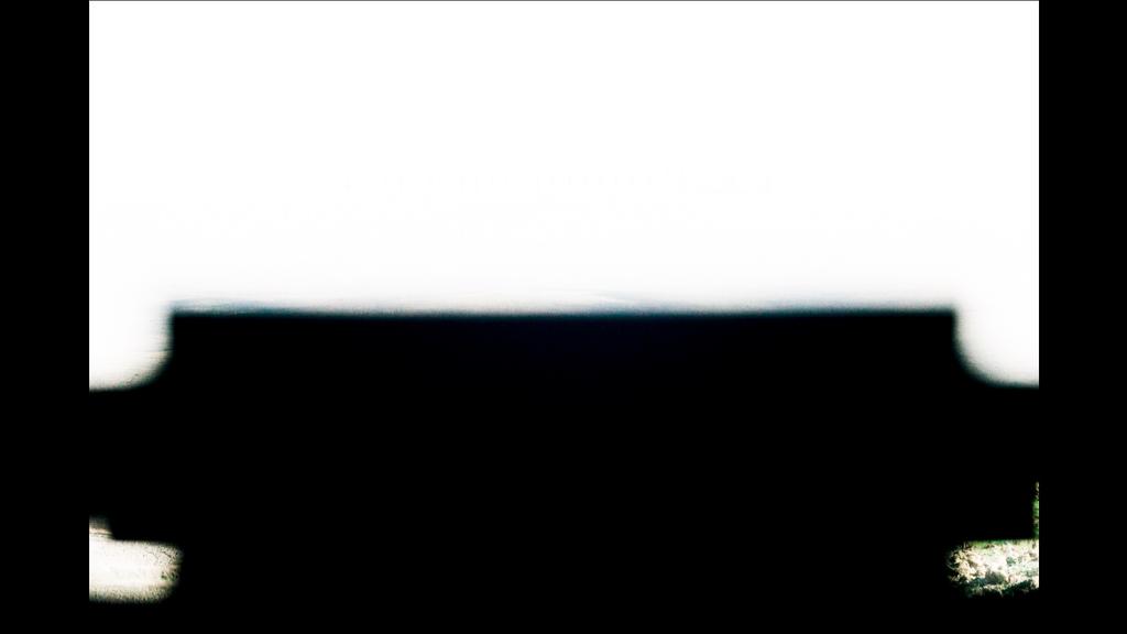

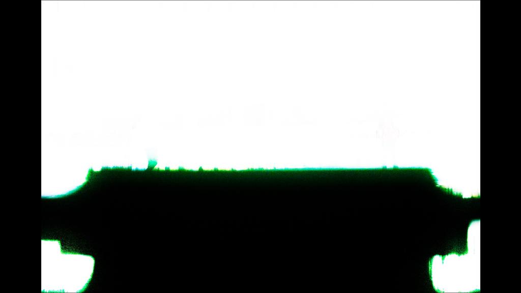

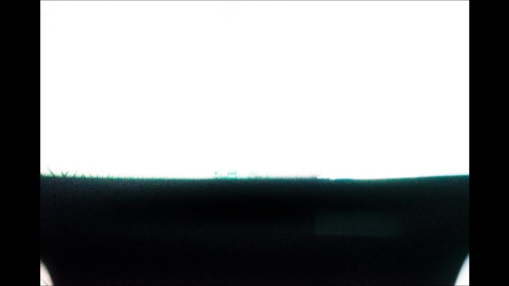

four more croped photos from the same camera Nikon D800
long exposure (5 - 20 second)
but later on another long exposure looks ok

The image that hits your sensor is inverted, which means the part that is blocked is actually near the top of the camera. That's consistent with a mirror that is not going up all the way. If I were you, I would take off the lens and manually lift the mirror up and see if anything is blocking it or slowing it down. Otherwise, it has to go to service.
Blade Canyon
Hey, you might try setting your D800 to the Mirror-Up setting for photographs. It's on the top left wheel, last option. (MuP). You have to hit the shutter button twice... first time lifts the mirror, second time snaps the shutter. If your mirror is just a little slow, then this would give the mirror time to get all the way up before you take the shot. This would definitely not work for fast action sports, kids, etc., but it would still allow you to use your camera today while you decide what to do with it.
palocx
thanks for your support!
I checked camera with mirror up (MuP) and mirror is not UP :mad:
mirror usualy stop about 2-3 mm before up :mad:
