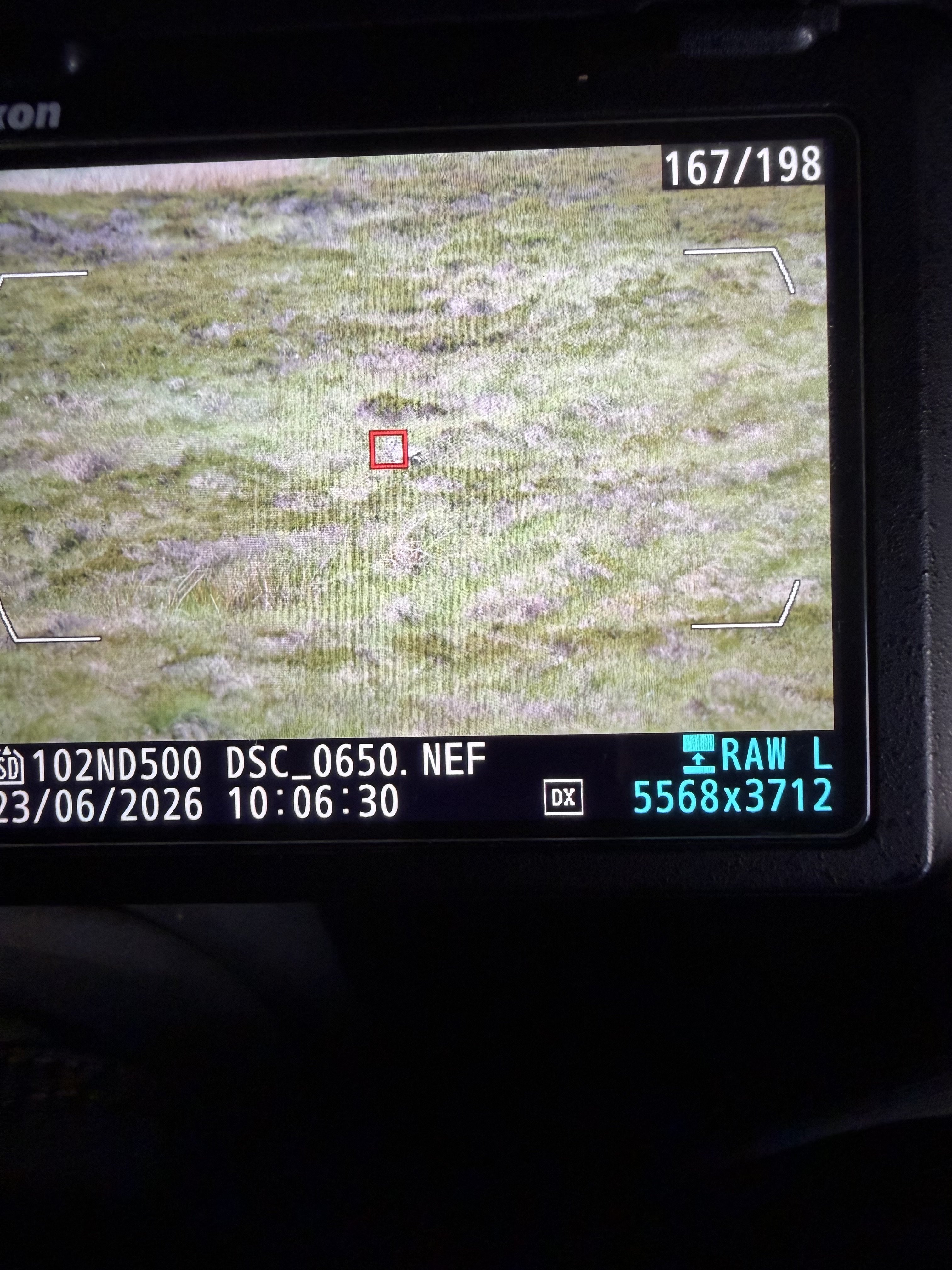

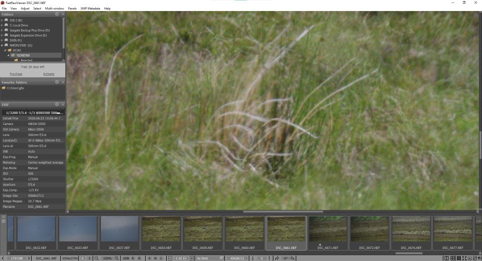

Thanks Hark - that is very useful. I’m not sure if this was the problem in this case as I have looked back at the images on the camera and it shows the focal point on the owl (see image below) - however it is an important point. I had af-c set on ‘release’ and I can see release + focus or focus+release may be better options as you suggest .
Yep. I found this out the hard way! ;)
