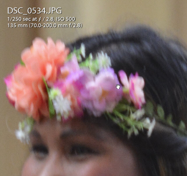

The setting show up there. I used my new d7100, no flash. I had VR off on my 70-200 nikon lens. Hand held. The focus point was on her. Most of my picture are like this even with 1/250. 2016-09-17_23-22-14.jpg

Camera shake most likely. VR off means that the lens wasn't helping you. 1/250 while doable more than likely needs the help of the VR. That lens is pretty heavy and fatigue and stress of "getting the shot" could have introduced some shake.

Don't disagree with the VR recommendation.
As for the focus point does your processing software allow you to see it after the fact? If not turn it on in camera just one more avenue of useful feedback. Have found that the focus point was not were intended for various reasons.

Another question. Is this a cropped view or is this the full photo from the camera? It does look like some motion blur. Overcome that by faster shutter speed, VR on or as a last resort (actually probably a first resort) use a tripod.

Although a tripod is "cumbersome" assuming this is outdoors, and like others said this is a heavy lens plus if you have a battery grip attached. One thing that could help is a monopod and if you have a tripod look at quick release systems that can be mounted. I have two tripods and a monopod and all have the same quick release systems; which I have used in church during wedding ceremonies. The monopod would relieve the weight.
You are at the long end of the lens at 135 and movement can detract the image.

So what I get from this ... It was taken indoors as she was coming down the aisle (I get that from the ISO being high) ?
Now at 2.8 you need to be SO quick in getting that shot as if she is moving your focal plane is moving all the time.
Can we have the full photo and not just part of it? It may be that it is a useable shot within the story of the day but it just isnt tack sharp.
As others have said unless you are on a tripod never turn your VR off, we have come to rely on it, especially when we have such heavy lenses :)
