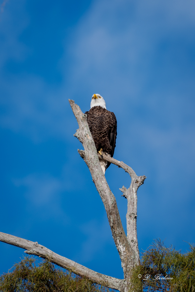

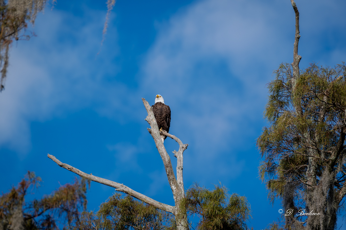

A high resolution sensor helps, as well. At 46 MP, I can substantially crop the image and still have 20+ MP. This is an image I took over the weekend. I was unable to get any closer to the bird without a helicopter. I shot it at 500mm and then cropped it. The first one is the full image, and the second was cropped. I lost approximately half of the image area. This smaller image still has plenty of resolution and is roughly the same as taking the image with a 24 MP sensor without cropping.
