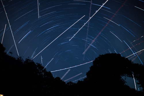

I tried shooting star trails but the results are not what I expected, Looking for feedback on what’s wrong. I took 160 shots of 20 second exposure at 2.8 and iso 400 with a 25 second intervalometer setting. I then post edited in Lightroom and then combined the images using Star Stax. I used a D850 with a Rokinon 14mm manual lens.

I have never tried star trails, but I would say you recorded a lot of airplane traffic during your exposure

Yes, it was rush hour in the northern skies with the airplane traffic. Aside from that, it seems to me that the star trails should be more defined indicating a focusing issue. I’ve tried calibrating the lens focus but I get the same results.

It was definitely a busy night for Air Traffic Control!

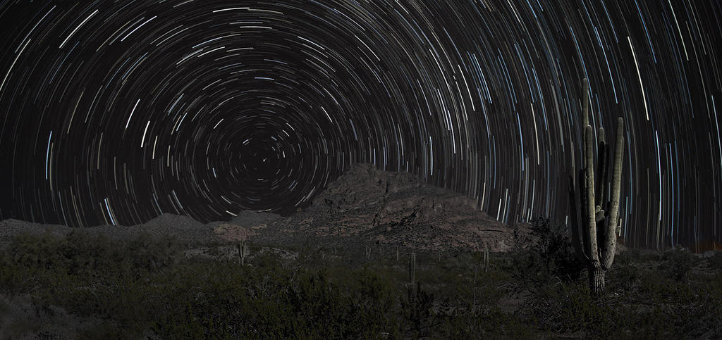

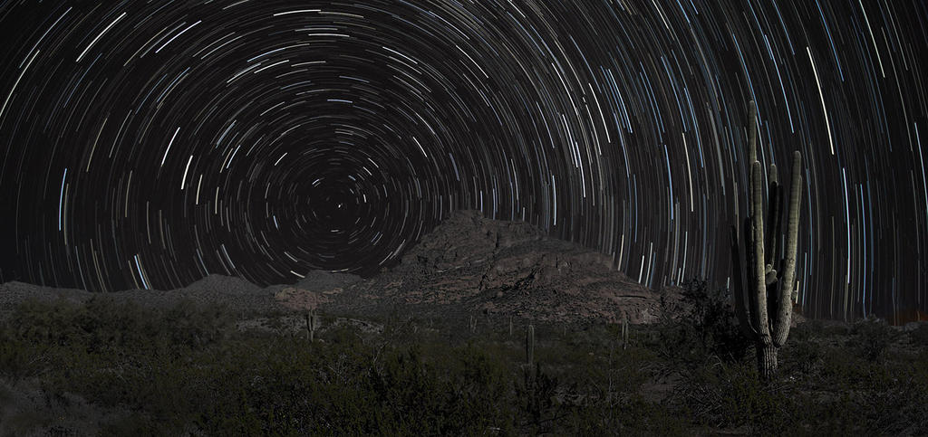

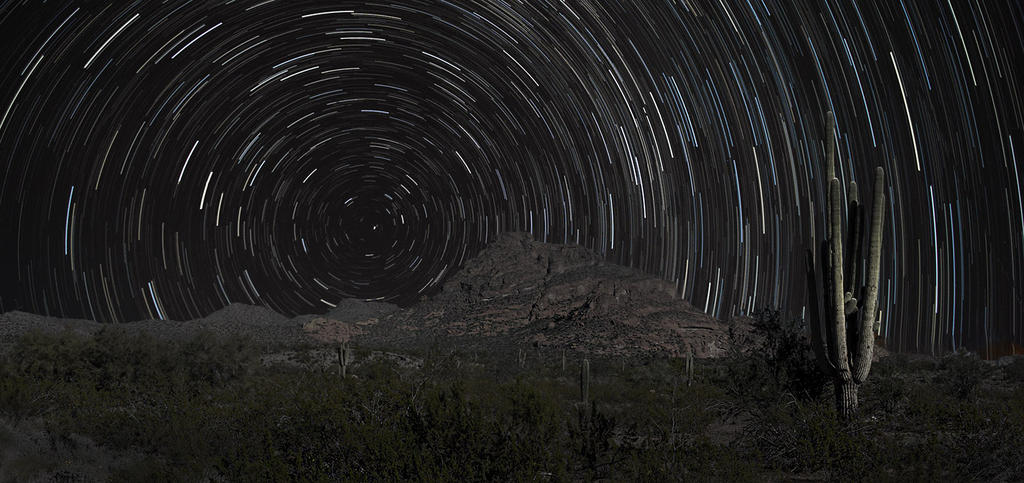

Star trails are a load of fun to shoot and Star Stax is a very easy to use program. I took this outside of Phoenix, AZ with the D700 and 18mm f/3.5 AIS. I think there were about 75 exposures total.

That looks good! That’s the kind of results I’m looking for. You’ve given me another idea, I’m going to try switching to my Nikon 28-300mm lens and see if the results are any different.

I really don't know why the star trails were so weak in yours. Perhaps you could try to bring them up in Lightroom and then re-stack them.

there is a program for star trails that can eliminate aircraft and such like to give just the trails, it also allows you to pick a foreground from your images

The exposures were about 30 sec long, ISO 1250 and f/11. I used StarStax software (it is freeware) to stack them together.
