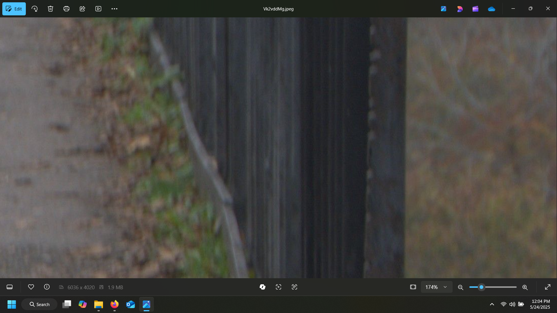

First of all, your post-processing is stripping off the EXIF information. I do not see any of your camera settings, and also important I do not see the focus point used. The photo is also heavily compressed so that hurts seeing what is sharp and what is not.
So with that, I pixel-peeped the best I can and here is where I think the focal plane is set at.
You may be focused well behind the boat. There is motion from the boat and the walkers on the path that cannot be compensated for with VR. The fence rails appear to show a very narrow depth of field that spans the front rails and goes out of focus more deeper into the photo, which is most of the photo. Since the photo has so much compression, I cannot judge the sharpness fairly. But I don't think there is much camera shake showing in that front set of rails.

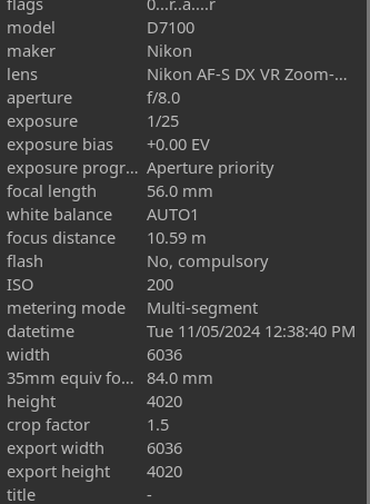

From his NEF file.

@Needa , ah, it was 1/25th, not 1/125th. That would explain the camera shake. But isn’t that where VR would kick in?
@BF Hammer , having determined the shutter speed was 1/25th that would explain the shaky image. I turned quickly and just shot with minimal composure.
