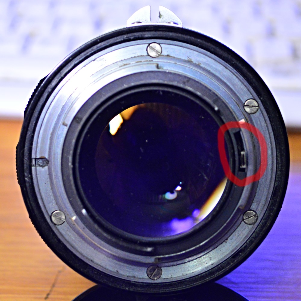

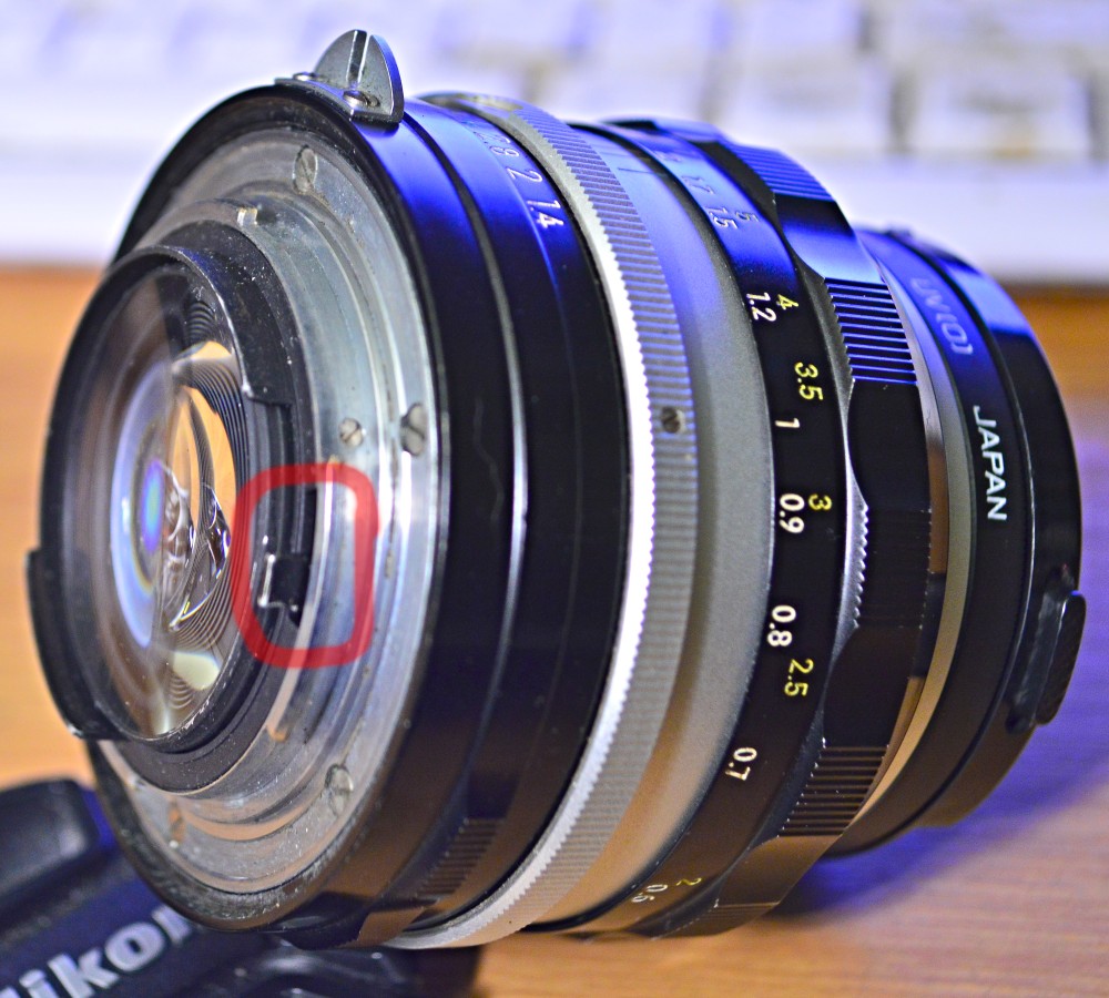

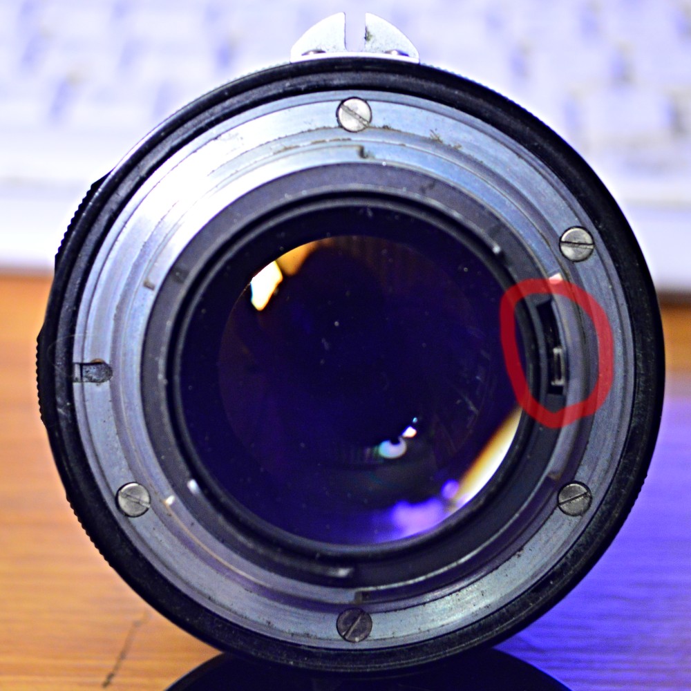

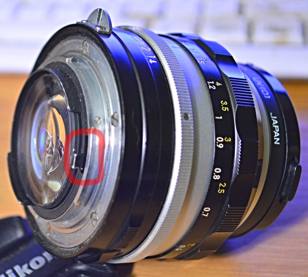

<blockquote data-quote="aroy" data-source="post: 574781" data-attributes="member: 16090"><p>To check if the lens is defective</p><p>. Switch the camera off</p><p>. Take the lens out</p><p>. Now look through the view finder</p><p>If it is bright, then the lens is the problem</p><p></p><p>In case the aperture does not move when the aperture tab is moved, then the lens mechanism may be jammed if the tab also does not move or broken if it moves.</p><p></p><p>Try and find a 35mm F1.8G DX or a 50mm F1.8G. Both sell between $150 and $200 each. Try and locate a camera repair shop (most major cities in the world have one) and they may have either of these lenses.</p></blockquote><p></p>
[QUOTE="aroy, post: 574781, member: 16090"] To check if the lens is defective . Switch the camera off . Take the lens out . Now look through the view finder If it is bright, then the lens is the problem In case the aperture does not move when the aperture tab is moved, then the lens mechanism may be jammed if the tab also does not move or broken if it moves. Try and find a 35mm F1.8G DX or a 50mm F1.8G. Both sell between $150 and $200 each. Try and locate a camera repair shop (most major cities in the world have one) and they may have either of these lenses. [/QUOTE]
