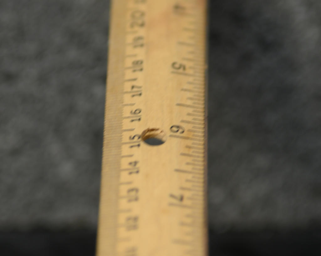

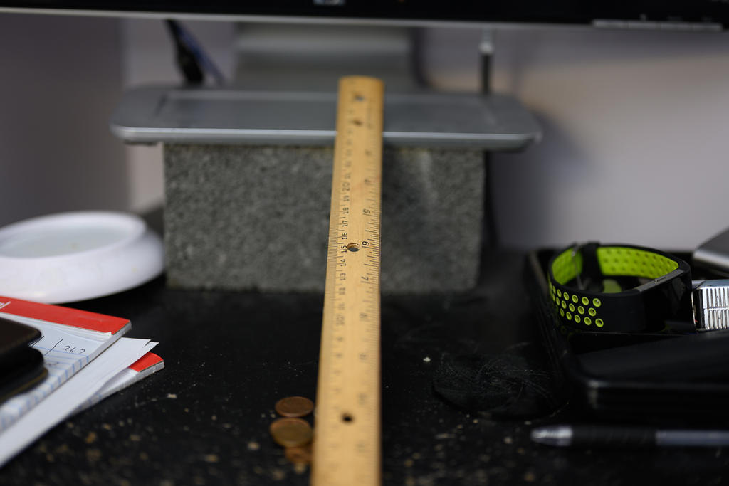

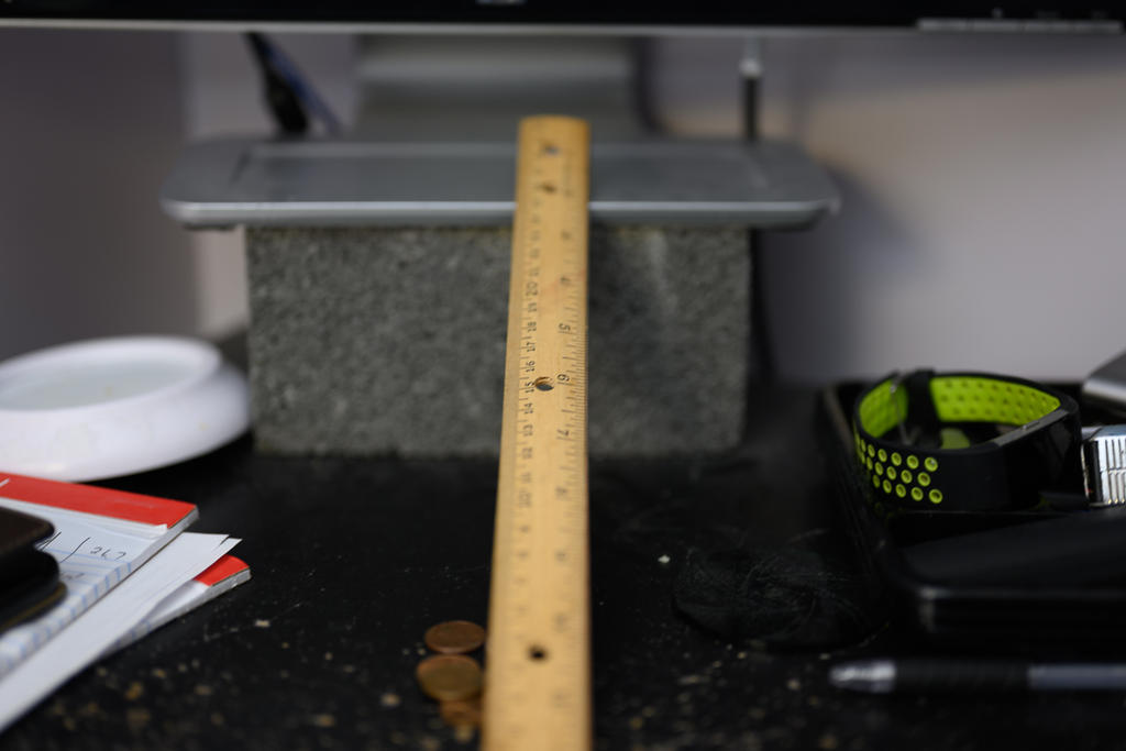

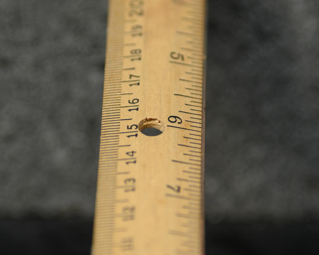

Below is a casual IBIS test conducted on my messy desk. Both exposures are 1/2 second, the first is one shot with IBIS on (only one taken) and the second is the best of 15 subsequent shots with IBIS off. I shot with IBIS off 15 times to try and get the best I could accomplish hand held. steadier hands might do better, but that would be true of both. The first 2 are the originals downsized, the second are extreme crops (200+ %ish), no editing beyond the crops. The lens is the Nikon Z 50mm 1.8s, pinpoint focus point which I tried to keep in the circle of the 6.
On
Off
On
Off (best of 15 continuous shots)
Despite being unscientific, it is the reality of what I can expect when shooting.
Danno_RIP
That looks pretty good to me given that you will be rarely shooting at that shutter speed. You have a steadier hand than I do but that IBIS still locks it down.
