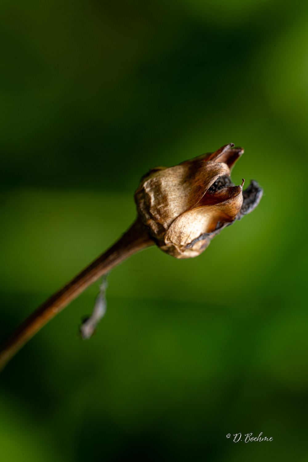

FYI, here are a few I shot this afternoon. All were taken directly to LR, auto settings applied with some minor exposure, texture and vignetting applied. No cropping was done. These are not intended as good images, just test shots to explore TTL. I'm not sure how much difference the camera makes in this, but I was using my new Z7ii. The first (poor results) TTL I tried a year ago were with my Z5.
This first one was the one that was off the most. My guess is that it was perhaps a stop to a stop and half overexposed.

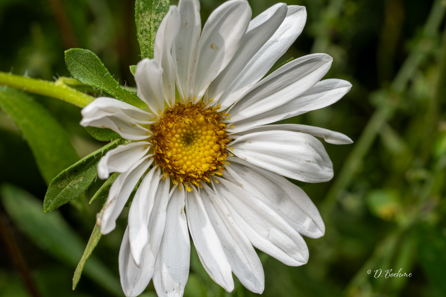

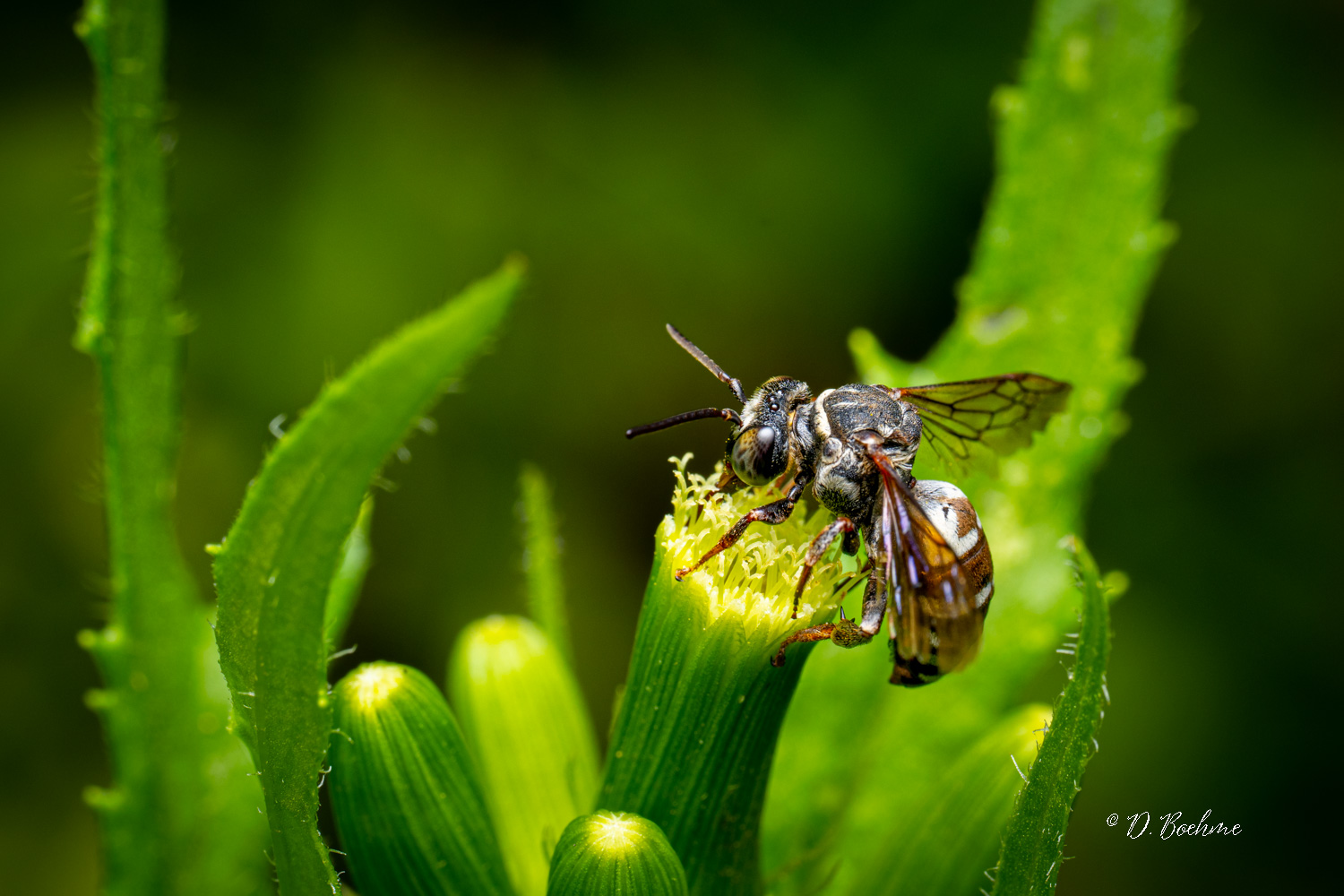

These last two are the most telling to me. I would assume a small subject with a lot of distance to background would be the most prone to overexposure. They weren't.
This surprised me the most. I thought a white flower would raise havoc. It nailed it. I usually have to dial down the flash power when going from something like the purple flower above to a white flower.

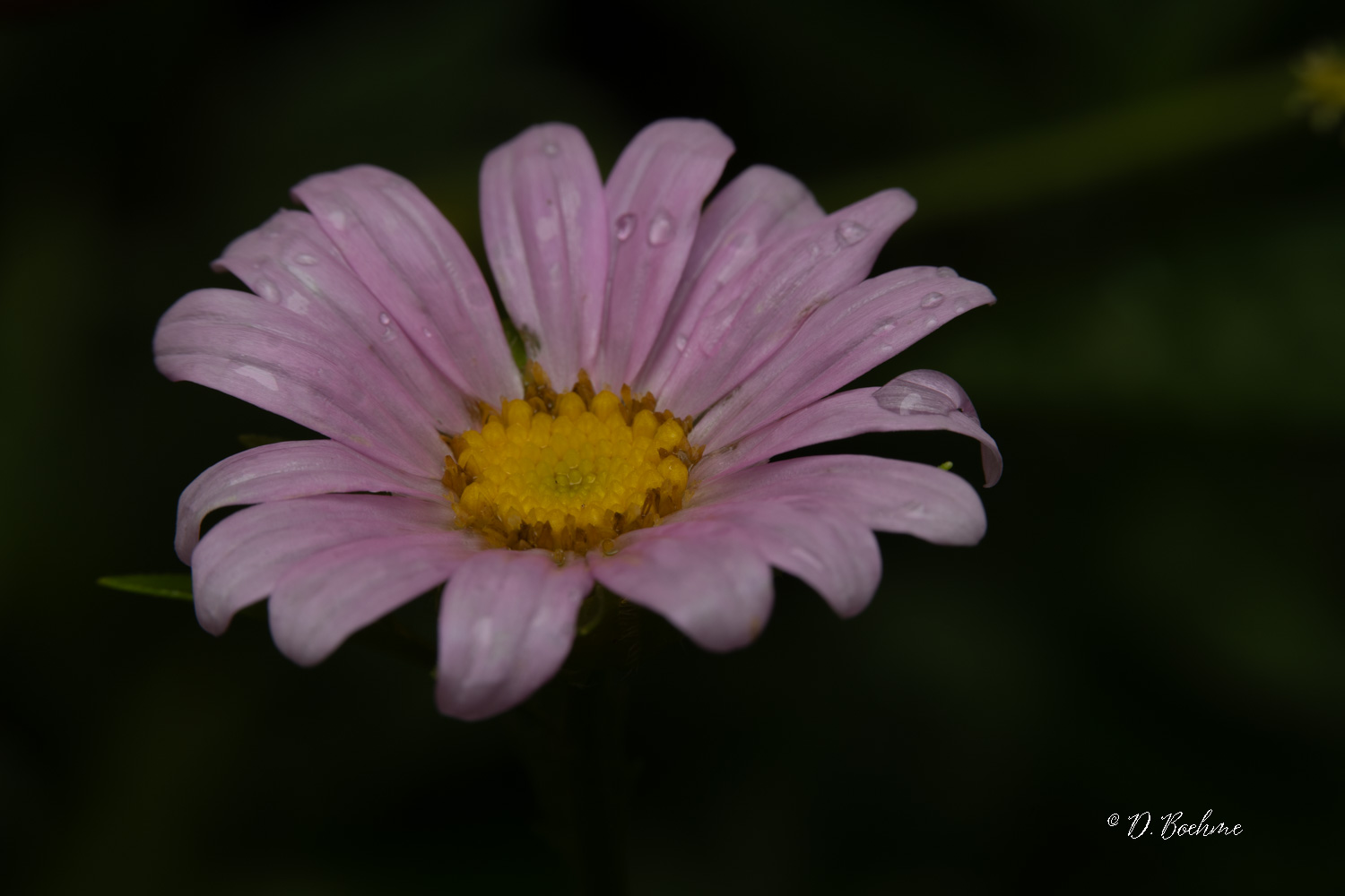

Here are a few for comparison. I took a few quick shots this morning. I took a couple on manual until I got close to what I wanted judging by the image on the backscreen. I also took one with TTL setting. The manual settings were anywhere from 1/2 power to 1/8 power. I will add that, if necessary, I could use exposure compensation to fine tune the TTL exposure, if I felt it was off by a consistent amount.
In each set, the first was taken in manual mode and the second TTL. I imported them to LR and exported them to JPG format without any editing.

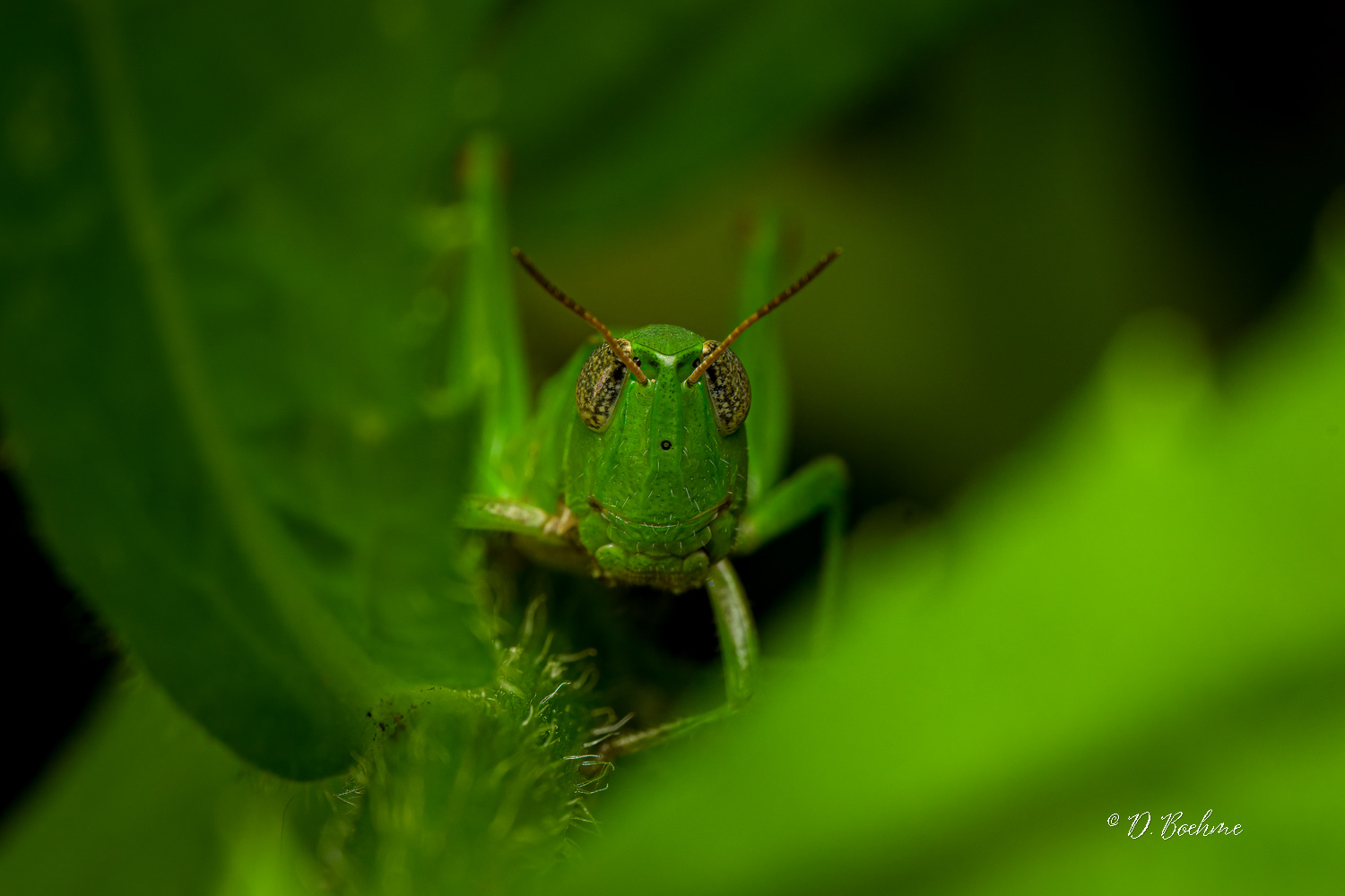

OK, I'm now up for the Dummy of the Week award. I discovered this afternoon that somehow my flash was in an exposure compensation mode. I've not used the flash in TTL except for the one shoot when I first got it, until a couple days ago. I wasn't really paying attention to all the information on the screen of the flash, or bother to read the instruction manual on TTL. It was only for a -1/3 of a stop, but after resetting it to 0, things look better. Here is one of a handful I shot a few moments ago to test it out. This image was converted to a smaller JPG without any editing. It is still a tad on the dark side, as were the others, but it is pretty close to ideal IMO. I discovered if you put a TTL exposure compensation value in the flash, it stays. Even if you turn the flash off, it still remains when you fire it back up. Flash exposure compensation goes away when you turn the camera off, unless you safe the settings to one of the "user defined modes". Something to consider, if I feel that it needs some constant compensation. Judging by what I see from these handful, I think it is close enough.
Here is the same image, cropped and edited, with no Topaz help.
And another a little closer up. Boy these guys really love the thistles. Those are volunteer, and not part of the wildflower seed mix I planted. Since the plot and a little bit of ground around the plot don't get mowed, there are some volunteer plants coming up. These have turned out to be a real magnet for pollinators. I've also noticed that some insects only feed on certain flowers. The bumblebees love the sweet basil flowers (which are almost gone). They don't seem much interested in the other flowers in the plot.

The last one is nice. I wonder if you change the aperture from f16 to f22, will it still work with the lighting situation and make a deeper DOF (maybe to cover the wings)?

Yes, I could use F22, and often do. It will increase DOF a little, in this case, probably not enough to get the wings in focus. The downsides are it requires more power from the flash, increasing recycle time and flashes per battery charge. The other issue is diffusion. I notice sharpness starts to fall off above F16. Most "gurus" recommend not shooting smaller than F11 for maximum sharpness. I'm sure that some lenses control it better than others. I need to set up a stable subject and shoot a series and compare them under magnification. I tried it this afternoon with a flower, but the wind interfered with the results. I could tell that F32 was definitely suffering from diffusion.
