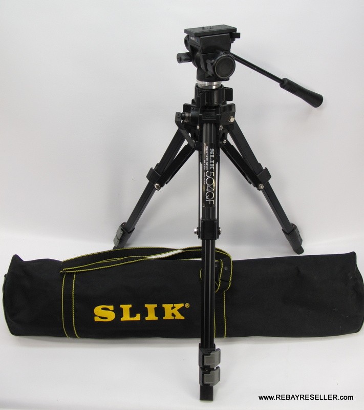

I bought a slik 504QF tripod 60" with a rating for 11lbs, and so far it works good. :) I got it used for $45.00 so I guess it would be considered a cheapo. Lol :)
Photo was not made by me, but was used in the listing I bought my tripod from.
