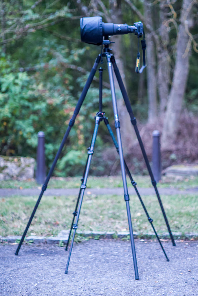

So I`m up for a new tripod, tired of the go Gitzo messages (similar to Canon is the best) my conclusions:
Use: 600mm f4 lens + ...
Specs: Carbon (dampening), light weight (to 3,5 kg = 7,5 lbs), high reach (180 cm = 70 in), no centre column (portability), taking 18kg = 35lbs (safety margin is big), 3-4 sections (to be portable but stable).
Manfrotto: I have a 055CXPro4, it works but then my 500mm has not foot anymore (manfrotto 290 does not cut it), I do not want a second 055 for portability reasons with centre column.
I`m tempted by a 536 video tripod, but would like a really flat converter for the half ball connection, which seems an issue.
Gitzo: would have to go for a 4542LS, seems expensive and too low (61 in). Gitzo GT4552GTS seems to convene, then I found: The Systematic Series 4 gives solid support and torsion rigidity and is available in 3- or 4- section models, so I'm excluding 5 sections in general since less sections probably is better.
Really Right Stuff: 44, this is good hight, I believe it has a half ball connector and calling it expensive is an underestimate. I fear support in Europe.
Induro GIT404XL, seems the cheapest, you can get 10 years warranty, did not find it in Europe though.
So I end up with a Sirui (Chinese indeed) R-5214xl from a trusted dealer with long guarantee. High, heavy duty, but only found one review (positive of wildlife photographer) and Gitzo priced.
Rollei T-63 C, Benro TMA48CXL and Bilora PP-324A seems very close, but 5 sections and/or centre column and/or Aluminium.
Conclusions:
- cheap does not work (a second hand 055 at 50 EUR might do though), but from 600 EUR to 1400 EUR I do believe the differences are minimal.
- the big brands have their issues as well (gitzo looses feet, went for weight loss and lost on vibration suppression, ... many complaints about support)
- an outsider with support from a trusted dealer might be the best choice
- almost nobody seems to hold these monsters to test
