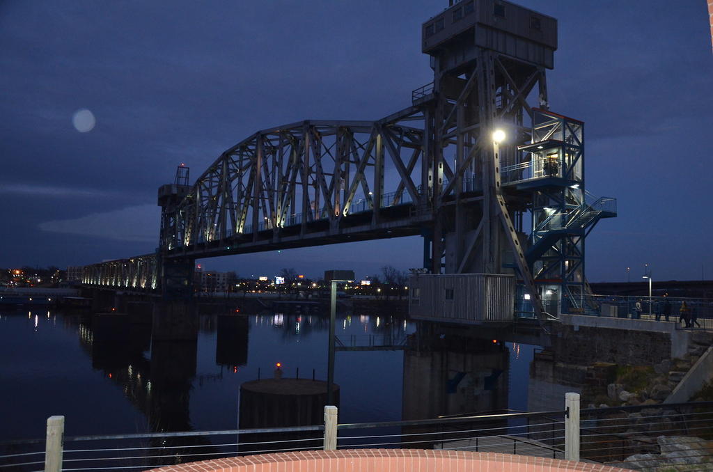

Hello everyone. I'm just starting to experiment with "real" cameras. By that I mean, cameras that don't serve dual purpose as a phone and internet provider.
Got my Nikon D5100 and my lens is Nikon Zoom-Nikkor 18-105mm. Took it out to shoot some photo's for the first time today.
I don't know what I'm doing. In several of the shots a faded white spot appears. It's never in the same place, and the intensity varies.
In the attached photo it looks like the moon. That's not the moon. What is it? How can I prevent it?

I should mention, it does seem to me like it's light reflection. Several of the photo's that have the spot have a street light or something else involved like that.
Haven't taken any daytime photo's yet. I'd like some tips on how to diagnose the problem and prevent it from happening.

Spots is either dust on the lens or lens flare would be the easiest conditions to address.

Set the camera to shutter priority, crank it up, and take a picture of a blue sky. You should be able to see if there is dust. If it's brand new, shouldn't be dust (unless it's a D600, lol). When you change the lens, you can also see some dust on the sensor if the mirror is up. Can't see the picture, but was it sunny? Maybe a lens hood would help... Just some thoughts without being able to see the picture.

There is absolutely no problem with your camera. What you are seeing in the picture is simply a "flare" of the light coming right at the lens. These also can be named ghost are internal reflections of the bright light that happen inside the lens. Depending on where the light is in the frame, it will be diffracted to different places on the pictures. It is a very normal physical phenomena that can only be avoided by carefully positioning oneself in regard of the incoming light source.
If you avoid having the light source touching the lens you will not see them.
Happy shooting while enjoying your Nikon!
BackdoorArts
I think Marcel is spot on - I just didn't want to guess until I saw photos. It could be flare, or if you are using a UV filter on it you can also get reflections. I use a UV a lot, but when I shoot at light sources, like the moon, and other things at night I'll always take it off to avoid getting reflections (light bounces off the lens and back up against the filter).

I am siding with Marcel on this. Do you have a lens filter on?
That looks more like light reflecting than dust.

Just one thing to remember: Dust on sensor appears as "dark" spot on pale even color (usually sky), Flare appears as "white or sometimes rainbow" spot or smears that seem to irradiate from a light source either in our just outside of the frame.

No no no… :) What you did different is that the angle of the lights hitting the lens was not the same. Flare are caused by internal refractions inside the lens and are VERY dependent on the angle and the intensity of the light source. I assure you it has absolutely NOTHING to do with sensor cleaning. I am 100% certain since we would get the same result with film in the good old days.
