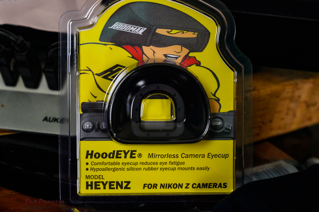

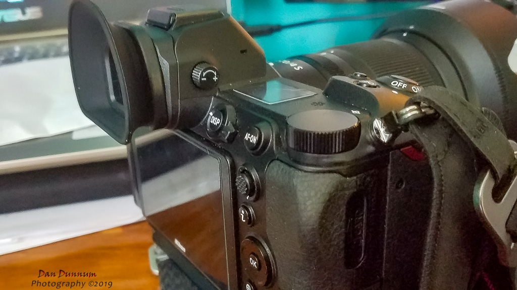

This sensor is very sensitive on many Z6 and 7 bodies. It can be set off by an eyelash. It can be annoying as all get out. There is no setting to correct it. I did purchase a new eye cup to get a better seal on my glasses and on of the unintended consequences was that it has not trapped any gunk in it since I changed it out. The only drawback is that I do need to remove it to put on my Flash Trigger or Speed Light. However I do not see that as a big issue compared to the improved seal and reduction in the trapped gunk.
I think it is better because it opens the area around the sensor up so there is no place for things to get trapped. I was going to upload a photo of my set up but it would not allow me to Upload a photo. Hear is a link with some decent photos.

Welcome to the forum by the way. I do not know what happened on the photos. Looks like they did post. Looks like a glitch in the forum the morning. I do hope this helps.

I bought and tried HoodEye, but found that I don't see the EVF as good as with the original eyecap. So I returned HE and then took a needle file and filed away about a millimeter of eyecap plastic on 3 sides around the sensor. I hope it should help with the problem...
