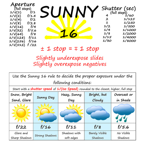

Thanks Jack. I can't begin to tell you how many times I've read about Sunny 16 and still continue to forget about it. Can you spell C-R-S ?
Horoscope Fish
I think I still have one of these in my camera bag on a laminated 3 x 5 note card.

Jack, thanks for sharing that information!! It all makes sense, just need to commit it to memory... I like the idea of a card in my camera bag, I may looking into making one..\
Pat in NH
Roy1961
or do what i do with useful info pat, take a picture of it with your phone, i have a good few of these stored in mine.
Thanks for the info Jack and Horoscope Fish
Pat in NH
Pat...right click on Horoscope Fish's picture and Save It As....now you have your own picture. :) Resize it to any size you want.
Horoscope Fish
GAH! Now why has that never occurred to me?
I cropped it down to just the table on the bottom half. Widescreens nicely on my phone that way.
