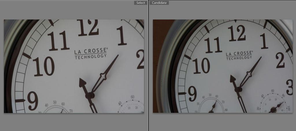

It piqued my interest so I tried it at 600mm without and with a 36mm extension tube. It does get you closer but the second part of your question I suspect would have to be a trial and error. At 600mm without a tube my focus distance was 7m. With the 36mm tube the distance was about 16-18m.
I believe it will give you more reach but depending on the distance and the amount of extension you use will dictate whether it's out of the focal range. Here's a snip first with the 36mm tube and then without.

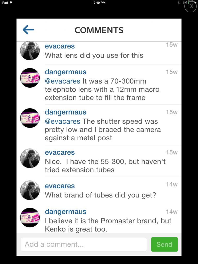

I follow someone on Instagram that takes amazing close up zoo pics, and he said that he uses extension tubes. I didn't want to bother him with more questions so I'm still wondering about it.

I found the pic and convo...totally creepy of me! But he does say extension tubes

Yes, I wasn't sure what it would do either so that's why I decided to give it a test run. Looks like it works to some degree but like WayneF pointed out it's probably better for Macro applications. It messes with the focal length of your lens so certain distances won't be able to focus. And I noticed (at least with my Tamron lens) that it struggled a bit on subjects that I COULD focus on. With so many variables to calculate, how much extension you use, what type of lens and your distance to the subject it seems better to use a TC when trying to bring distant objects closer. Obviously for close subjects the extension tubes are ideal.
Again, extension tubes allow lenses to focus CLOSER than their normal close focus limit. We rack a lens out to focus close, and the extension tube also racks them out. That is what these two pictures do (owl and watch), focus close. The magnification is simply due to being closer to them.
The owl and the watch pictures are relatively close, certainly NOT at infinity. Extension tubes will no longer focus at far distances, like infinity, so would be useless for wildlife at most distances. Instead, that is what teleconverters do.
