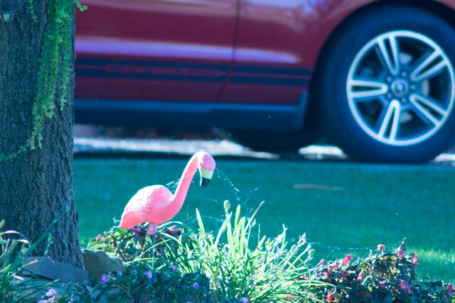

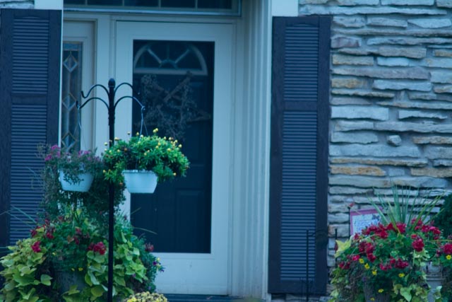

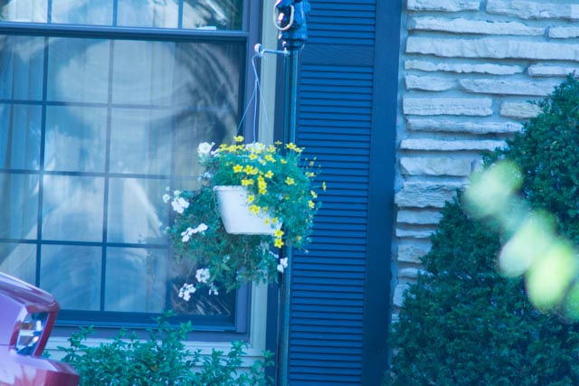

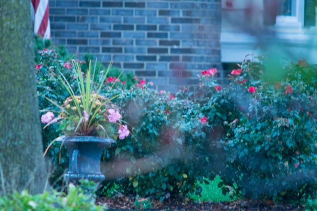

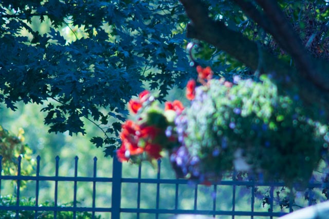

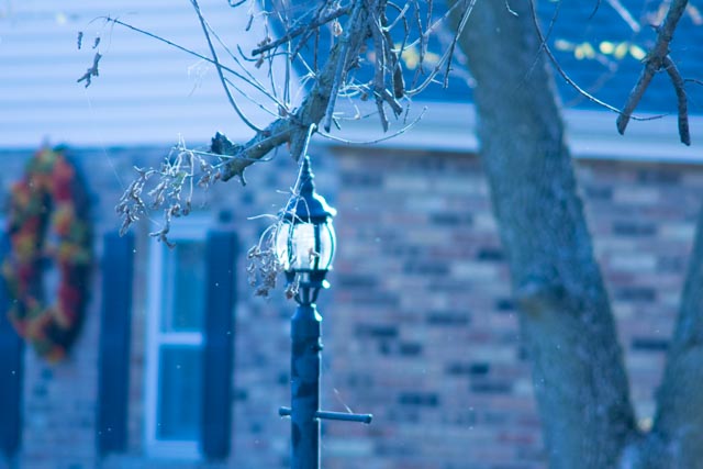

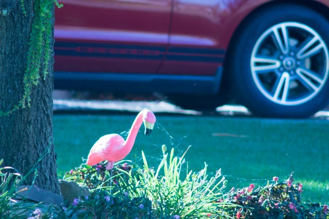

I have a new toy to play with. It appears to front focus just a bit and I have not had a chance to calibrate the focus yet (the camera reads it is an auto focus lens). I shot with a 300mm f/4.5 (@f/4.5) set at infiinity with 1600 iso because it was kind of dark each evening I played with it - no cropping at all. I believe the pictures will be much better when I correct the front focusing and use f/8 or a little lower. I'm going on nights for a month and will be lending this combo to a birder friend to give it a good shakedown. There has been no post processing on these (apart from compressing in LR to post here) and maybe 5 had to be deleted because the camera focused on one thing (I'm using center focus). I'm hopeful this will work out so I can use with 300mm f/2.8 and 400mm f/3.5.

I believe it sees it as a 140 AF f/4 I think. I just put the 300mm on infinity and seems to work ok. I am using single point focus instead of multipoint.

I believe it will read the cpu in the tc as a unique lens. For now, I'll just use my favorite lens (300mm f/4.5) and once I'm fine with that I'll figure out the settings for my other MF lens. I'm getting pretty excited as I've been saving for the 200-500mm and I think I won't need it now.

Don't forget that you can correct for color temp in Lightroom or Photoshop as long as you are shooting in RAW (Which you should be)
I know. Those photos didn't mean anything to me and wanted to post something right off the camera. I've got to get a bird feeder up and take some "real" shots. I've got a birder buddy that I'm going to loan the combo to while I'm working nights for the next 3 weeks.
