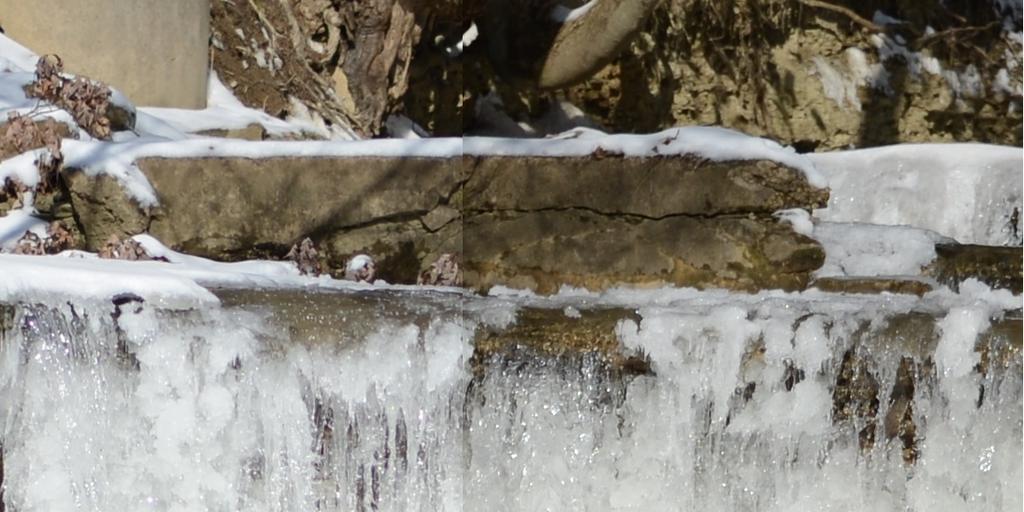

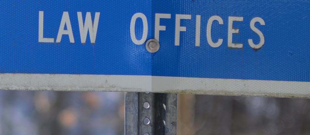

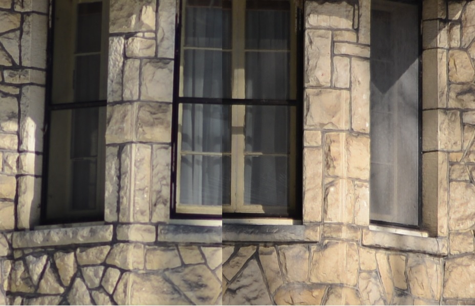

These are nothing special just random shots cropped at 1 to 1 the nikon is on left and tamron on the right. both at 2.8 so essentially the nikon should be sharper.....
This is 85 mm, 2.8, iso 100, shutter 1/2000th at 4 meters away
Same settings but at 1/1600 at 40 meters
Same again but at 1/4000th at 20 meters
It actually looks better than I origianlly thought. All my testing thus far has been indoors in flourescent lighting. I think thats the issues. Its been too cold recently to get outside.
