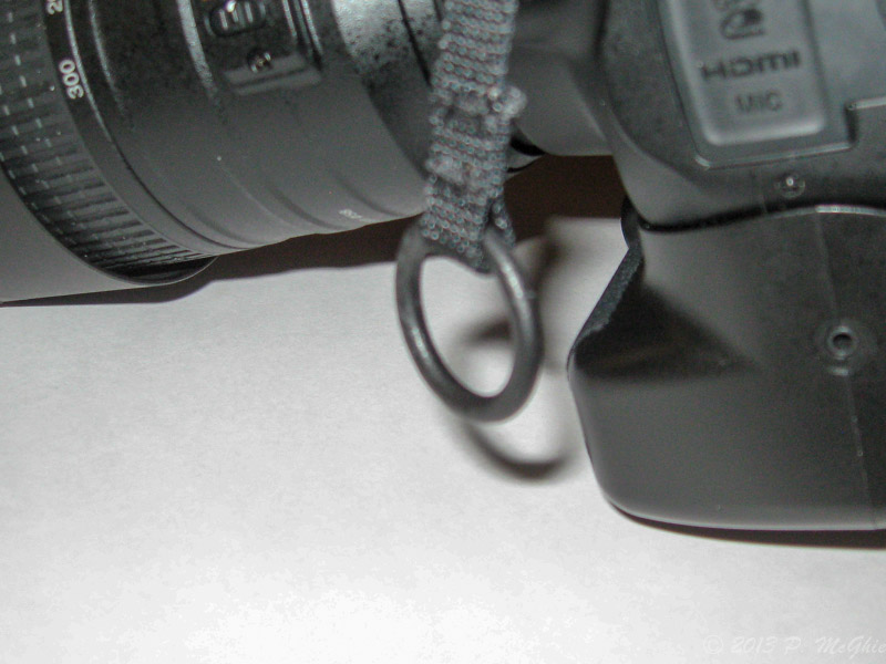

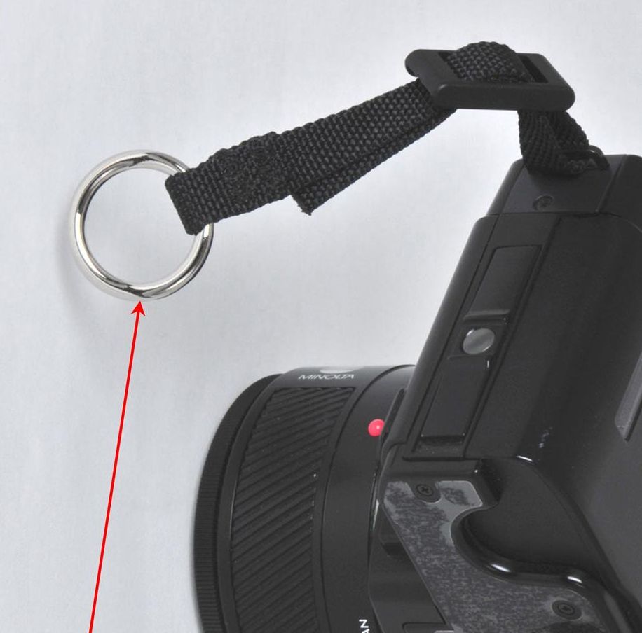

My only concern, the metal ring of the tail ... many said no issue... I was still concerned. When I put it all together, the tail and the strap do hit my Grip (not the camera). Not bad.. but I wanted to fix it... so here is what I did..
Original pieces (stock photos)
Bos Tail with its metal ring

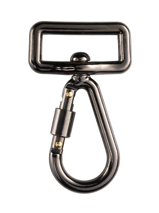

This is the adjoining piece (metal) from the Black Rapid

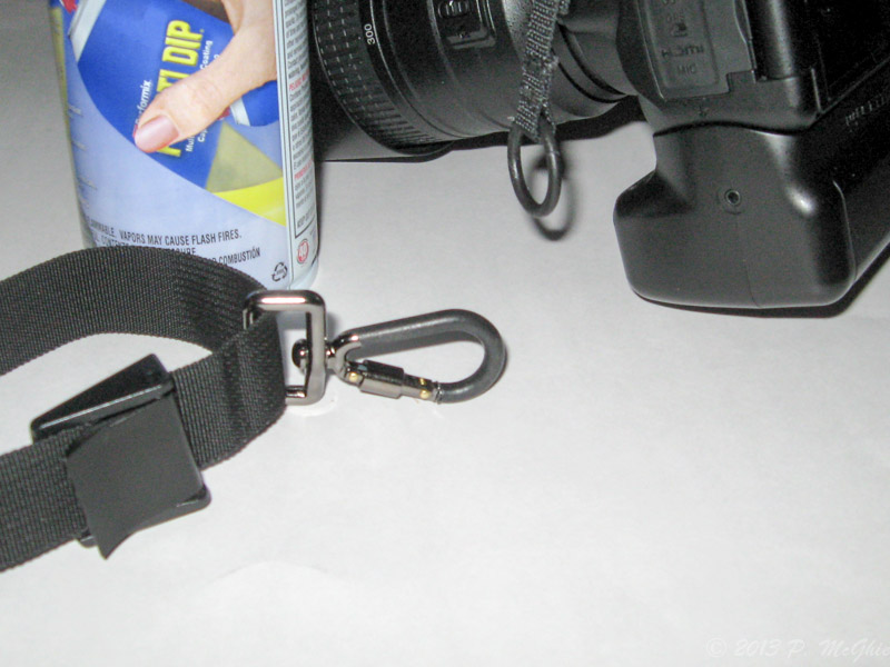

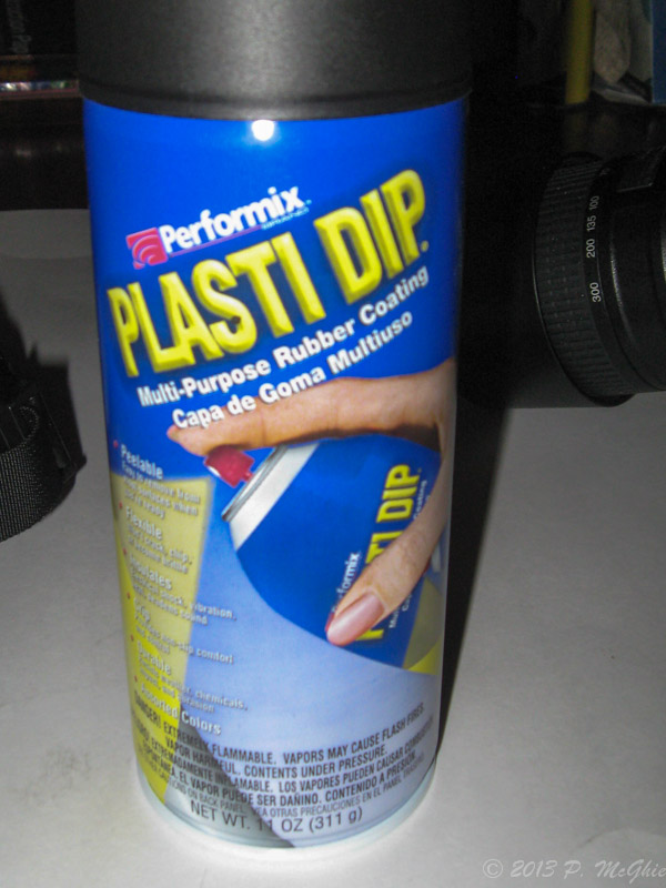

I searched around, played with heat shrink tube to no avail. Finally I found a product at Home Depot (I got it at my local True Value Hardware) Here is what I did.....
Left is all the pieces, right is the Rubber Spray. It was like $8 at True Value

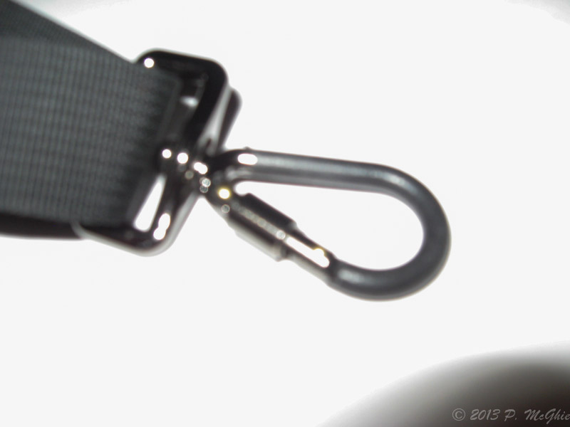

I then masked off the parts and sprayed them. It took several coats, best to keeo it thin coats for best results.
The Caribiner clip and lock on the BR was masked, I sprayed from there, around the loop and back to the main bar.

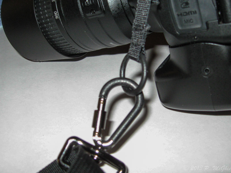

On the Bos Tail, teh ring rotates within the nylon so I masked off the fabric, sprayed exposed metal, then rotated the ring so that the masked section was visible and sprayed it up to the same level.
This is the assembled product. How long will it last?? I do not know but the rubber is "rubber" and on good. If it does wear, I have plenty more in the can!

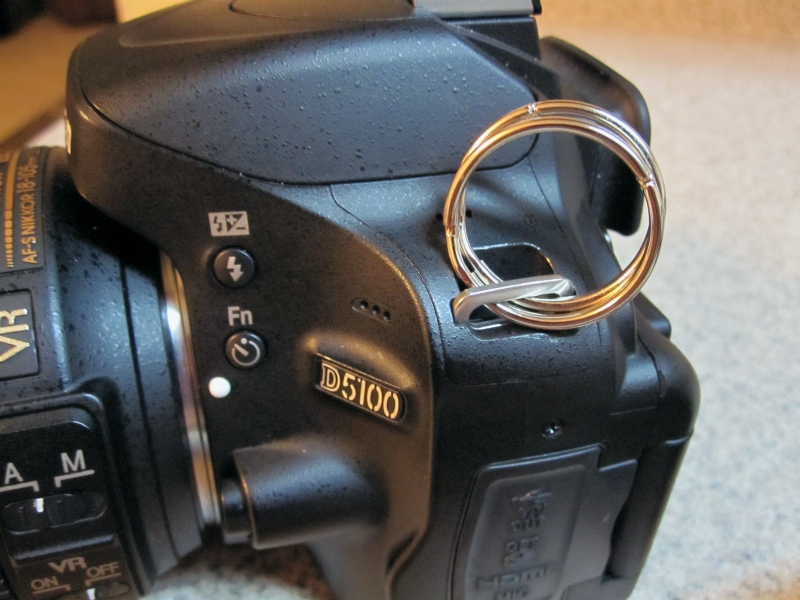

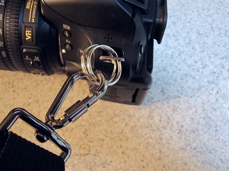

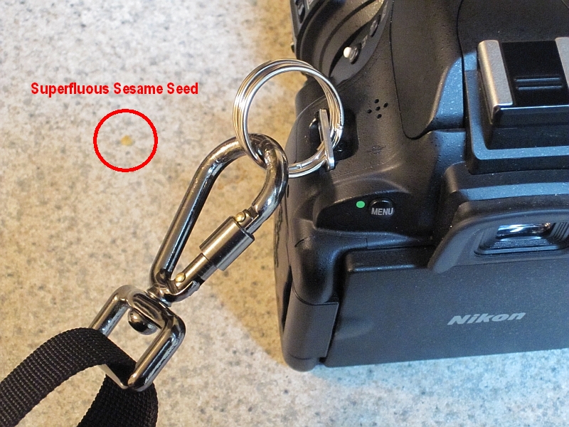

After trying several different options I ditched the BosTail and instead put two 1" split-rings on the cameras left-side strap-lug, where the BosTail would go (I used two rings because they come in 2-packs at Home Depot for $1 and one ring just didn't seem like enough). For carrying I clip the Black Rapid RS-7 carabiner through the split rings and I'm off to the races with all the convenience of the Black Rapid sling, an open tripod socket and no "tail" dangling from the strap lug. I love the BR strap, but I didn't like how my camera hung from my hip when suspended from the tripod mount. Using the Black Rapid sling with the split rings makes everything just right.

Take a picture of the setup on the camera when you get a chance please... Pat in NH
Sure... Give me two shakes. I'll have to take the shot with... with... well... a Canon.
Okay, these should get the point across. I didn't bother correcting the horrible white balance.

I should have mentioned this in my initial post... While it probably does look like the split rings could scratch the camera body, in reality they don't. In a fortunate twist of fate the shape of the strap-lug keeps the rings off the camera body entirely; they can't reach the plastic at all.
