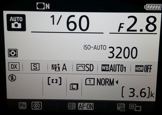

I received my kit a few days ago, and after fumbling around with it, I recognized I can't get it to autofocus. Not only does it no AF but the AF sleect button on the side is also not working.
  • Flip above the backside dial is not on Locked position
  • Focus switch is on AF (both on body and lens)
  • When half-pressing the shutter / pressing AF-On (bound to AE-L) a single focus point is visible, red led lights up in the viewfinder but that's all, shots remain unfocused.
  • I've tried to take on-off the lens several times. Both with a fixed 35mm Nikkor, and a 55-300mm Nikkor. The latter has VR that is clicking while half-pressing the shutter - so the body does communicate with the lens I suppose.
  • Below are my settings. Battery is charged well and obviously the camera is on. I've tried to reset any user settings (there's no actual factory reset on the D7200)
As I said, AF mode button does nothing, in any mode. Focus-related settings as shown in the manual are not present, it's as if AF would be disabled somehow - as if the camera wouldn't think it can control lens focus, thus has this disabled. Is there something I could try before returning it?

Hi looking at your settings it Shows AF ON, I'm sure that means you initiate focus using the AE-L, AF-L button
ie back button focusing , the shutter button is disabled for focusing hope that helps

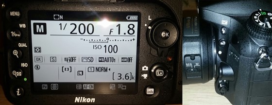

Sadly not, nothing triggers AF. This is a clearer picture below - it seems it's stuck on fixed-point, locked focus. But the switch above the dial is not on Locked... I also tried to mount-remount the lenses, to no avail.

Yes, I only wanted to illustrate that focusing does not work either way (I've resetted back-button focus since then). The camera is Locked in single-point AF, without any way to change back. I wonder if that's the default behavior if a non-AF lens is on (so that the camera doesn't detect the AF-capable lens). If it would be a motor failure I guess I'd be able to still change modes.

I just tried my d7100. If I switch to manual focus either on the body or lens, it behaves like I think you are describing. Single focus point shown and I cannot access the focus modes or focus servo modes.
Can you manually focus and see the focus indicator in the viewfinder react? If so, maybe your camera is stuck in manual. Give that little auto-manual lever on the body a little back and forth workout, does it solidly click to AF? Mine is a solid click to AF and a little softer feel going to M.
poisonborz
You're right, probably. I can see the the focus indicator in the viewfinder (arrows, full circle when focused). The lever is clicking solidly in places, but to no effect. A quick search turned out that focus being stuck in manual mode is a widespread symptom in dslr-s, mostly due to contact-hardware fault :(
