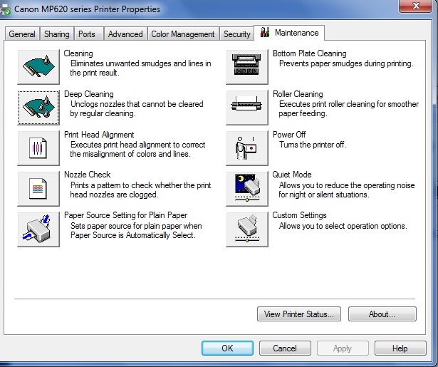

Did you resolve the problems with the marks on the paper? I was just looking into the options with my own printer as suddenly what I see on my monitor isn't what is printing from my printer. It's either a calibration problem or a printer problem. In any case, I came across these options for my printer's maintenance. I went to my printer's properties then to a tab for printer maintenance. Perhaps yours has something similar?

Thanks Hark but I have been doing cleaning and nozzle check and nothing changed - and also its only on the matte paper it happens. I've ordered a sample pack of Sihl Masterclass, really hoping thats the paper I wanna go with. Hahnemuhle is a bit expensive, I think.
