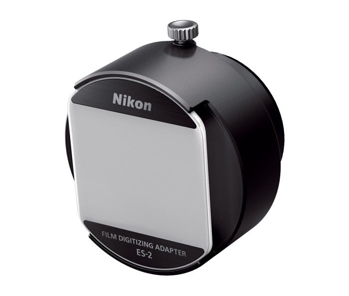

Really the ES-2 is a plastic holder that attaches to the filter ring of a lens. It would have an extension on end to reach past the minimum focal distance, and the frosted white backing for light to shine through. There are several Chinese items that do that also, many with an add-on LED backlight. It's kind of a one-project item, so I say no loss trying to save a little money.

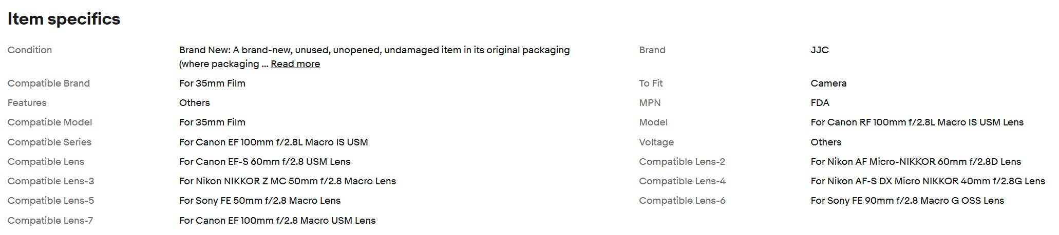

I just purchased this one:
According to the specs, by using the adaptor n.3 I should be able to use the MC 50 lens...

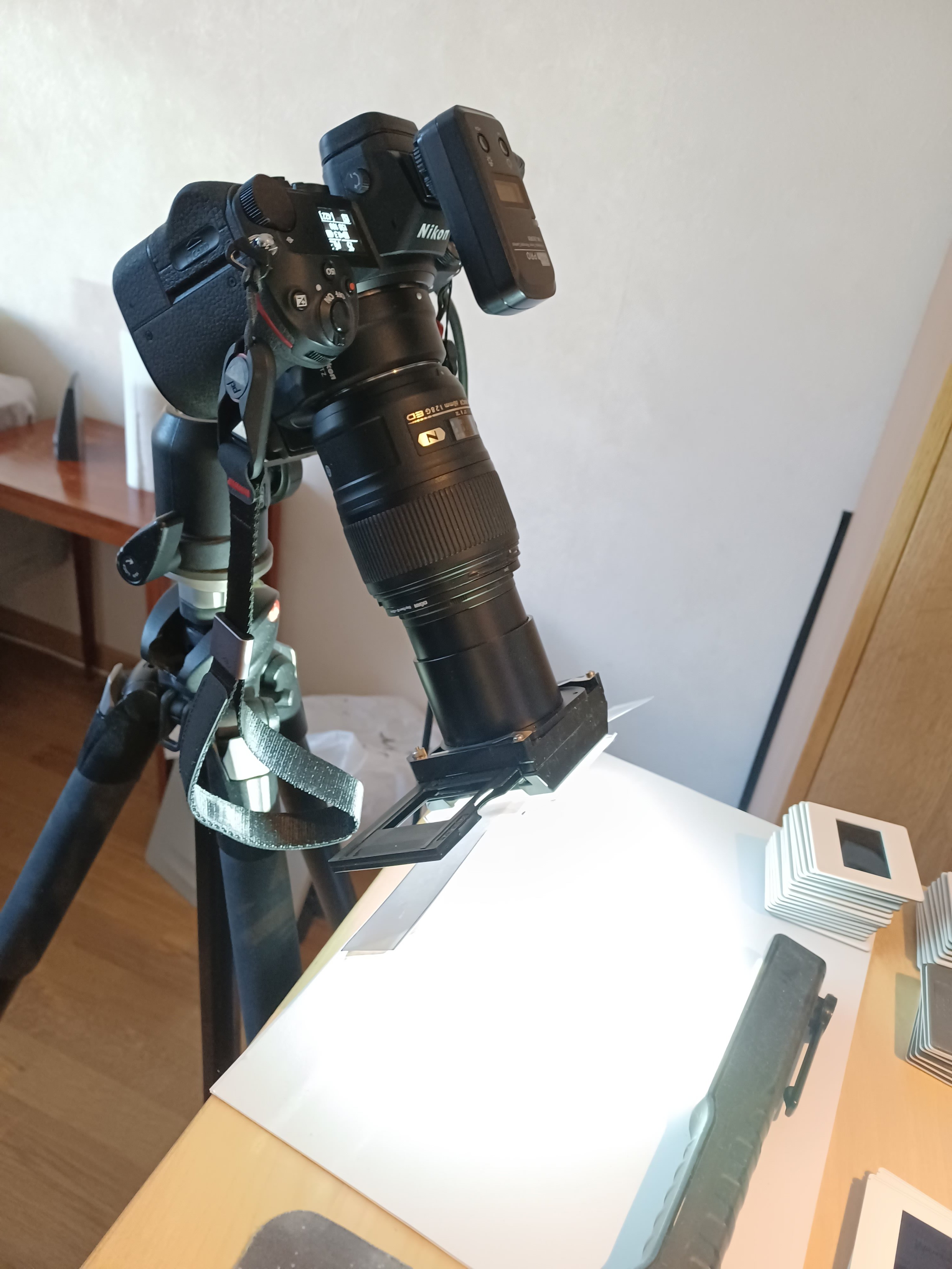

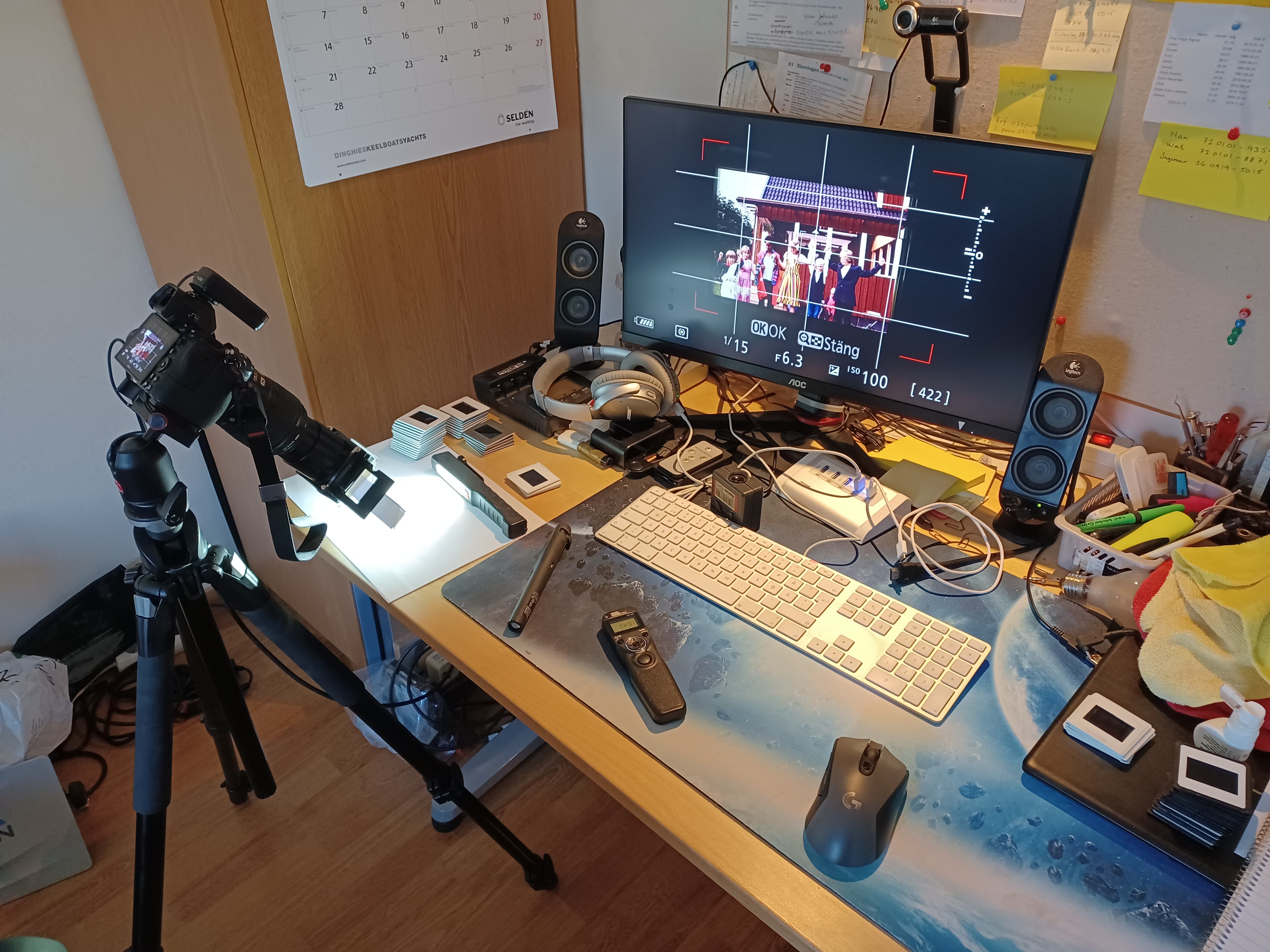

I have tried many different ways to photograph slides. The one that I finally got to work well is the one in the picture.
The camera (Z6) is on a tripod pointed down at a white paper that is illuminated. The lens I used is a 60 mm macro (F-mount) where I have mounted a slide holder on the front. Between the lens and the holder is an adjustable tube. I also had a step-down from 62mm to 52mm.
I have a remote release on the camera so I don't have to touch the camera while photographing. The camera was then connected with HDMI to my computer monitor so I got the image on my 24 inch screen
But this wasn't the hard part, it was keeping track of all the slides and sorting them correctly. One pile for those that were to be photographed and one pile for what had been photographed!
I then took the images into LR, adjusted the color and cropped them. Adjusted the angle a little. Then exported to jpg.

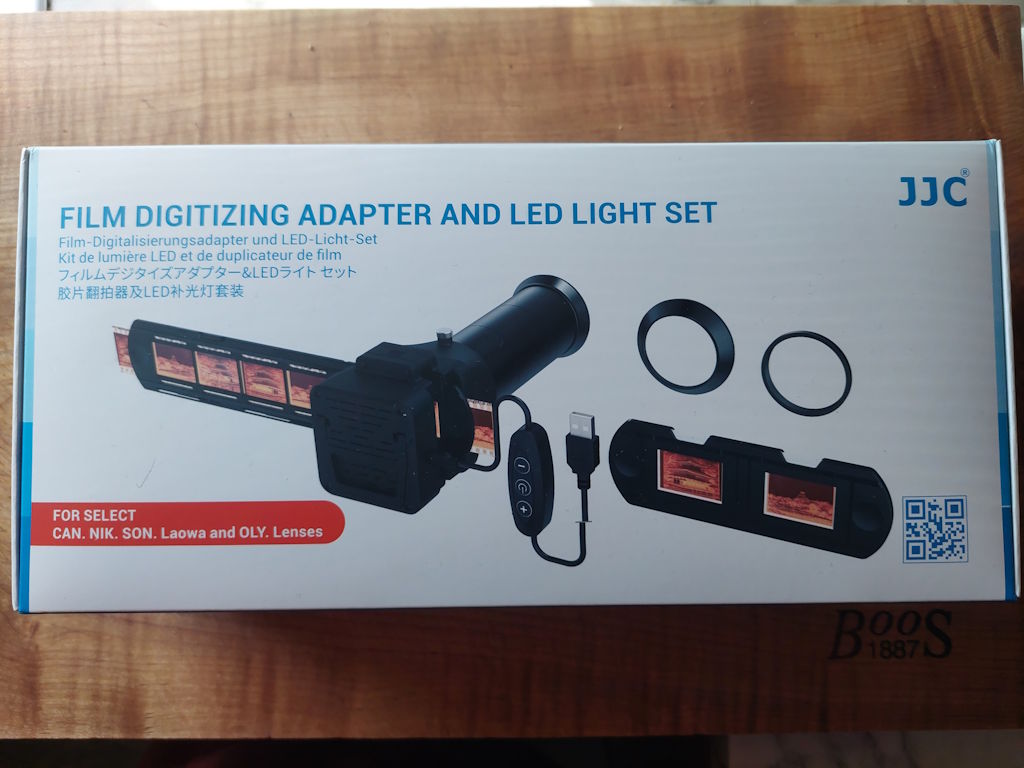

As promised here it is my review of the 35mm Film Digitizing Adapter+LED Light Set Negative Scanner Holder as Nikon ES-2 purchased on Ebay..
The first thing that I notice was that it took only 6 days free delivery from China... Now considering the world situation, that's impressive...

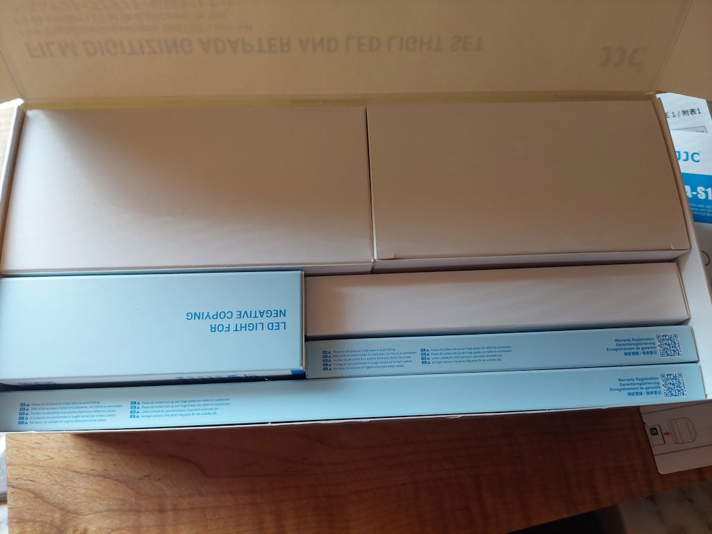

The box was well packaged and also to my surprise heavy, but there is a reason for it...
Not an mm to spare in this box. Everything was wrapped in good plastic protective film/bags, and it could have easily been a brand items, or perhaps JJC is a good brand in China and I was simply not aware of it... But I'm now!

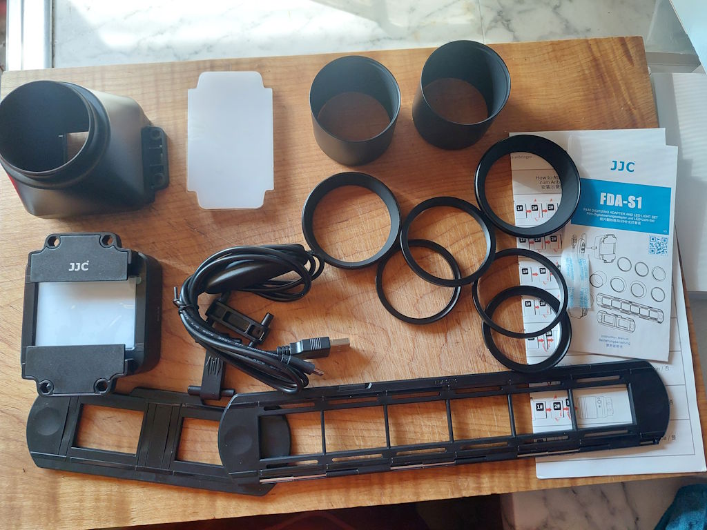

This what you get and to my surprise beside the two slider holder and the backlight, everything else if made of aluminium. That does explain the weight of the box..
I will now set it up for the Nikon with the Z MC 50 Lens and see what happen...
