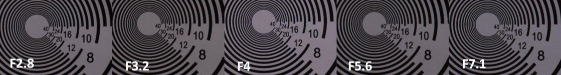

300mm comparison:

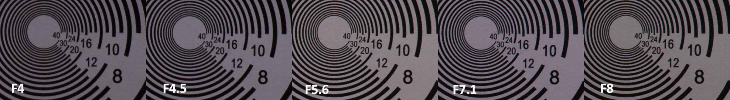

420mm comparison:

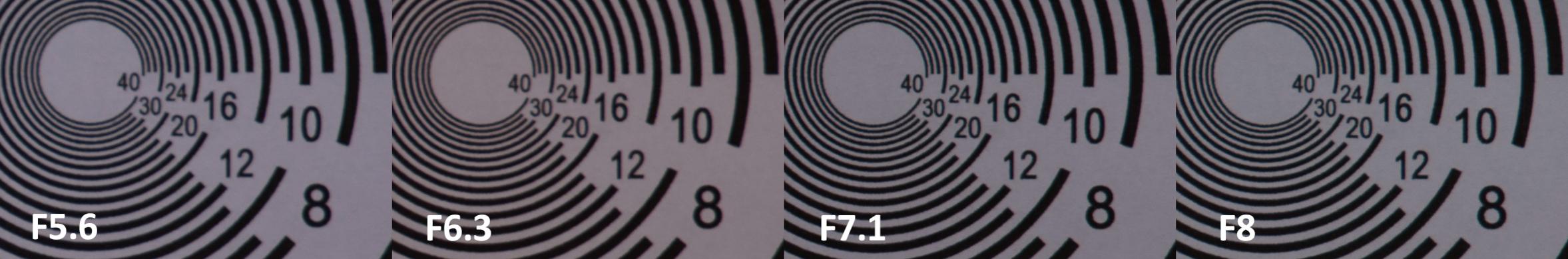

600mm comparison:

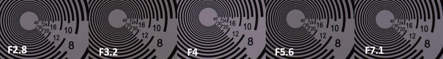

300mm comparison:

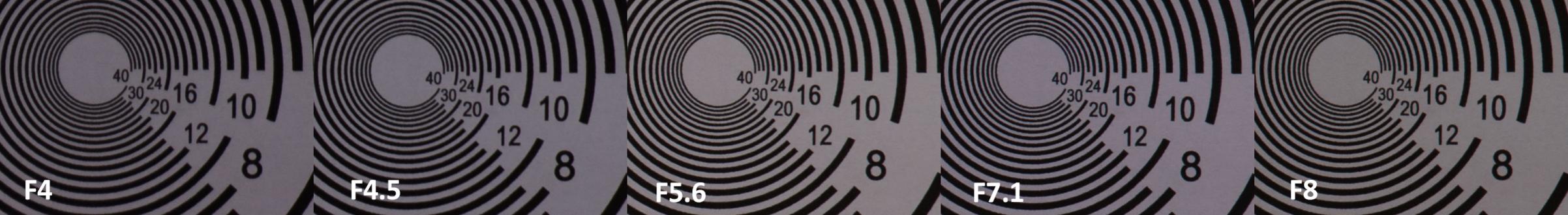

420mm comparison:

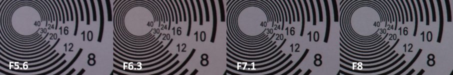

600mm comparison:
