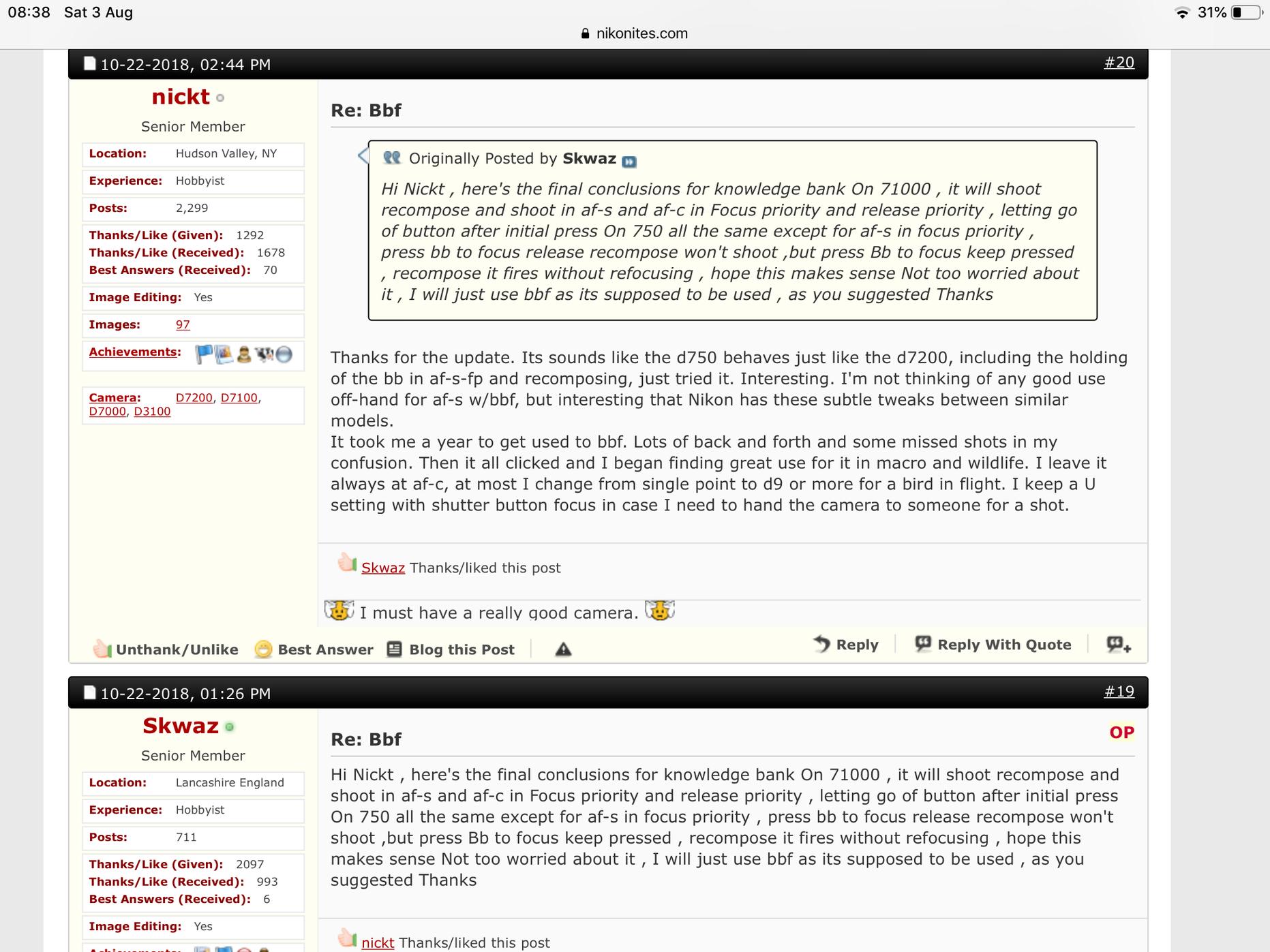

<blockquote data-quote="chatkat" data-source="post: 707778" data-attributes="member: 46885"><p>I inherited a D750 and also have the same problem. Sometimes if I turn the cam on and off it will work. I made sure my D750 settings were the same as my trusty D7200 to rule out having a setting that might affect my ability to shoot. I too use back button focus and have autofocus set to "release". I've made sure my battery is charged as I've experienced other functions that don't work if the battery is low. I just used an eraser on the lens contact So, it'll be interesting to see if these are real fixes.</p></blockquote><p></p>
[QUOTE="chatkat, post: 707778, member: 46885"] I inherited a D750 and also have the same problem. Sometimes if I turn the cam on and off it will work. I made sure my D750 settings were the same as my trusty D7200 to rule out having a setting that might affect my ability to shoot. I too use back button focus and have autofocus set to "release". I've made sure my battery is charged as I've experienced other functions that don't work if the battery is low. I just used an eraser on the lens contact So, it'll be interesting to see if these are real fixes. [/QUOTE]
